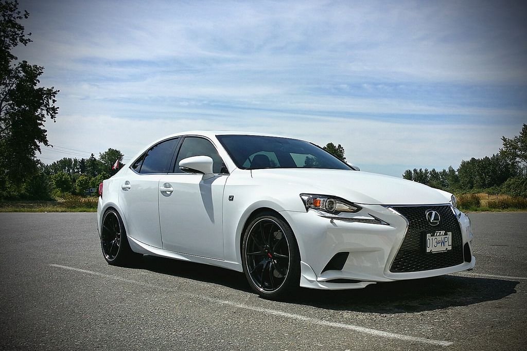

I installed mine. Really plain and simple.
Old Jul 26, 2015 | 06:55 AM
Spamboi's Avatar
Spamboi
Joined: Apr 2014
Posts: 82
From: MS
3 bolts total, 1-fender well 2-under bumper
Also lined with 3M tape.

Looks very nice and very clean! Love it. wonder if that would work on a non-f-sport 350. =)
Old Jul 28, 2015 | 09:14 PM
travanx's Avatar
travanx
Joined: Jul 2015
Posts: 32
That looks really nice. Would it protect the stock bumper from scrapes and not get pulled off?

It looks likes TRD knockoffs and instructions ppeople are installing except for the last set of pictures. The real trd has different mounting points and has weather stripping moulding built in.

Depending on the angle of what you scrape on, it would protect it a little bit, but as you can see majority of the bumper is exposed. As for the getting pulled off part.. It's just 3 bolts and 3M tape on mine. I wouldn't be surprised if it did get pulled off honestly.

i just ordered 1 exactly like you but dont know how to install. So do i have to drill 3 hole into my bumper ???? Can i only use 3M tape ? Thanks
Old May 6, 2016 | 01:34 PM
Answer's Avatar
Answer
Joined: Mar 2015
Posts: 1,128
Likes: 917
From: Quebec, Canada
you will have 3 self tapping screws per side. Only using 3m tape, I would not...
