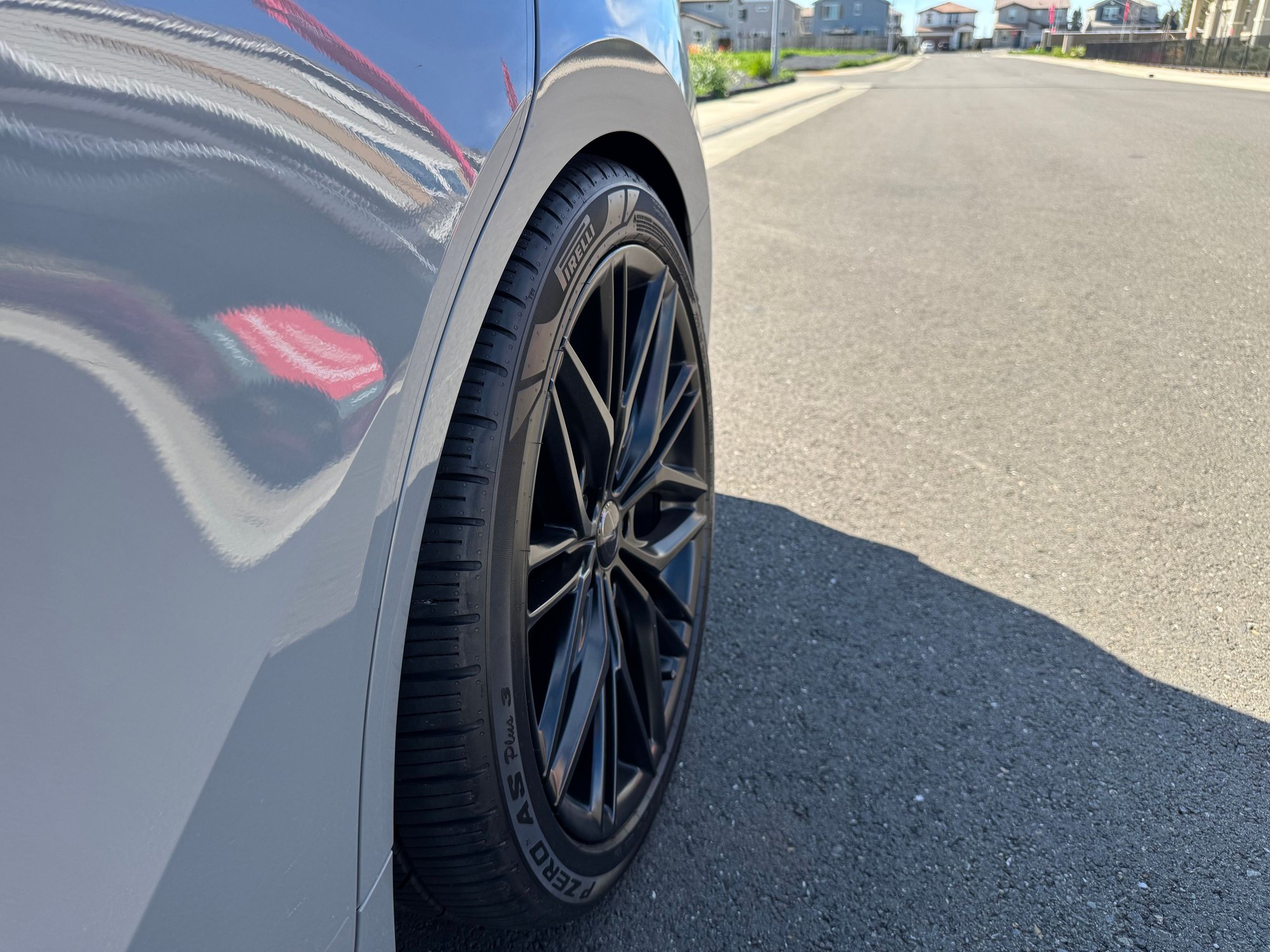

Decided to add the photo. If you look at the side wall, it tilts inward slightly. I'm pretty sure a 245/40 would work without issue. A 255/35 I could only guess it would work. Kinda curious if anyone here has done a 255/35 in the front. If there were any rubbing issues or anything like that. I'm not replacing the rear tires, they have plenty of tread. I'm still figuring out if I want to replace the LCA bushings now or do it at a later time. Logic would dictate I should change them first, then replace the tires. Trying to be mindful of the budget.

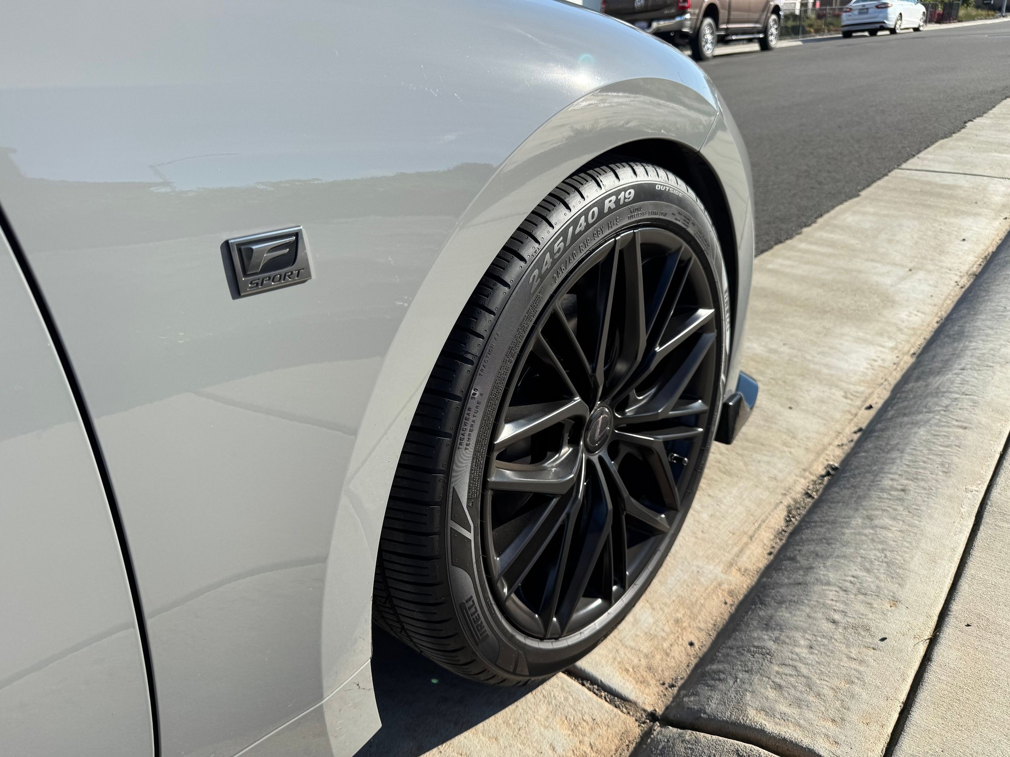

I agree with KJ. You should upgrade your LCA bushings before or at the same time to prevent additional tire wear. After I changed my LCA bushings, I went up in size on my tires. This made my speedometer off by .9 miles per hour. So, at 70, I'm doing 70.9 MPH.
1. My tires are now Pirelli PZero AS Plus 3's. 245/40r19 fronts and 275/35r19 in the back.
2. Lowered on Eibach pro kit springs
3. 15mm spacers in front and 20mm spacers in back.
4. No rubbing.
