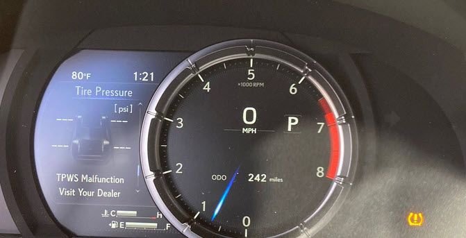

This light came on about 10 miles after we left dealership, I checked tire pressures and they are at recommended psi. Have not been able to reset the TPMS.
Not so easy to go back to dealer, as they are not close.
I tried to reset through the menu toggle, but was unable to select the TPMS option.
Any advice on how I can fix this, or do I need to go by a nearby Lexus dealer?

Go to the nearest dealer, it needs to be synced again most likely

I did find the fix - the TPMS ID codes were never registered, followed the steps laid out at: https://www.wheelsjoint.com/lexus-is...-how-to-reset/ and all is good now.
