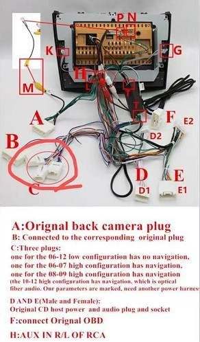

Which radio did you get? The one I got actually is compatible with nav and non-nav. Here are the instructions for mine. (refer to C). Not sure if same for yours.
You might have to bite the bullet and buy the proper wire harness from that seller assuming it will work with your aftermarket radio. Just make sure you take photos of your existing car harnesses and the back of your original stereo and send those to them.
