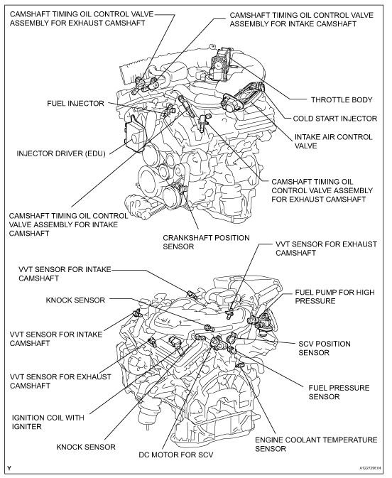

2 codes
P0345 and P0348 and a P0348 Pending
What do they mean?
I did have the alternator replaced yesterday so maybe something was unplugged? I got all these lights during driving though.... and I did drive it for awhile before the lights came on.

Since you could have possibly damaged one. I would check the wiring for the cam sensors Bank 2. A possibility one wire is slightly pulled, or damaged while changing the alternator.

So the codes left this time... so I thinl its related to wiring problems at this point. Will update with what happens next.

Do a search for Banjo Bolt Leaking. Most can be fixed by cleaning the area, loosen the bolt, snug it tight and torque to spec. Others replace the crush washers and torque to spec.

Huh well an oil leak could be the problem that causes these codes to come up?
I did notice some oil residue all around the drivers side amd its around the valve gasket I believe..... I can take some pictures later today.
