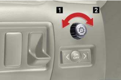

Speddon, yes, rear Sun Shade switch will illuminate when headlight switch is set to Auto or Headlight ON setting on Left lever.. Also confirm that the Instrument Panel Light Control is set to a Bright setting, by turning it to the right.

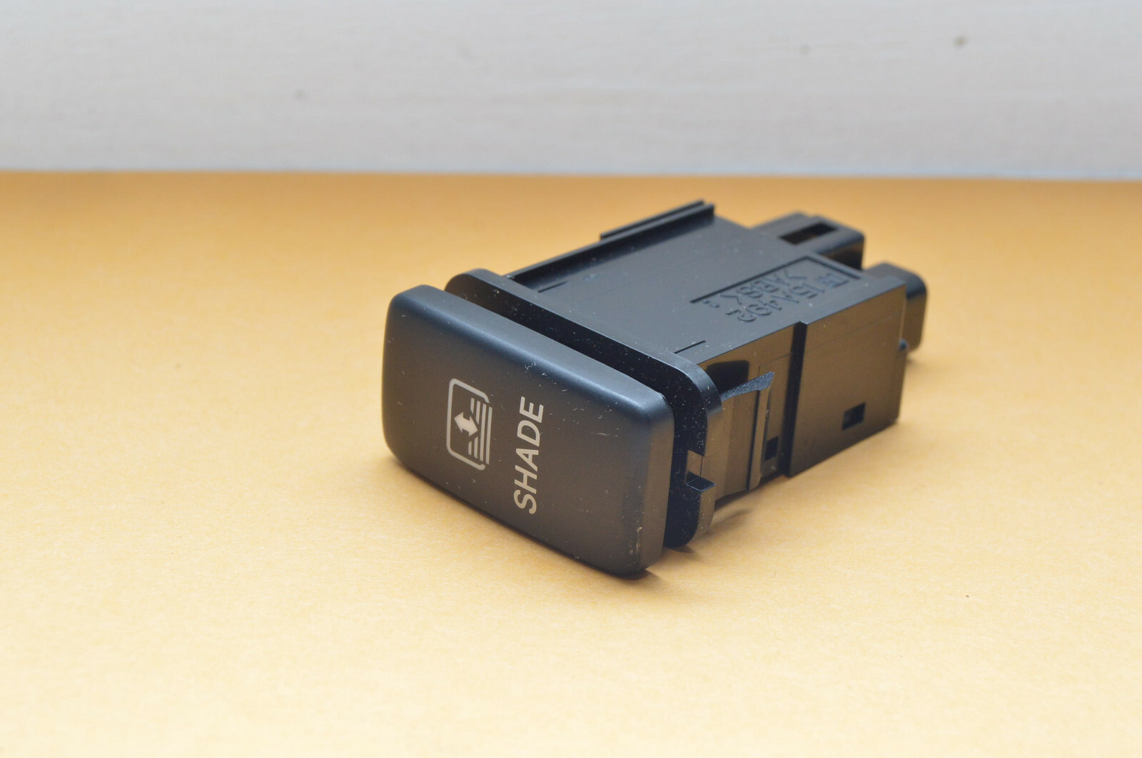

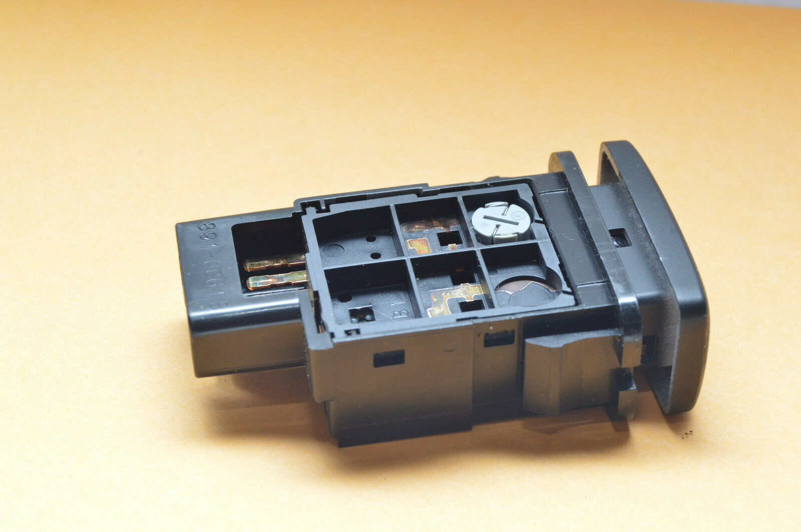

Unsure of bulb type. Thought light might have been integrated in the switch itself however, did locate part # 9001001039 (bulb), which may be what illuminates the switch.

Awesome. Thanks. That is helpful. I'll have to see if the bulb is serviceable or not, but if it's not I guess I'll just have to replace the switch itself. Although it's just the bulb at this point, the switch itself works just fine.
