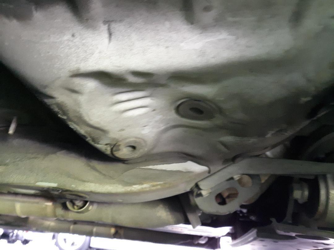

Oh and the F-ing idiots lifted the front of the car on non factory lift points and damaged/caved in a section under the car see attached pic. I am so mad at them. I dont know if this can be fixed. Yes you cant see it but bothers me!

Old Apr 22, 2019 | 03:37 PM
Posts: 25,992
Likes: 4,311
Looks to me like two sections of metal have separated that should be straighten out and sealed.
Now this takes the cake. The people you trusted to work on your cars are incompetent. You must file a claim. Hope there is a lesson learned here. What are they?

Got a quote to fix the damaged floor pan $150 my buddy owns a bodyshop.
