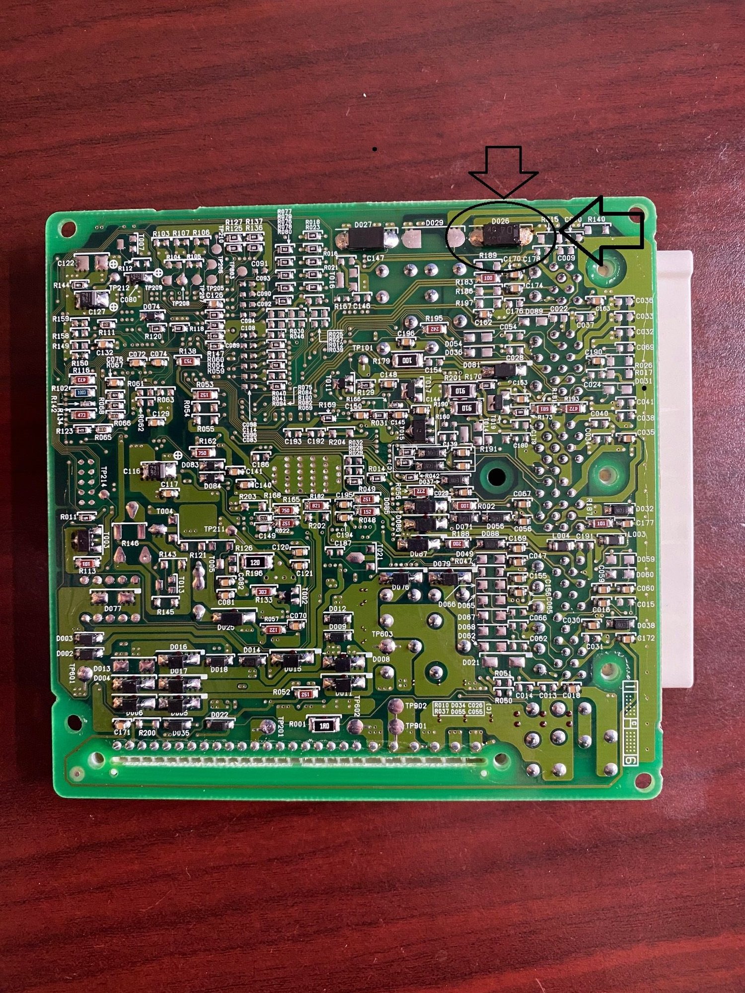

I think i narrowed down the issue with the circuit board. See circled part in the pictures.
I got to that conclusion by tracing the circuit board and continuity testing.
Even if someone is able to obtain a replacement piece, I do not recommend altering the circuit board because if you make a mistake is soldering the replacement piece, you risk causing possible major damage to the electrical system of your vehicle. I suggest everyone do their research based on the issues they are experiencing and make educated decisions.

Jul 1, 2020 | 11:44 PM
Hi Abef
You did a very good job , do you think that diode (D026) is responsible for unlocking doors , for me I can replace it since Im electrical engineer and expert in electronic maintenance.
the diode code is not clear in the picture so I can bring replacement before dismantling my car
thanks so much
Firas
