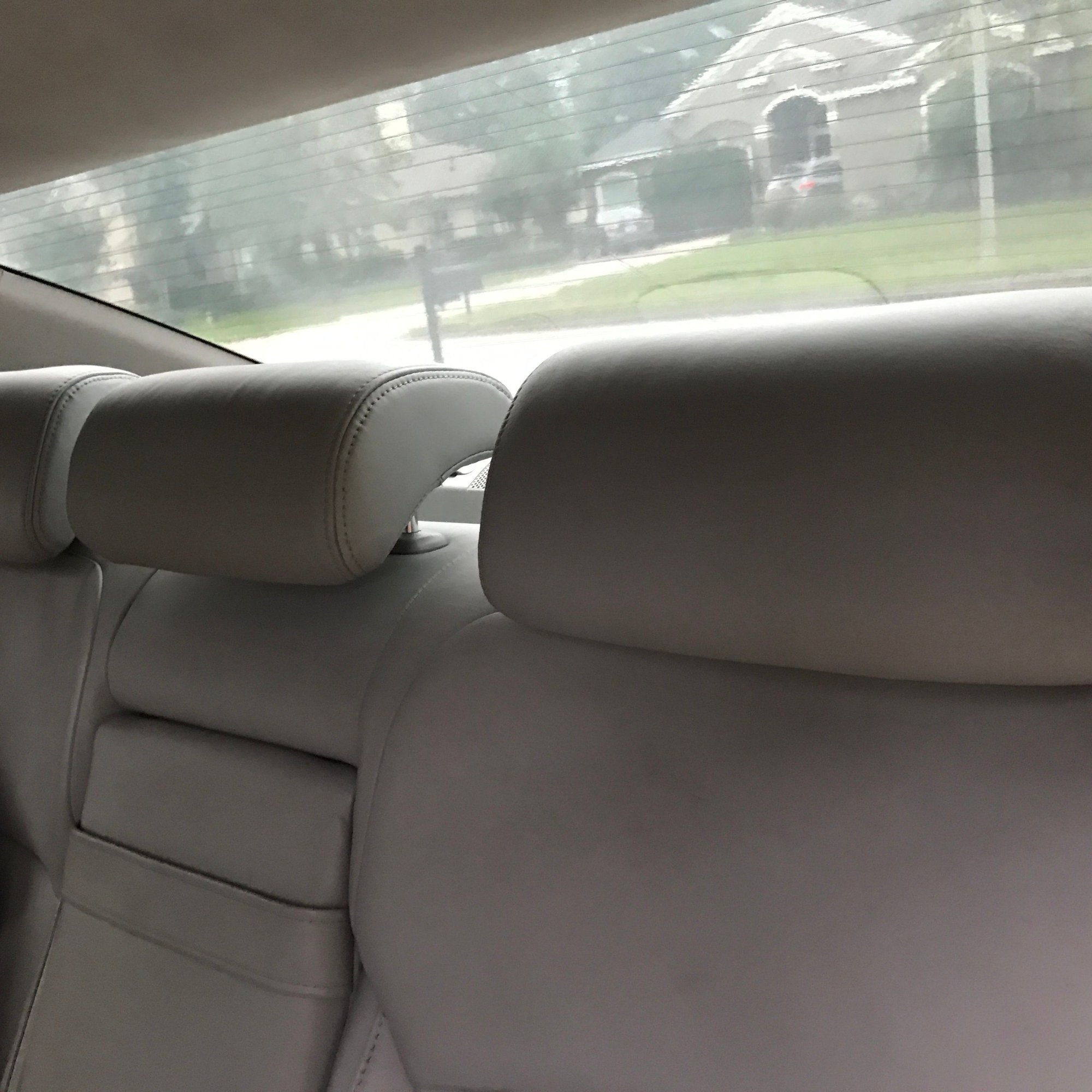

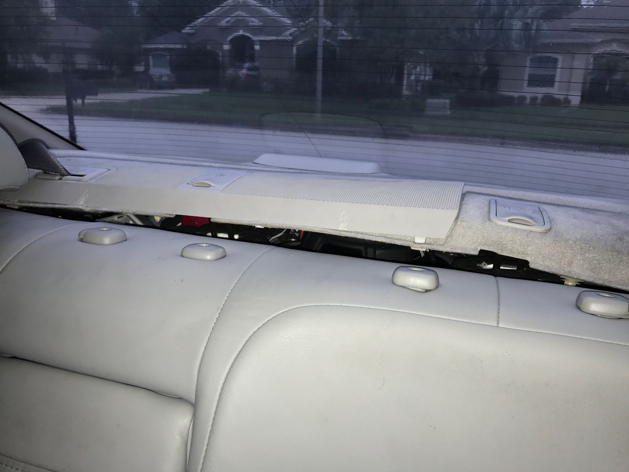

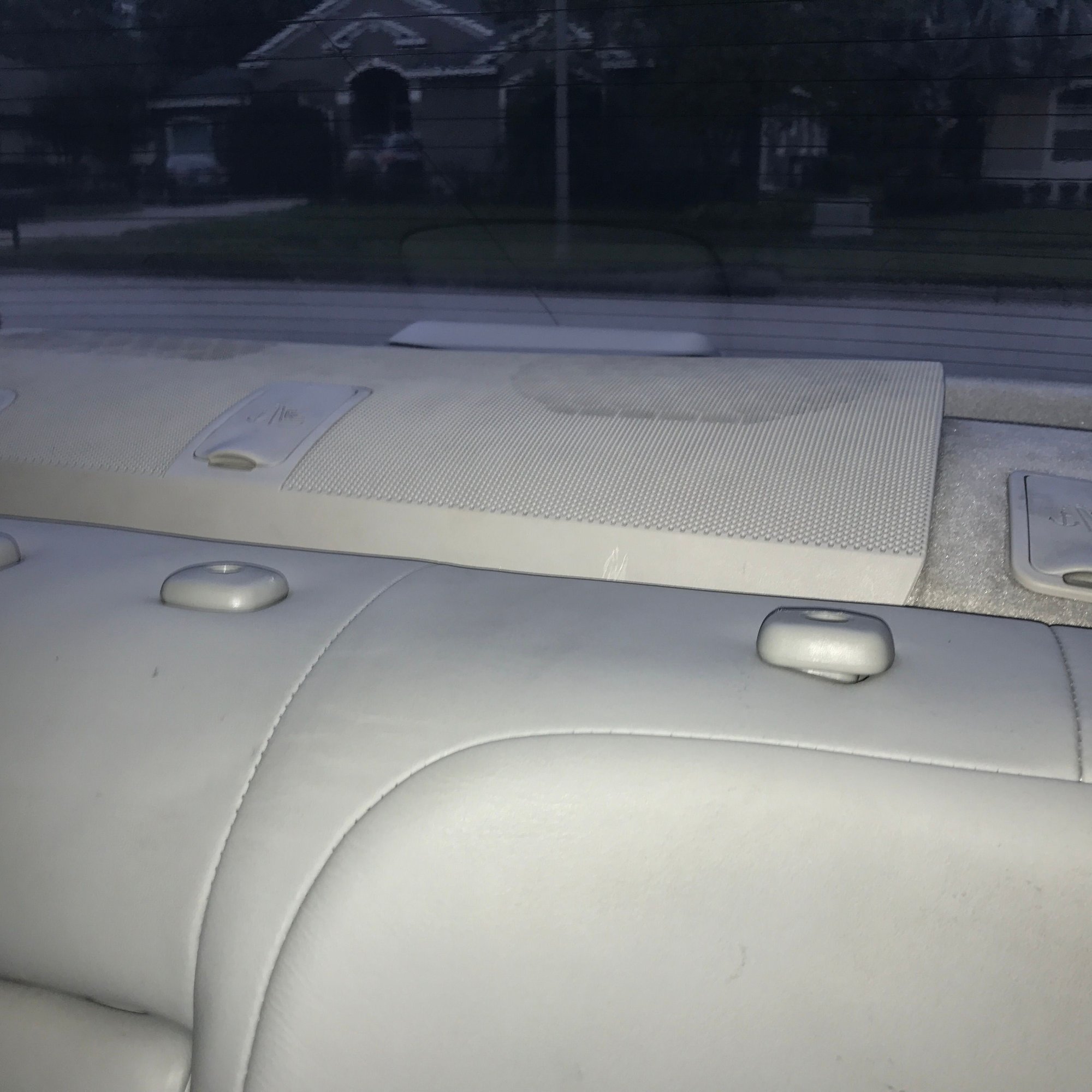

Ordered polk audio 8" (8 ohm capable)
Pulled up hard on top rear panel (screwdriver/pry) and pops right up, didnt have to remove back anything, just headrests... 4 10mm screws holding in woofer and wallah.
it DOES sit an inch too high rear mounted, face down for now, but hey its a start, and w headrests Back in, you dont see the slight cover ~
Going to get double sided weather stripping to put between bottom facing speaker and trunk metal, and figure way to fasten speaker down.
Things will change, just a start to replace fully blown stock.
