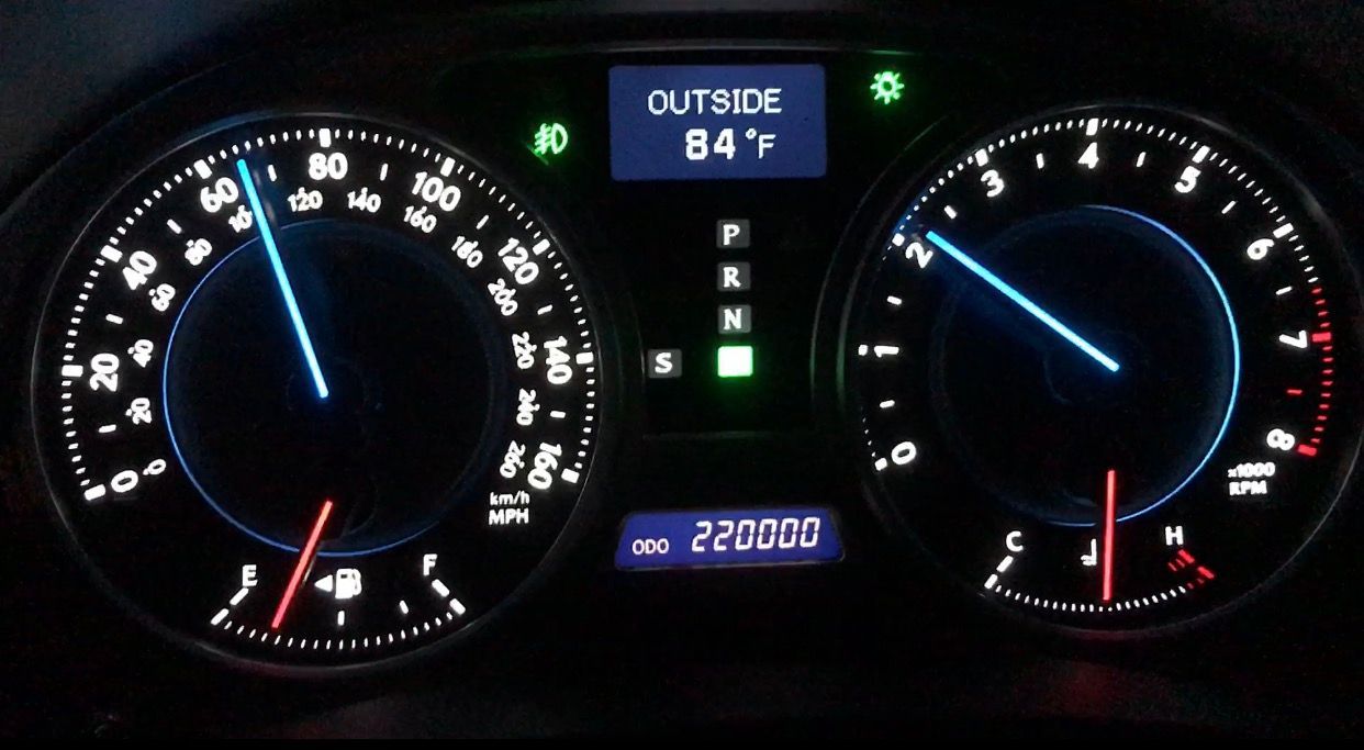

So after 220,000 miles I FINALLY replaced the PCV valve. It still rattled as much as the new one!

^Just means you've got a very healthy motor. You bore scope vids confirm that.

Yoda tech here. I have yet to find a bad PCV on a 2GR or 2AR anything. 2AZ, 1MZ, 3MZ, etc, yes. Please post if you've found a bad one. I'd bet oil changes were skipped... lots of them.
