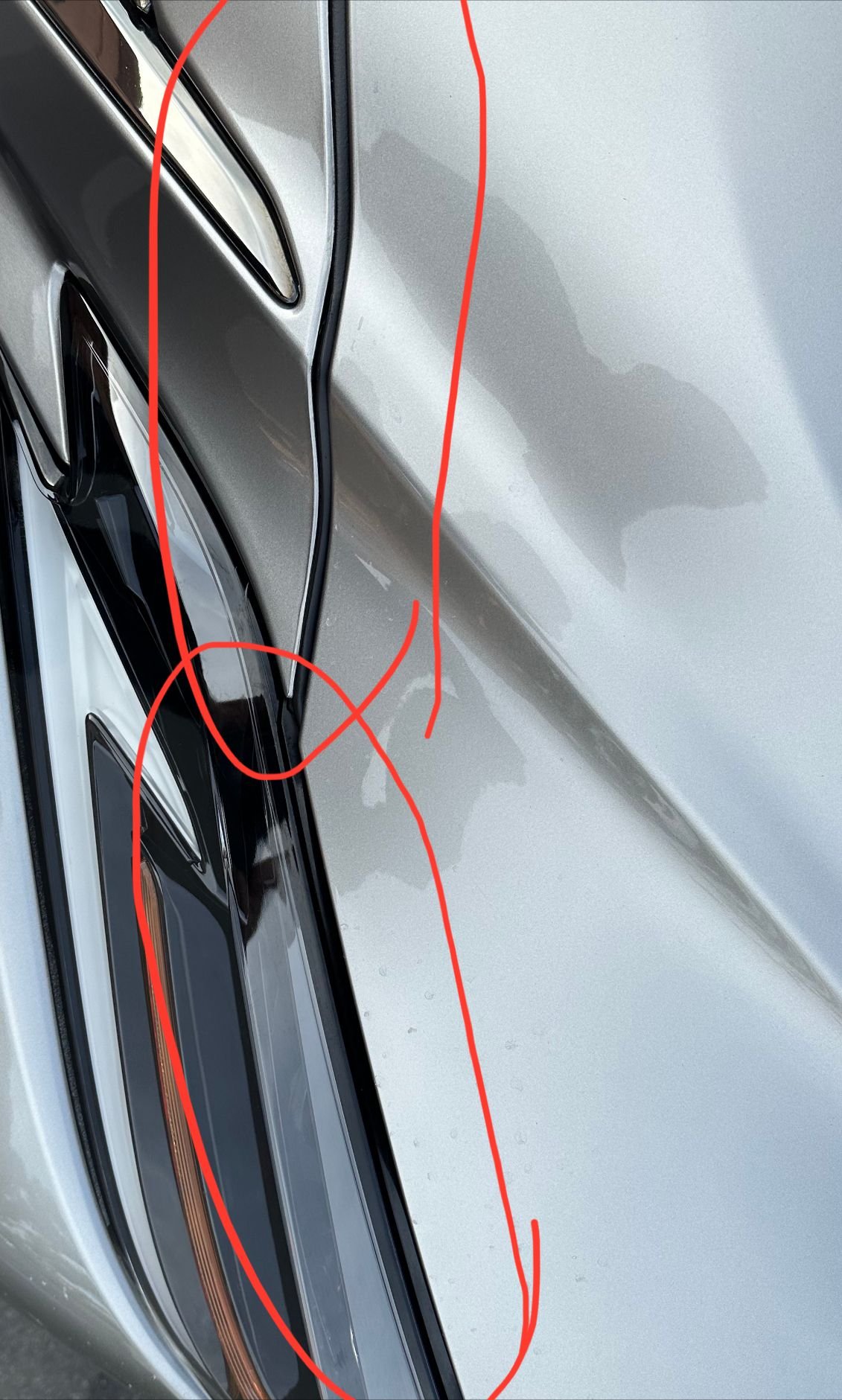

I have an 19 es 350 f sport with same thing the hood looks like it’s short dosnt really cover to the end of the front bumper and you get to see the seals exposed looks (UGLY) also the headlight not covered from then top you get to see the crack (UGLY) water can sits there and eventually headlight will get cracked !!!!! I have seen this pretty much in all 2019 and up , im not sure 🤔 r the Japanese model has the same finishing and alignment, but I feel that’s not what it supposed to be I been watching all automakers they’re have a prefect alignment regardless they don’t have this issue ,, where’s Lexus quality control not just that but most the plastic parts all around the car very flimsy and cheap made the engine air filter housing very flimsy you can actually break it if you rest on it come on Lexus !!! My 08 gs was built in Japan was rock solid till now !!!

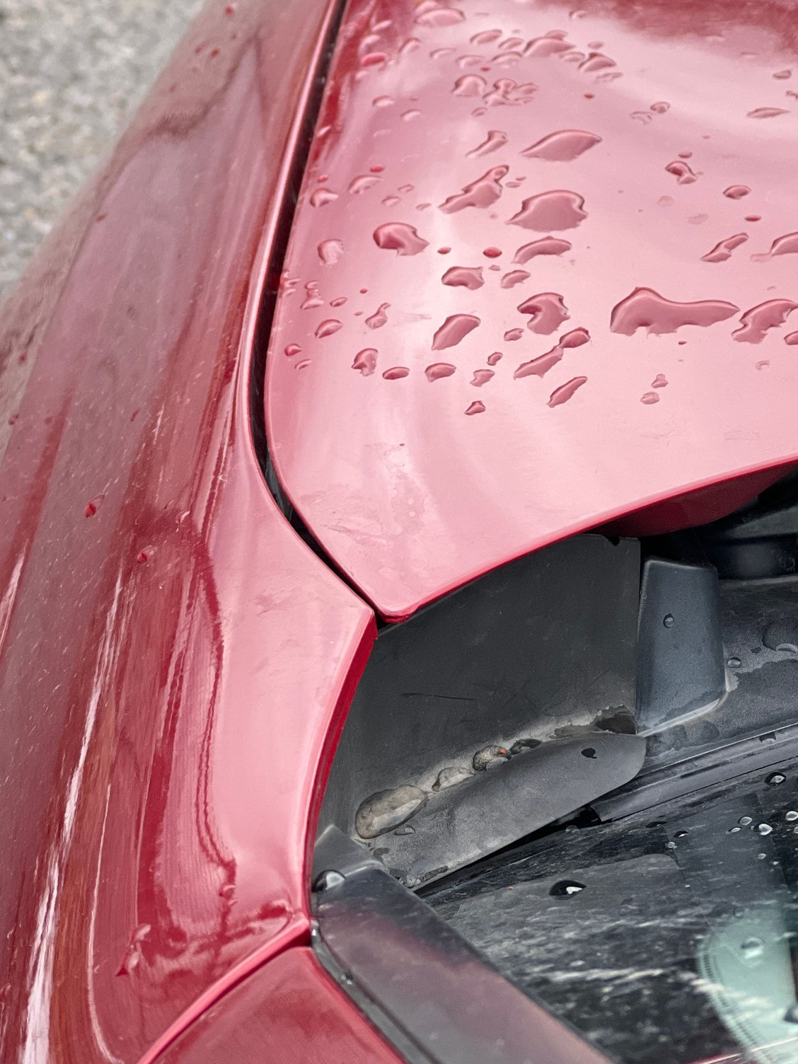

my 2014 es350 is off a little on the driver side up top towards the windshield do these make everything flush? It’s annoying me.
It’s a little lower up top.
