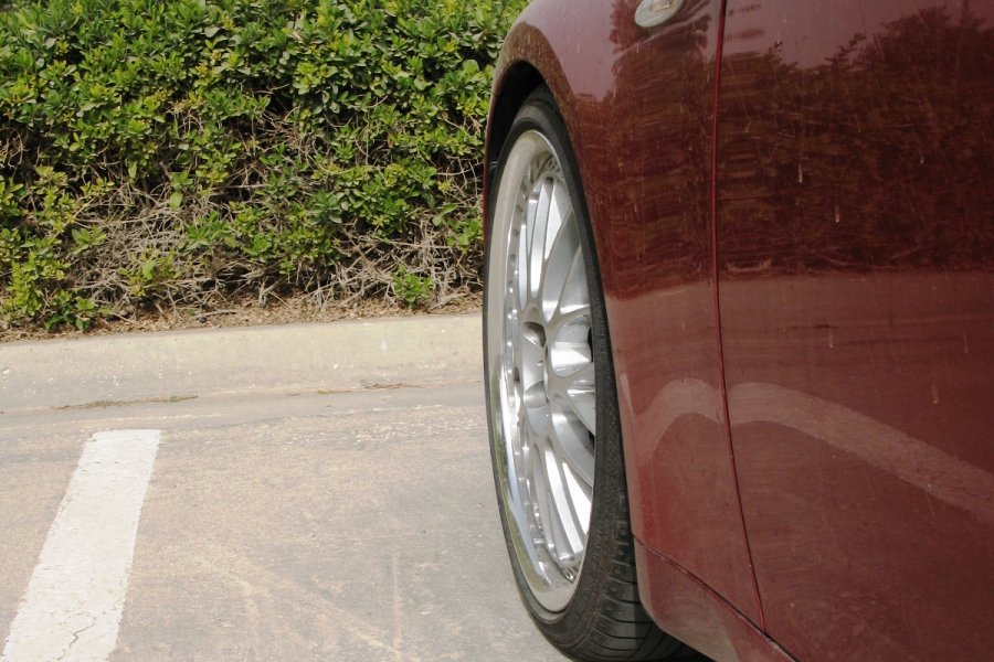

Originally Posted by DLam
since 45mm is conservative offset, does that mean it will not be flush or what not
my guess is that +45 at fronts will look full faced, you might also need spacers with that offset.
i have 8.5 19's +40 at the front with 235/35/19 CSCII and it's flush enough for me (not hella flush though lol) and i kept a reasonable safety margin between it & the fender. I wasn't after a loud aggressive look anyways
& you most defiantly want to drop the car a bit, best of luck!
