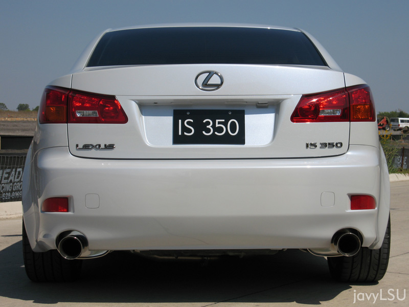

There are a total of 6 holes on the trunk lid: 2 on the "Lexus" wordpiece, 2 on the Circle-L logo, and one each on the "S" and "0" in "IS 350". Below is a picture of the back side of the my stock emblems.
As for what to paint them with, just go buy some DupliColor automotive paint that comes in spray cans at Wal-Mart, AutoZone, etc... The important part is to sand them a bit before you spray them. The best sandpaper for an application like this would be modeling sandpaper - it comes in small 3x4" sheets, (which you can also find at most Wal-Mart type stores) and it has the fine grit needed for a good-looking and durable finish.

can someone take a picture of the emblems after sanding them down? i want to see how much your supposed to sand off. i dont want to do too much or too little

You don't really want to sand anything off - the purpose of the sanding is to make the surface textured so that the paint will have something to adhere to, not to take anything off. And yes, DupliColor does have clearcoat spray available too.

I went to a local body shop and they said that there were no holes. Good thing I read this before I attempted to take them off.
On another note, does anyone one know if they are if the 07's might not have holes? and they quoted me 170 to fill them in.. is that too much?
