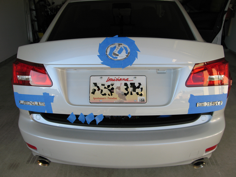

I'm trying to frigure out the best way of putting the new ones on. THere aren't holes in each letter, so it's easy to mess up...
I guess I'll just have to have very steady hands...

I installed mine by taking painters masking tape and marking the top and bottom of the IS350. Then I lightly marked where each letter started and ended and then peeled off the old lettering and placed down the new ones in the same spot after using some detailer to take off any residue.
Worked perfectly.

Like so:
