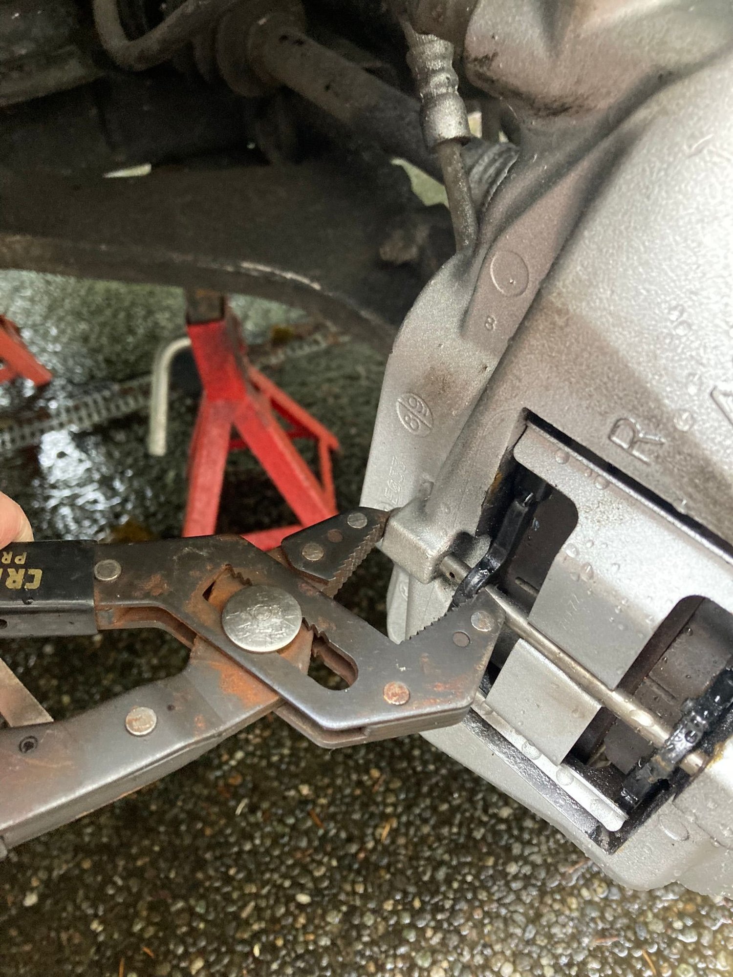

Here is how you avoid all that nonsense. Summarized up top. Pics below.
1) use pliers to compress the piston while the brake pad is still installed. Leverage, baby. EZPZ.

1) - Squeeze now. (Brakes were just re-done, for illustration purposes). No need for c-clamps later and all that.

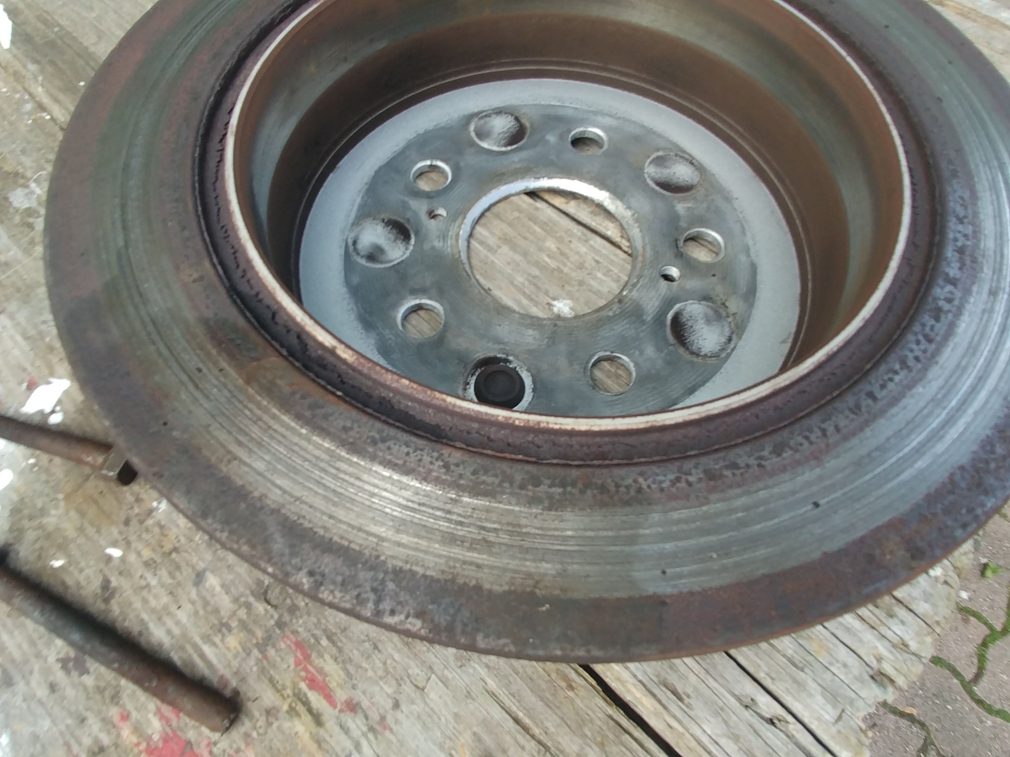

OK so I took off the wheel and found the inner pad worn to metal. Rotor isn't gouged.
Do I just have to lube the caliper with grease and slap new pads on or should I replace the rear rotors?
How do I know I don't have a seized caliper?

Is the rotor smooth all the way edge to edge? It looks grooved, but pics can lie. Metal on the rotor usually ruins it. My local Napa turns rotors for $10, you could always take it to them and they can judge and mic it to see if it’s still in spec if you are not able to measure it yourself.
Put the new pads in and have someone hit the brakes and release; watch to see if the pads (piston) retract. The extreme difference in wear implies a problem. They are easy to rebuild yourself, too. You often don’t need a rebuild kit - just take them apart and clean the piston and bore with crocus cloth. On the same gen GS the lower pin is captured and you can’t remove and clean/lube it even if the piston works fine. I think this is the same. Make sure it allows the caliper to float and is not seized/rusted. Mine were and in that case you need new calipers.

The rotor looks smooth; there's rust where there was no pad contact for maybe 200-300 kms of driving.
