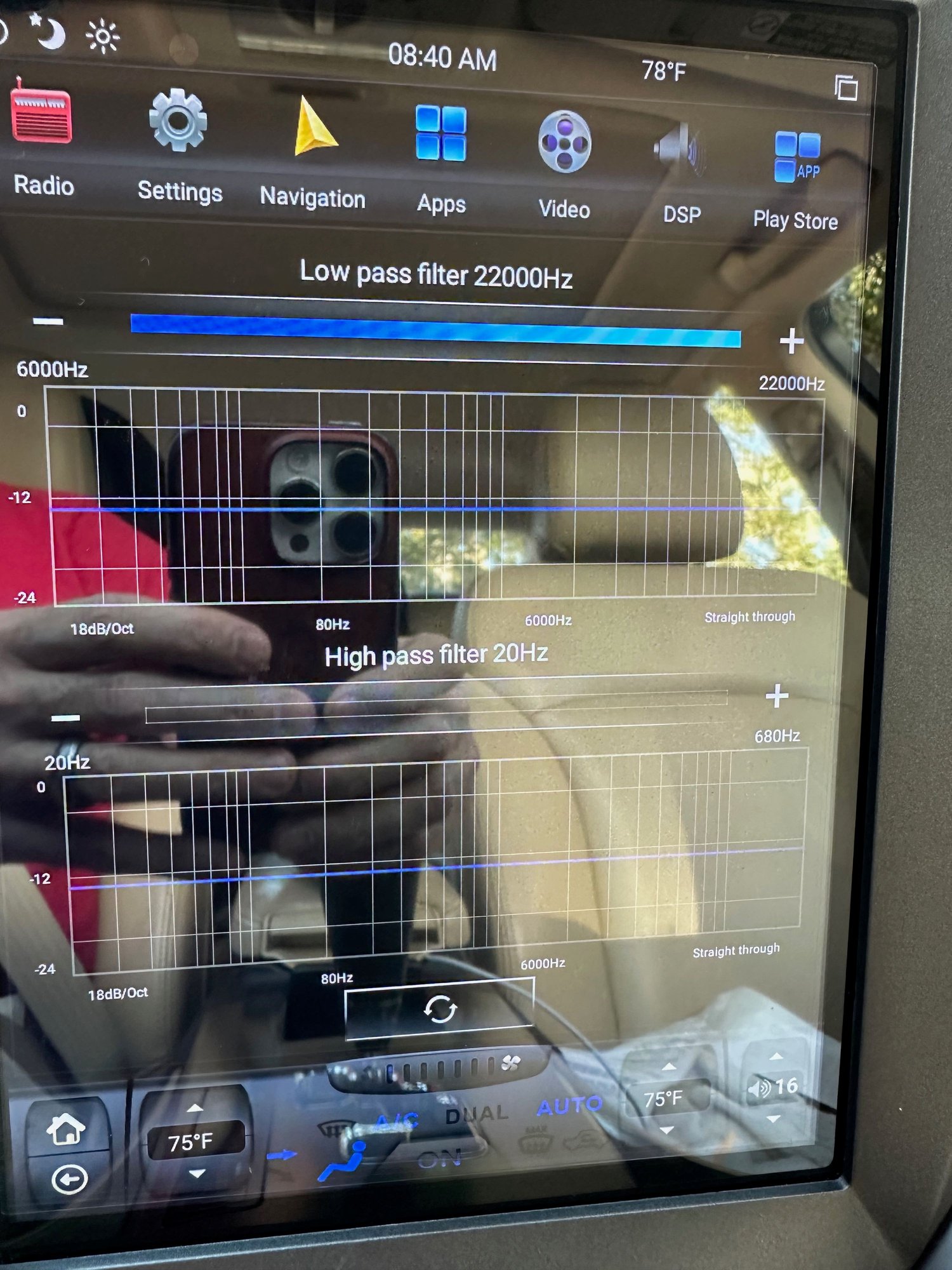

I'm trying to get the crossover, low pass filter and high pass filter Hz setup correctly.

I have an aftermarket amp now (JBL). The crossover is set to 80 Hz. What should the High Pass Filter Hz be set to? The headhunt had a plug-and-play harness but had to pull the factory backup camera out of the factory harness to put an RCA jack on it.

So, nothing will blow up by default? Is that low/high pass for everything, or only for sub? What you could do is find the youtube video with frequency sweep and play that to determine the audible range, and set cut offs to that (don't blame me if you blow out anything )

Okay. Let's make sure I understand this correctly.
The doors each have three speakers, a mid-sized woofer, mid, and tweeter, with the mid and tweeter sharing a connection to the AMP. The door woofers have their own connection to the AMP. The mid and tweeter can support 500 Hz and above while the door woofer and rear trunk woofer can support the normal subwoofer range?
The head unit has front left, front right, rear left, rear right and subwoofer outputs. My gut tells me the AMP is then splitting the signal to the door subwoofer / mid and tweeters. This also probably means the HPF is for all non-subwoofer outputs.
I have this AMP going to the speakers. https://www.jbl.com/car-amplifiers/D...car-amplifiers
Attached is the PDF of my system.
