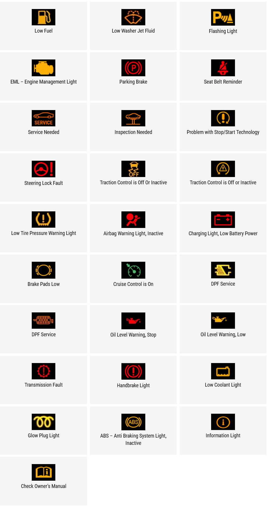

Seen that previously... The vehicle has power, any idea on the icon?
https://www.obdadvisor.com/dash-ligh...ight-meanings/

Thanks!
I drilled and beat the steering lock off but the steering still feels locked. I`m guessing I need the right OBD2 device to diag the car so I am headed back to my other thread.
