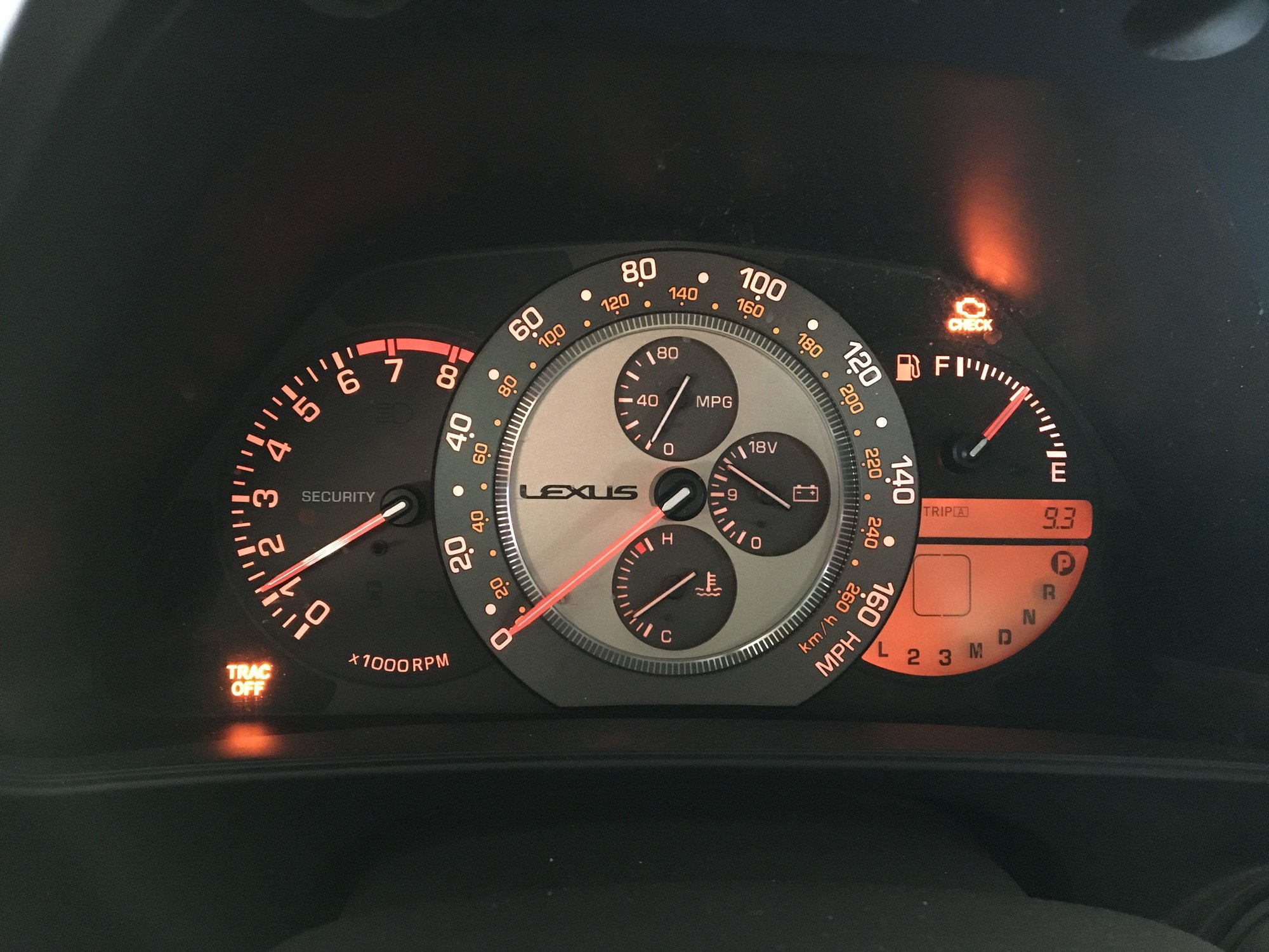

Okay, so Fedex finally showed up with my O2 sensors and it took me a bit on the
B2S2, cause of the darn connector and the rubbery thing... but I did it.
Almost all of my previous 7 codes are gone now. but now 3 new codes have appeared
The C1241 is back. So I will mess with the battery connectivity again, and it will
dissapear.
C1223 - but this is no surprise- we are planning on new brakes, calipers and rotors.
C1224 - the VVTi circuit.
and she is limping AGAIN! ��

But not so great that you need even more work.
But are you sure you mean C1224 - VVti Circuit?
I do beleive C1224 is communication problem with one of the ABS-sensor and that could also be the reason for C1223.
Or do you mean P1224?
Also C1241 Low battery voltage would be the firts thing to sort out since low battery voltage could cause other things to not work properly and therefore create "fake" fault codes
So make sure your batery terminals is good and tight, otherwise check the health of your battery

AND THEN.....
So this morning ...
None of the previous codes from yesterday afternoon are there, except a new ABS code C1201
Now it’s showing the throttle codes again. P2121 and P2127
I am trying to find the correct terminals for the APPS connector, and am making new pigtails, which will
hopefully fix this issue.

Crisy - one of the things I would look at as well is the battery connection. Your car shouldn't be "ok" sometimes and then have check engine lights at other times. This makes me think that your battery is letting the ecu reset and erase it's stored codes. I'd go over the charging system (i think someone else mentioned this in one of the other threads) because before that is absolutely 100% working properly I wouldn't expect that troubleshooting the other stuff will work.
*Test the battery voltage with car off and at idle.
*Test the voltage coming out of the alternator to see if what is seen at the battery differs from what is seen at the alternator.
*Test the ohms on the wire that charges the battery from the alternator if they differ.
*Make sure you have every factory ground possible hooked up and in good condition (use the manual to find those)
Your battery should be just over 12v all the time with the car off and 14 or just above when the car is on. If you're very far off with either of those numbers I would address the charging circuit before buying anything else. New APPS sounds expensive!

It tested over 12 volts every time and the dash gauge shows it right around 14 when the car is on. I think it had a new alternator. It seems to happen when I hook up the positive side a certain way... so I’m making sure not to do that and now there is no issue.
Found the APPS for around $130 new discounted.
Guess we will see what happens next!
