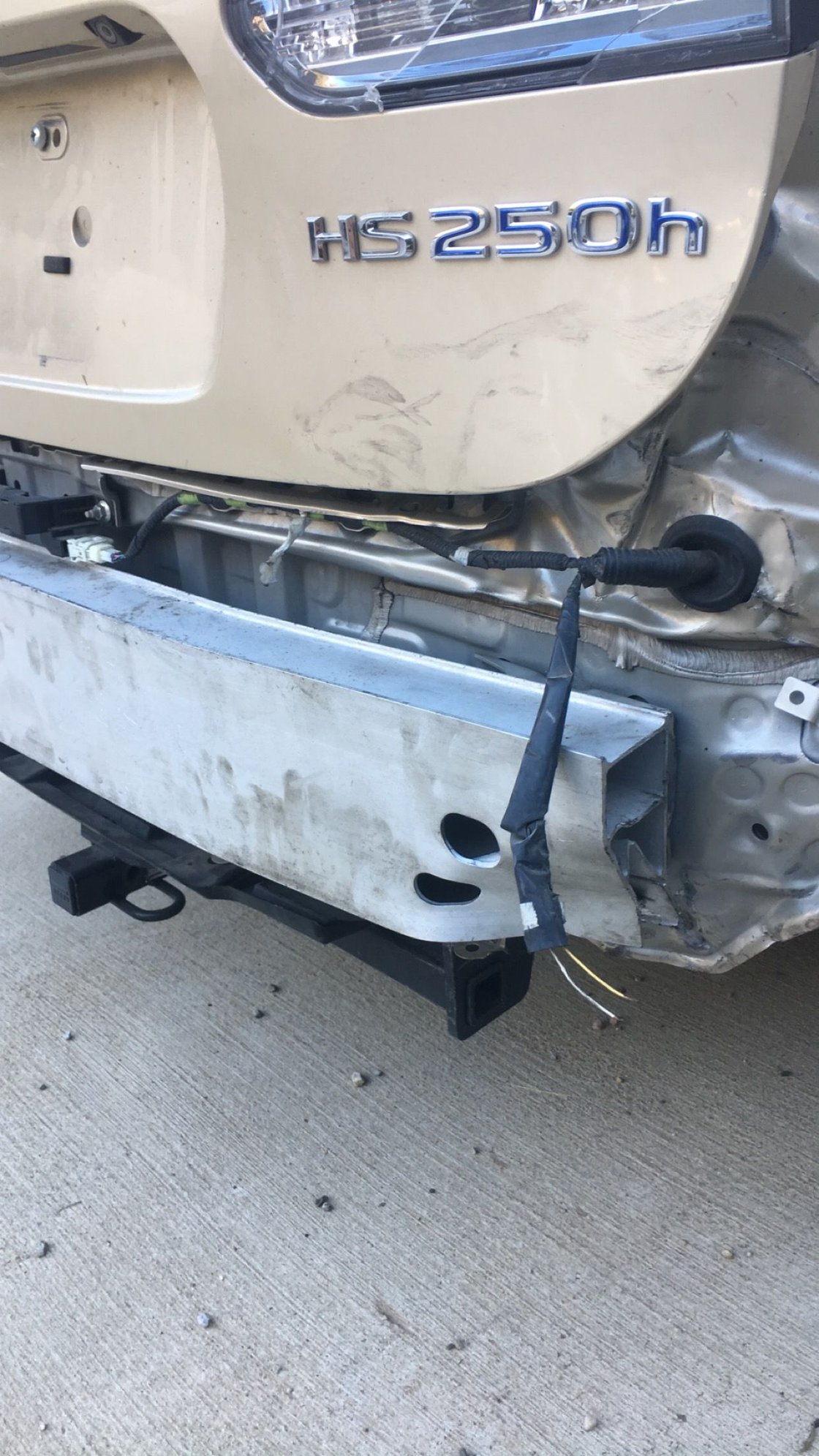

Hi all,
recently I was rear ended in my 2010 HS and am in the process of repairing the damage. I have most of the new parts installed and the damage mostly “fixed” but there are two wires that I can’t figure out where they go to. I have looked at parts and wiring diagrams but haven’t found any useful info. Does anybody know what the yellow and white wires in the picture below connect to?
Thank you

Sonar parking sensor? "Intuitive Parking Assist" was optional on the HS. It's only a guess. Vehicles made by Toyota are sometimes wired for parking sensors even on vehicles that don't have them.
