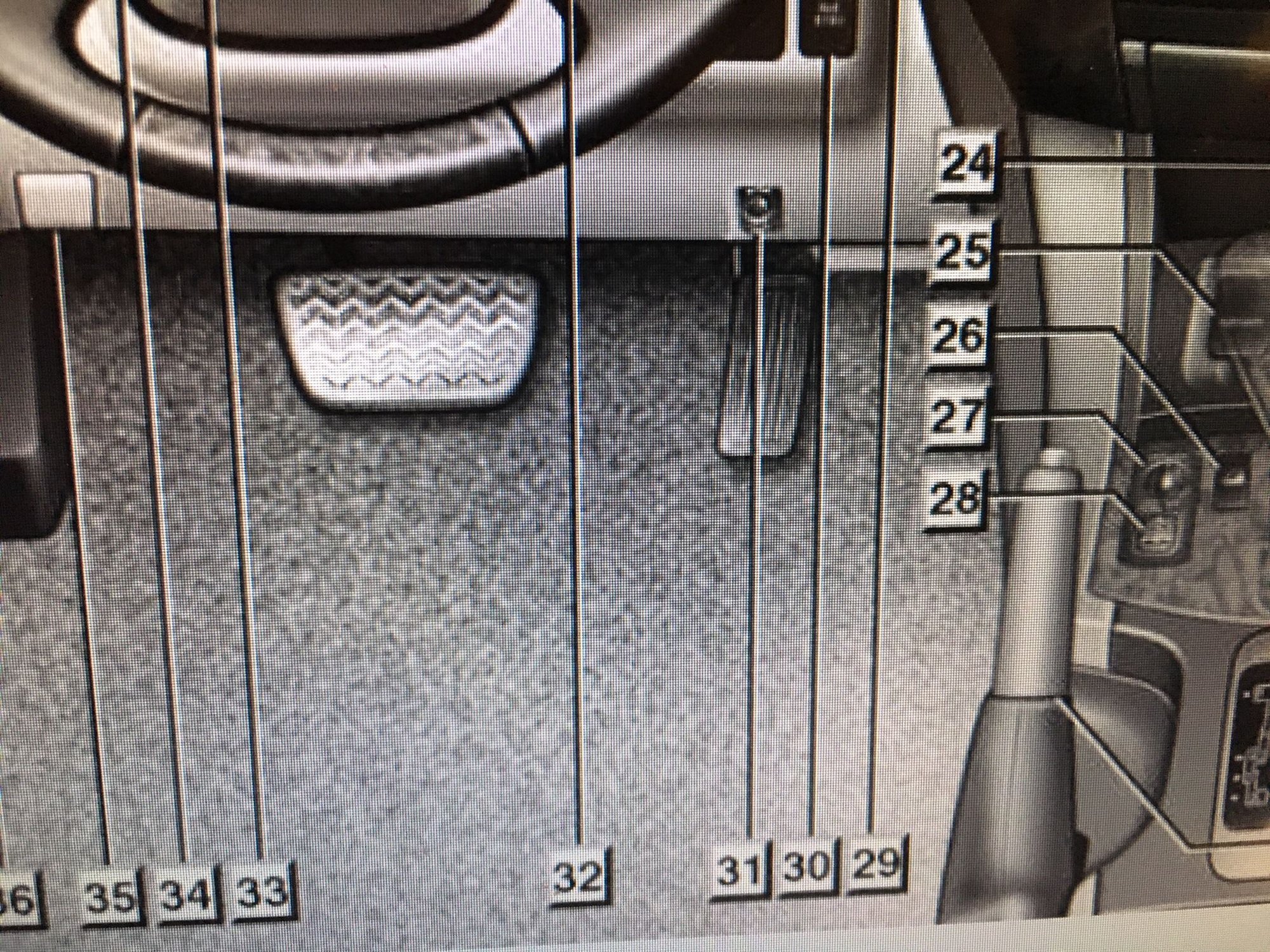

Can you take a picture of it? Only 5 slots in TS for tires on mine. 5th is the spare.

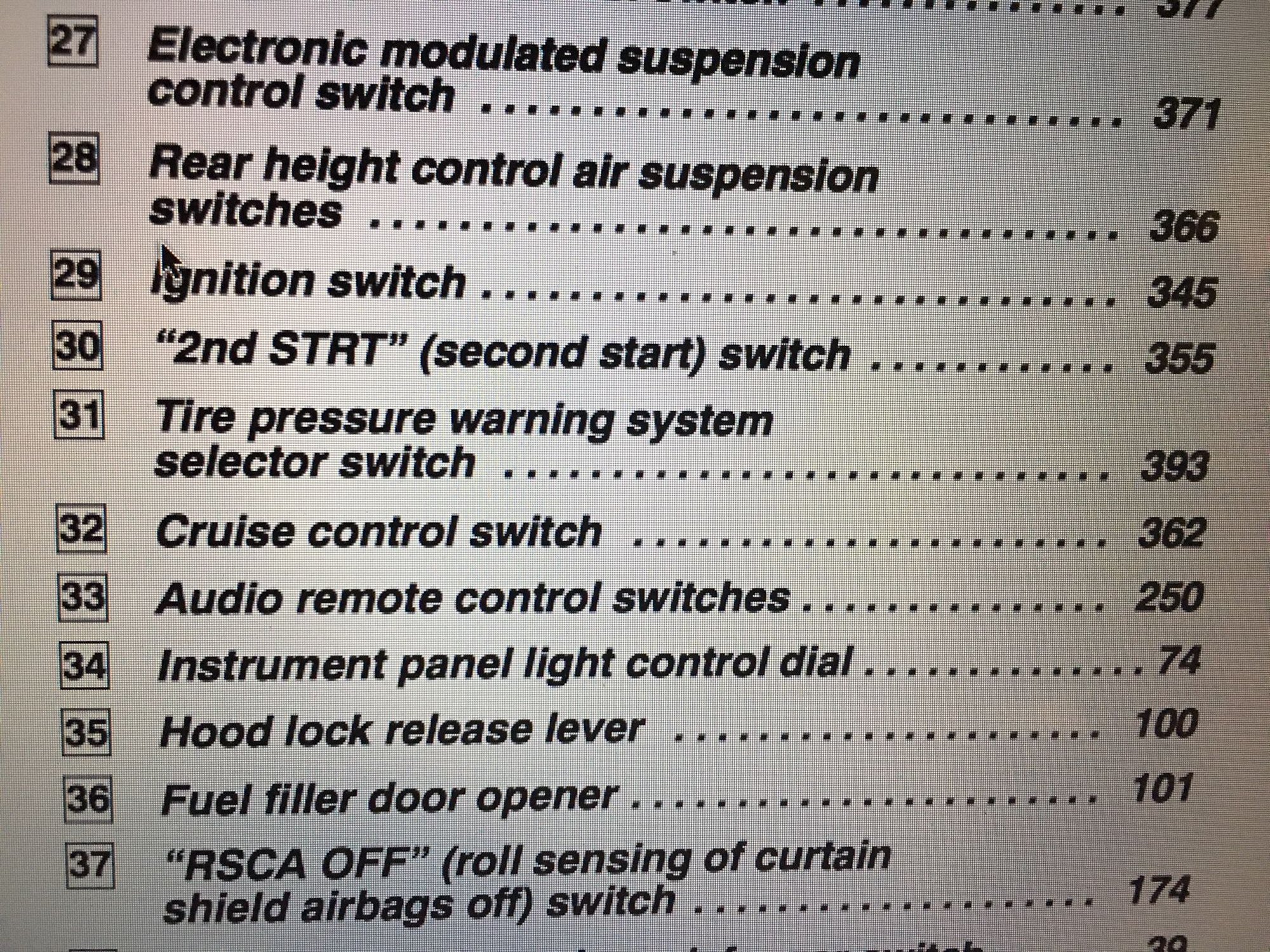

Button #31
31-Tire Pressure warning System Selector
Manual says that it should be a way to program 2 sets.
