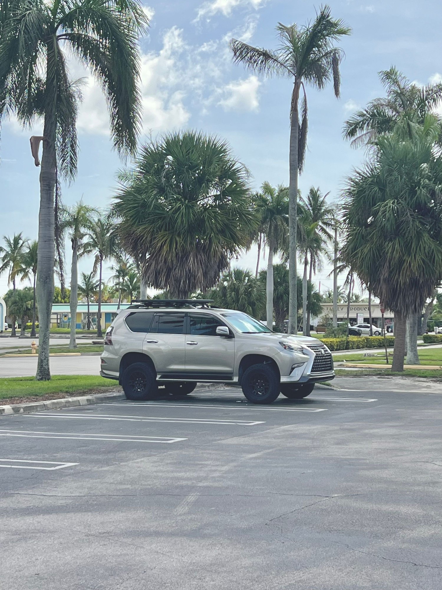

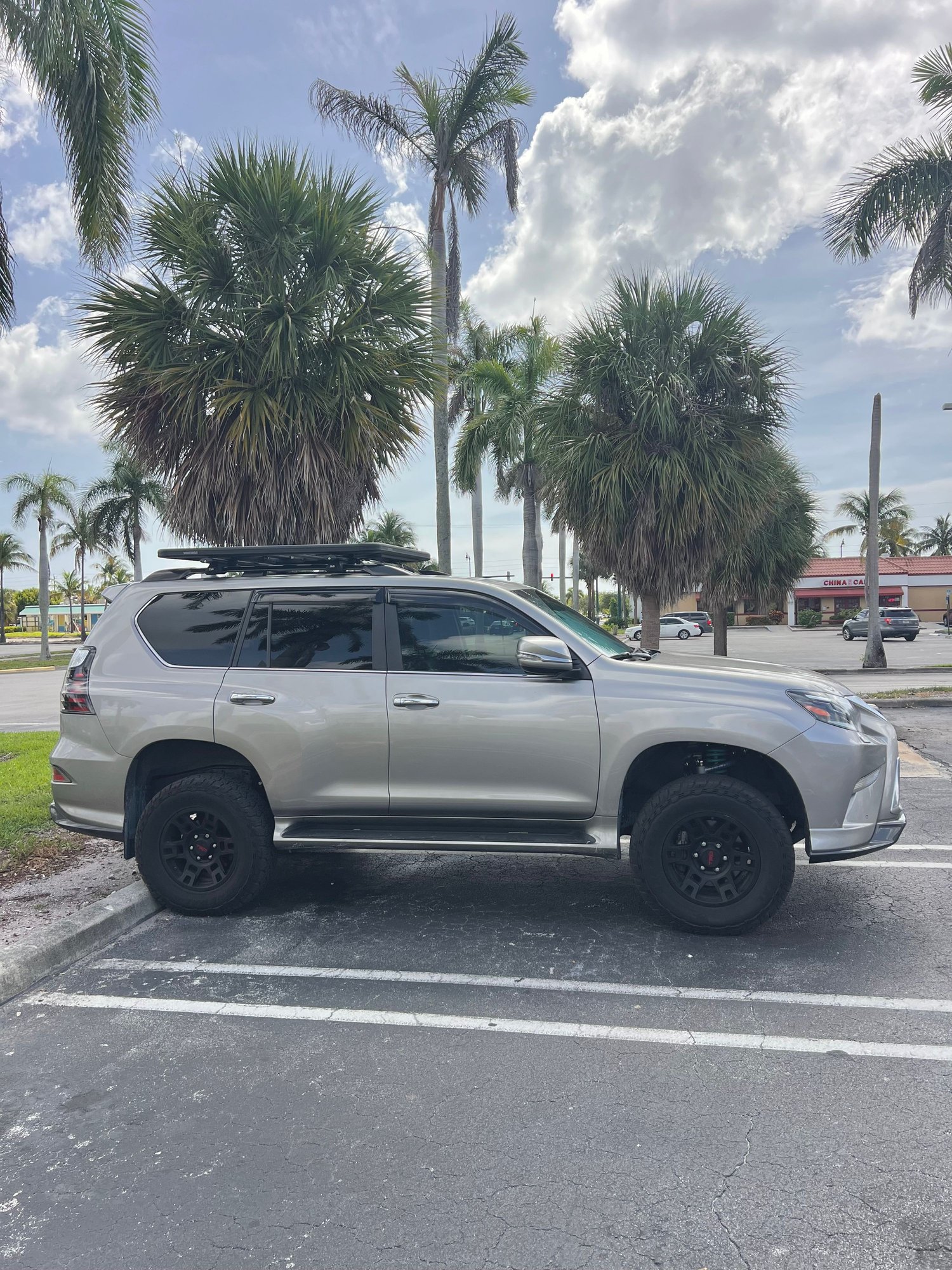

Bilstein 5100s all around. 4th position gives 1.75" lift in front basically level (front about .5" lower) Stock springs with added inflatable helper bags in the rear for towing.
265/70/17 Open Country AT 3s. Probably could have gone a little bigger but it's all good for now looks way better than she did!

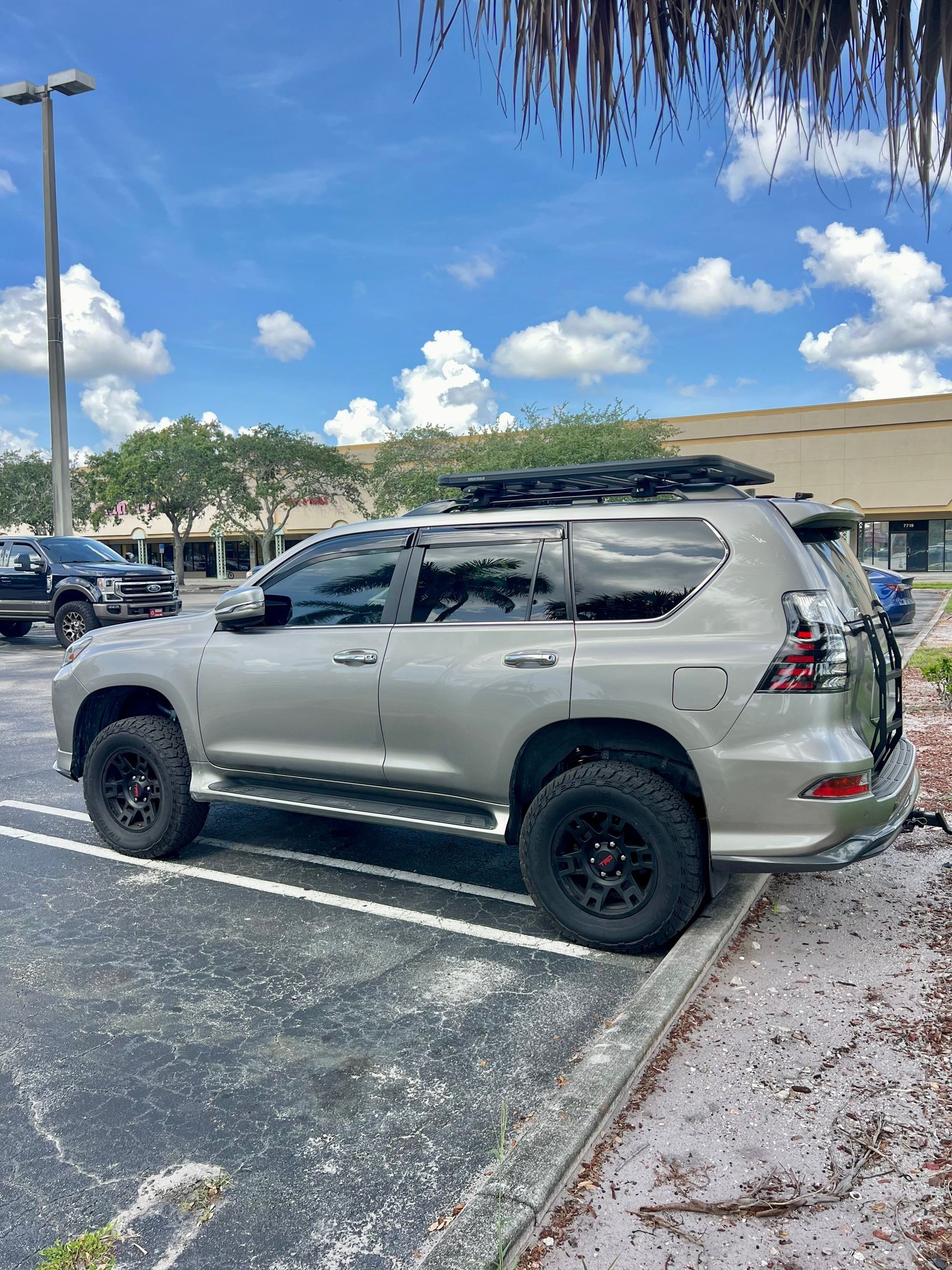

Resurrecting this bad boy

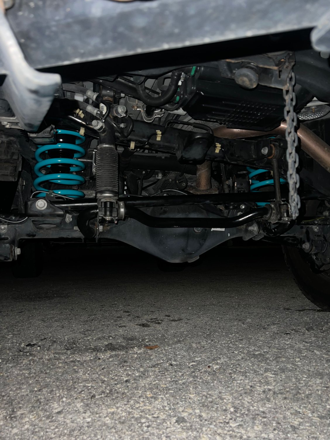

More goodies
