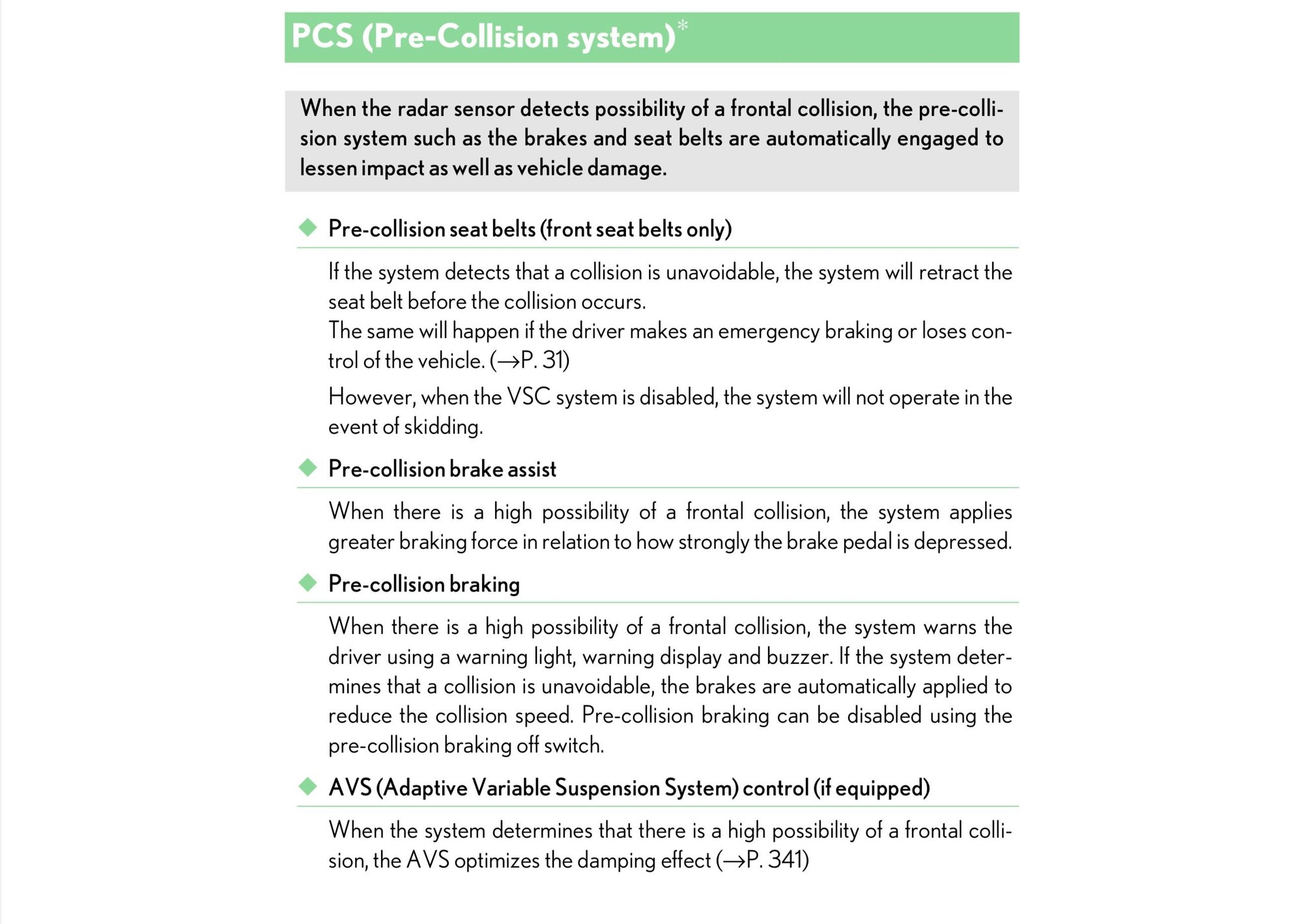

Default PCS and Seat Belt Tensioning
I have a new to me 2017 Luxury it has the PCS system. There have been 2 times when the belts tightened and then release which I have never experienced in any other vehicle. First a dog ran in front of me and I braked hard from maybe 15-20 mph and the other is when someone stopped short. First one didn't trigger the system as it didn't beep but the second one did both times the seat belts tightened up then released. This isn't the locking when you pull quickly it does do that too there was no impacts just braking hard. I googled but maybe I am typing in the wrong thing and I am curious about this system.
Old Oct 6, 2020 | 05:32 PM
  #38
hzhao's Avatar
hzhao
25 Year Member
Joined: Apr 2001
Posts: 1,985
Likes: 1,045
From: Northeast Ohio
It is designed that way, normal behaves.

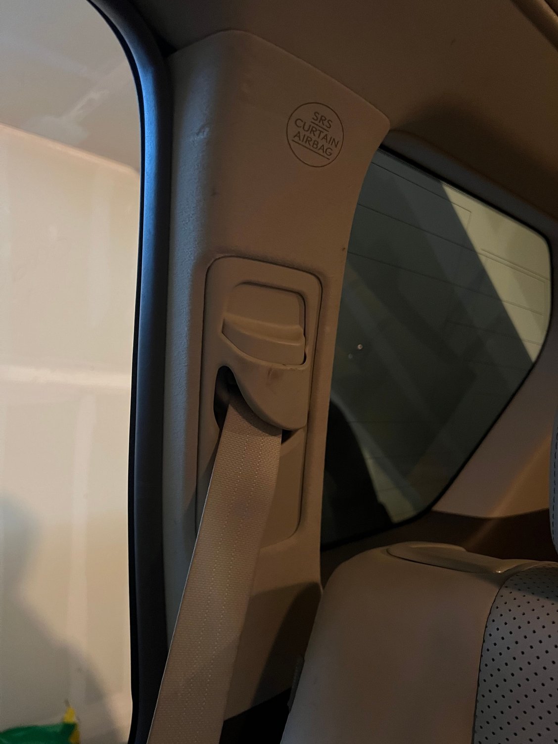

Old Jan 12, 2024 | 03:52 PM
  #45
Johnstamos's Avatar
Johnstamos
5th Gear
Joined: Jan 2024
Posts: 5
From: CO
Default Rear Seat Belt Assembly not functioning
this weekend, had the middle row passenger side seat belt crapped out. Might have gotten smacked by something.
the actual adjustment mechanism isn’t working, it’s just stuck in one spot, and the button to adjust it just doesn’t do anything and is stuck slightly depressed.
seat belt does retract unless I physically reach my finger in and push up on the button to disengage it.
So the dumb question is: can I remove this panel even though it’s got the side curtain airbag?
