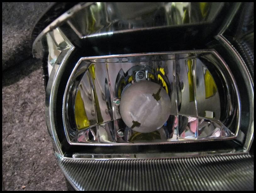

Originally Posted by RCsGX
That's weird that both bulbs are out but it is possible.
It's easy to remove the fogs. There's only 1 bolt holding them in from the back then you push it out from the back and pull it out from the front.
See attached PDF and start w/ # 6. I don't know why Lexus says to remove the fender liners and bumper cover. It literally takes 10-20 secs. to remove them. No wonder they like going by the book hours!!
I use standard H3 bulbs from Autozone, O'Reilys etc. I've always liked yellow fogs so I installed some Lexus yellow glass capsules. Now I can run a standard bulb instead of the more expensive yellow bulbs.
Do you have more info on these capsules? It appears that you have to take the lens cover off to put them in, right? Do you have the Toyota part number?

I've always bought them in the classifieds over at hidplanet.com. Here's the link of the guys that's selling them. I've bought several sets from him in the past and if he doesn't have any for sale he can get them for you.
http://www.hidplanet.com/forums/show...r-lenses/page2
And yes to install them you have to remove the front plastic lens. Don't have a part number, sorry.
