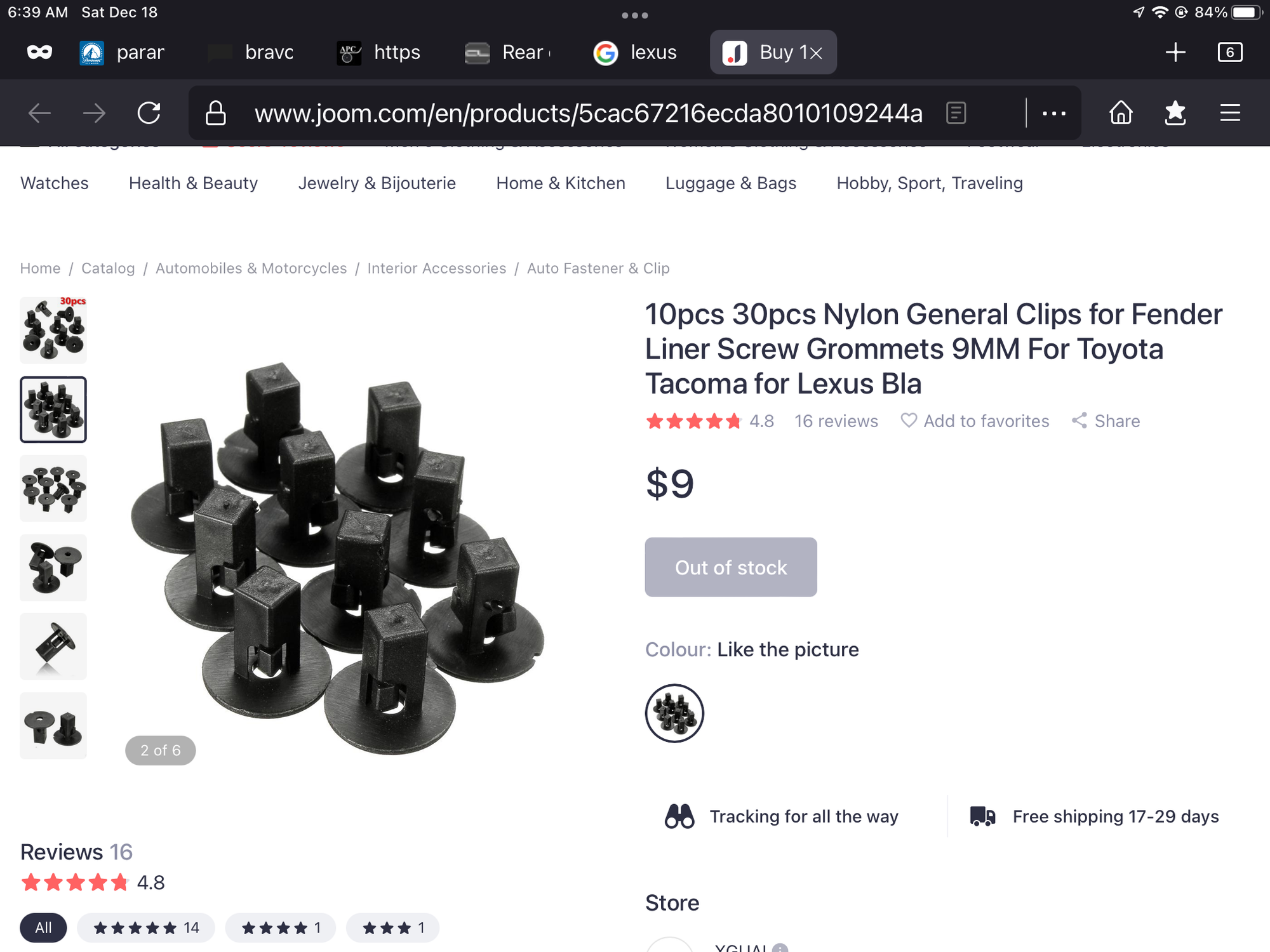

Hey all, trying to remove the rear door cladding piece on my passenger side, a couple of the upper "snap in" clips are not engaged in the piece (looks like someone previously pulled it off and didn't get them reinstalled correctly), but I can't figure out how to remove these "lower" clips:
Do they just pop out with pressure like the upper ones? I'm worried I'll wind up breaking it.

I was not able to remove the clips from my very original post. They attach the moulding piece to a metal reinforcement that's held to the truck via 3 10mm bolts. Once I popped the plastic clips out of the rest of the panel I was able to bend it just enough to remove the bolts. They appear to be some sort of pop rivet, and might not come out at all. They were not the 9mm nylon square pieces listed before, perhaps those are used on another part of the molding?
