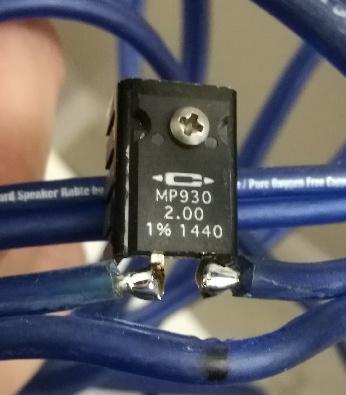

Here's a pic of the 2ohm resistors with small finned heatsink I use to correct a 4ohm for use with 6 or 8ohm sensitive drive(amp) units. Yeah, it's wasting a little power, but on a 4ohm speaker it becomes more like a 6ohm, so an 8ohm drive will still push a little more current than on a 8ohm, so the speaker still gets enough power although that 2ohm is burning off some energy, etc. "make do" as they say w/o having to replace a bunch of stuff.
