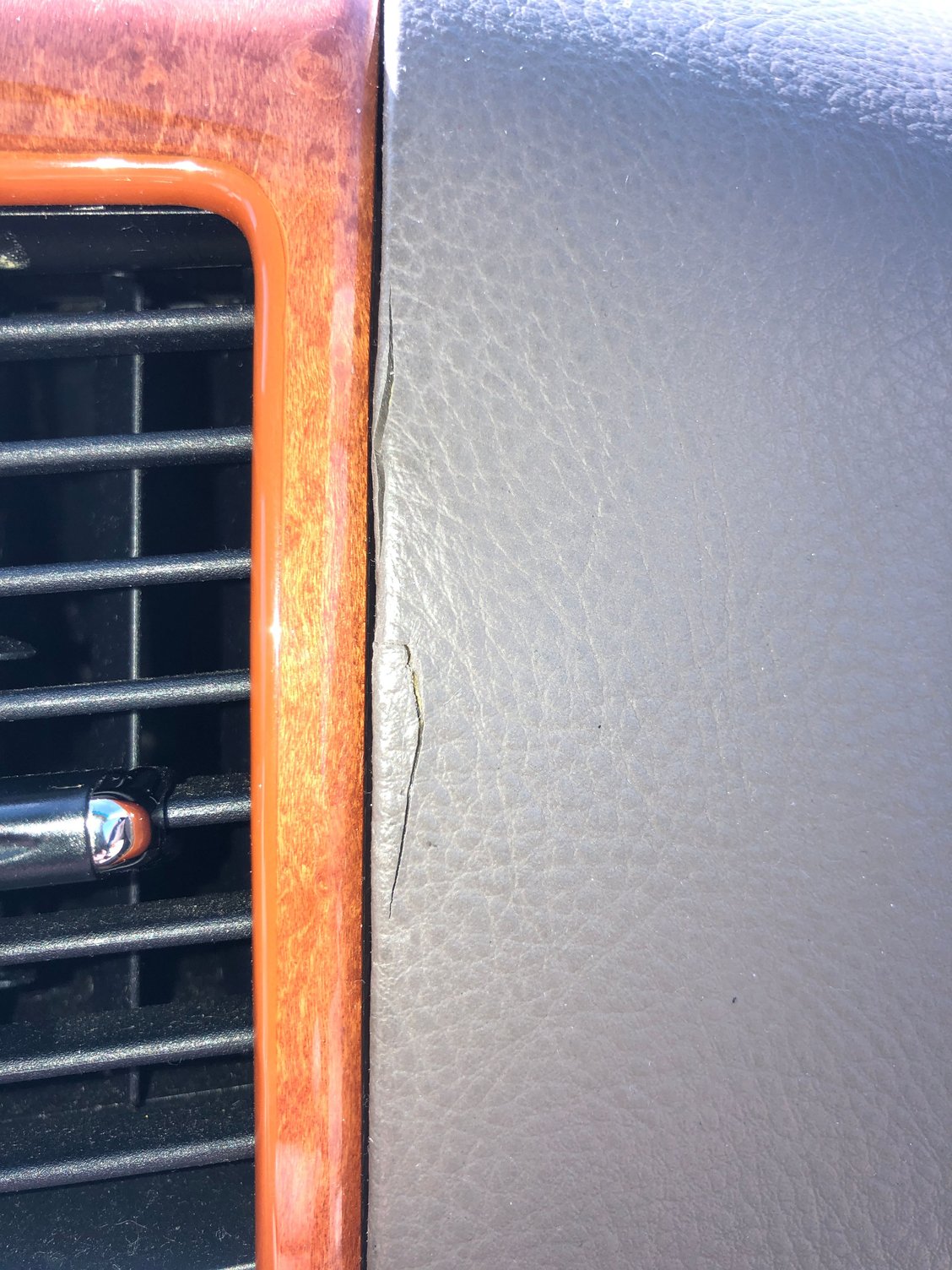

Old Jan 17, 2022 | 02:29 PM
brybell's Avatar
brybell
Joined: Jan 2022
Posts: 6
I have some cracking near the glovebox, but it's not very bad yet. Is there anything I can do to prevent it from cracking further?

What color is your dash? If you're out of any type of warranty work and don't want to buy a new dash, you can try to do a repair with Sugru. Look it up on Amazon. It's a colored silicone molding putty and it comes in small foil pouches. It works with black interiors pretty well. I'll attach a pic of radio button caps I replaced. Someone decided to remove them at some point, so I just molded a new cap right on the button. If you work with a rubber glove on your hand and warm soapy water, you may be able to feather it into the crack where it wouldn't be noticeable. If you have never worked with silicone caulk before, practice a little bit before applying to your dash. The glove is not 100% necessary, but it will keep your skin and nails from getting stained. Take a drop or two of dish soap and add it to a cup of warm water. Put the Sugru in place on the dash and mold it with your gloved fingers, dipping your fingers in the water first before pressing it into the cracks. The warm soapy water helps flatten and smooth the silicone. If you skip this step, it tends to dry lumpy. Once it's exposed to the air out of the packet it begins to dry so you have to work quickly. Lots of trial and error on this and I learned the soapy water trick from a friend. If you need a pattern embossed into the Sugru, that is possible too, but I won't bog you down with the details because most likely your cracks are thin. Any questions, just ask! It's a lot easier than it sounds!

Thanks! The dash isn't black...it's like a dark blue. These cracks are small enough and in fairly inconspicuous areas, I wonder if black would be ok.

according to this, you are able to custom mix colors. It would be worth a try. You can get a multicolor pack on Amazon inexpensively enough. https://sugru.com/how-to-use-sugru/how-to-mix-colours
