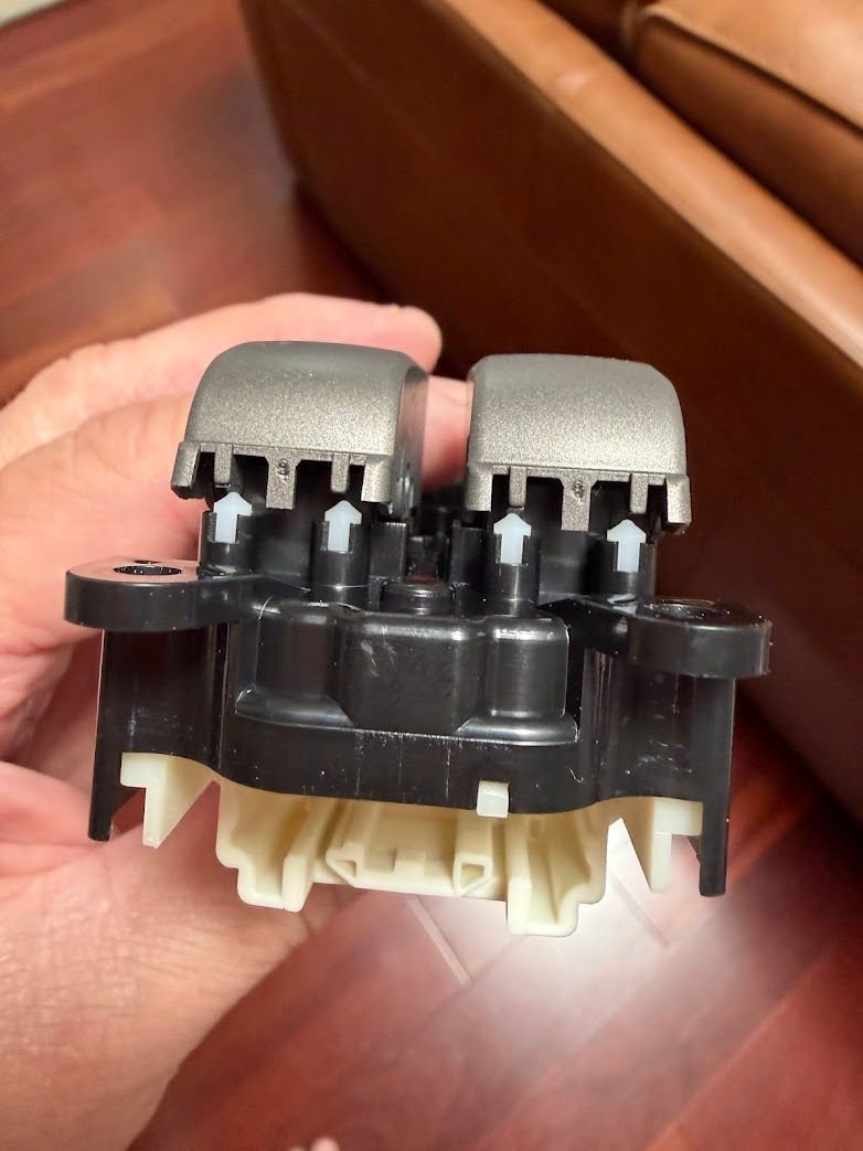

After removing it from the door, unplugging it, and disassembling the switch into its various components. I deteremine as you move the switch, there were 4 small nylon pins that moved and made contact with the positive and negative on the circuit board to power the motor. There are two pins for the up and two for the down. All the pins moved but one for the up power so i checked why that happened. On the bottom of the switch, the extremely tiny part that pushed the pin was gone. So I added a small amount of hot glue on the underside of the switch that was missing then let it harden. Now it would move the small nylon pin like the other 3. Upon reassembly, the window now rolls up! FIXED!!

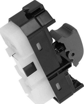

Here is the switch but I was not able to remove the rocker switch element. I had to separate the larger black section from the white section, remove the circut board to see how it powered the motor. Under that were the 4 small nylon pins the rocker moved that contacted the positive and negative elements on the circuit board to power the motor. Sorry I didn't take pictures but you the idea hopefully.

See the white pins below. There is a small tab inside the rocker part that broke off and I added a tiny dab of hot glue and it now works.

Nice fix Mez...
