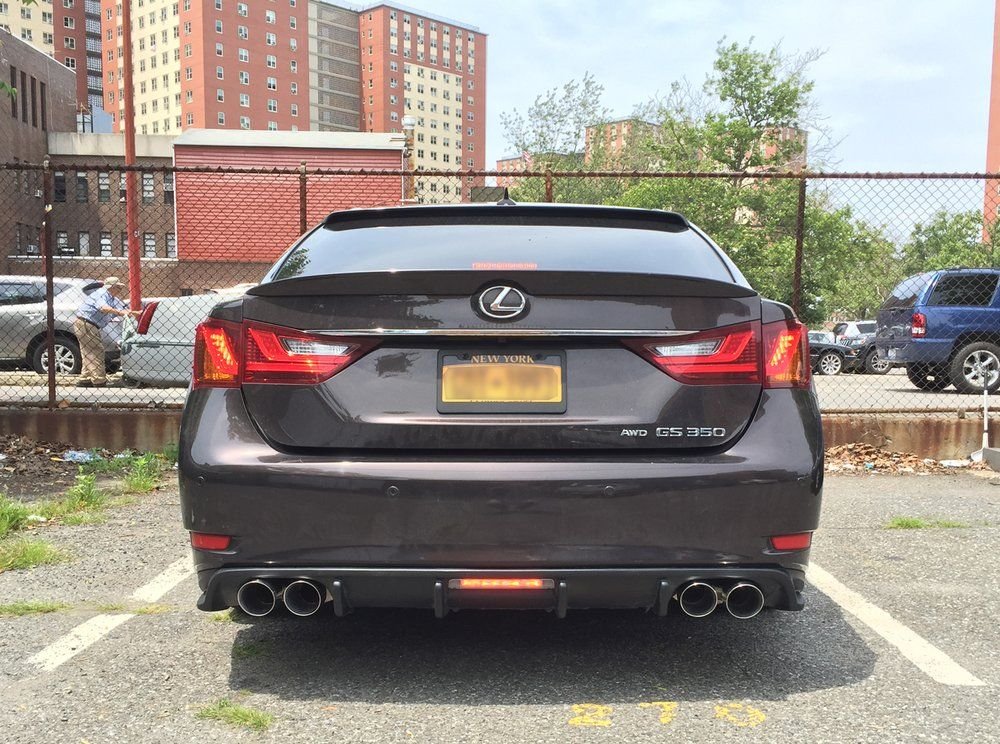

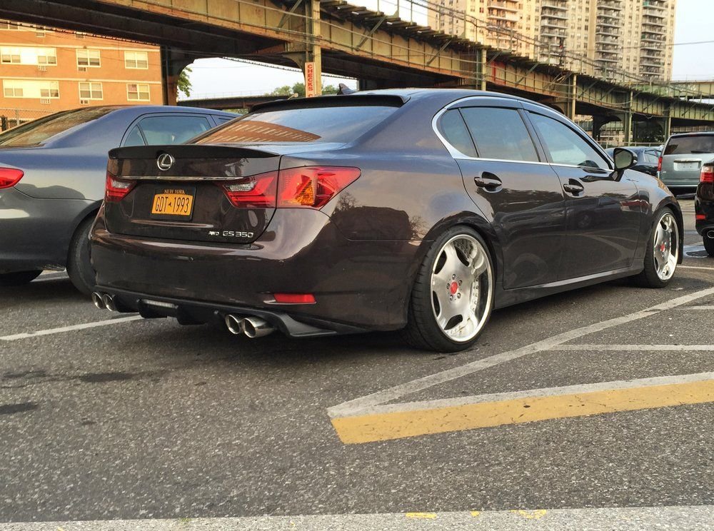

I have done it. I have the JoeZ catback exhaust with Lexon diffuser on. You have to adjust the hangers, otherwise the exhaust will hang too low and won’t be centered. This is what it looks like now,Originally Posted by dphu626
You can do a quad tip set up with the Joe Z. Just gotta cut and weld the tips. I believe the Apexi isn't as loud as the Joe Z.
Former Sponsor
Quote:
Can't remember what I was reading recently, or for which car, or for which exhaust .. but it said something about using the exhaust hangers upside down.. Originally Posted by SNiiP3R

Quote:
That looks so good!Originally Posted by SNiiP3R
I have done it. I have the JoeZ catback exhaust with Lexon diffuser on. You have to adjust the hangers, otherwise the exhaust will hang too low and won’t be centered. This is what it looks like now,Did you have to take the bumper off to change out the diffuser?
Yeah, I took mine off but only because I had to install the quad tips. I think you can leave the bumper on.Originally Posted by AsianxWu
That looks so good!Did you have to take the bumper off to change out the diffuser?
