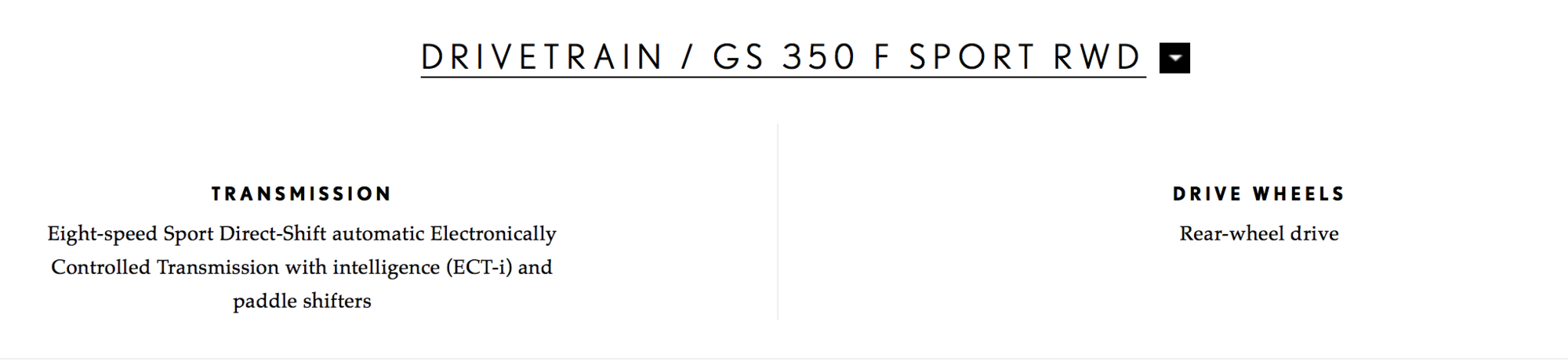

Here's the full quote from the Lexus site about the GS 350 transmission:
It also has the "Direct-Shift" transmission, which is why I'm confused as to whether or not it has the same capabilities.
