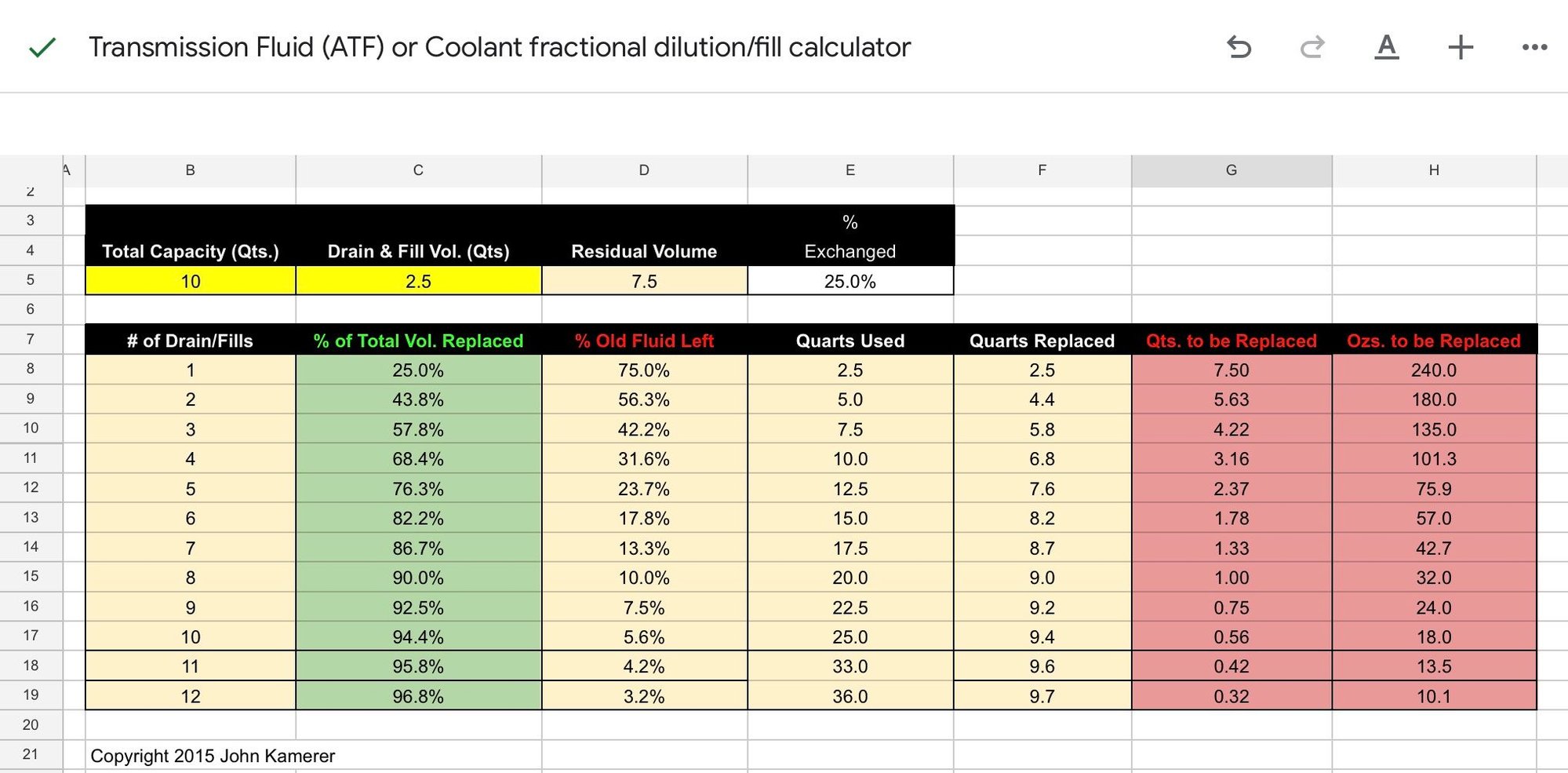

Valuable point. I made one of these years ago to share at Toyota Nation, IIRC. Iv’e set it to (what I think) are the nominal values on this transmmission. It’s a powerful argument for swapping it in an exchange once you know the whole volume is well-worn. I estimate it would take 10 to 11 drain/fills of 25 quarts to get the same amount of new fluid in as you can in a single 11 or 12 quart exchange. Drain/fill has very rapidly diminishing returns when you have a lot of dirty fluid you want to get out.

► Of course the chart (above) you posted matches up perfectly with the Excel Calculator (.xlsx file attached below) when using 10 Qts Total Capacity and 2.5 Qts for each Drain & Fill...
I think if anyone is planning to do D&Fs - for it to be effectively beneficial, at least 5 or 6 D&Fs should be the minimum goal to achieve about ~80% of the original fluid replaced, and the D&Fs should be completed within a relatively short period of time/mileage, i.e. within 2-3k miles. I think this goal of about ~80% of the original fluid replaced would be applicable for most any original liquid to realize a reasonable amount of dilution that eliminates a significant amount of contamination/impurity and to benefit from any additives available in the fresh fluid. This would apply equally to brake fluid, for example.

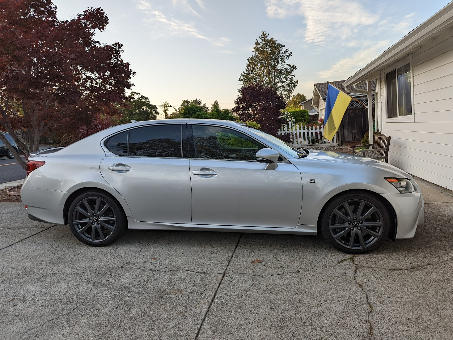

If anyone is interested, here is what I did... FYI I bought the GS350 F Sport used from Putnam Lexus in Redwood City; it was the owner's personal car before I got it. I do not know if the trans was serviced before I got it; I doubt it. The 2013 used the 6 speed trans.
At about 75K I had a great shop pull the pan and replace the strainer screen (filter) with the Lexus part. It probably took 3 to 4 quarts of fluid. The old fluid was worn, but not burnt. I used Idemitsu WS equivalent because it is a synthetic, WS is thought to not be. I cannot say for sure...
Last week, at 110K, I had a Lex/Toy shop do a fluid exchange; I gave them 7 quarts of Idemitsu I had and they added 4 quarts of WS. Of course there was no need to replace the strainer. This shop also told me the fluid was worn but not burnt. They recommended the fluid exchange instead of the spill-and-fill.
This car is perfect.
My post is meant to be informational only; some do not believe in trans services, others prefer partial fluid replacement. I was one of those, but after talking to some mechanics that I respect and the shop I used, I decided to do the fluid exchange. I am very happy with the results and will not service the trans for some time going forward.
I love this car.
