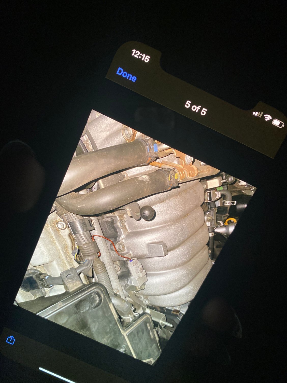

I started with a cylinder 1 misfire. Fixed it with new fuel injector. Now we got check vsc and cylinder 4 misfire codes. Replaced maf sensor. I will post a picture and I’m hoping u guys can tell me that obviously it’s missing a grind wire to this sensor. Please tell me what sensor. Mahalo from hawaii!

Pull out the plug and see if there is still a pin terminal inside. Its possible that the sensors ground is from the motor.
