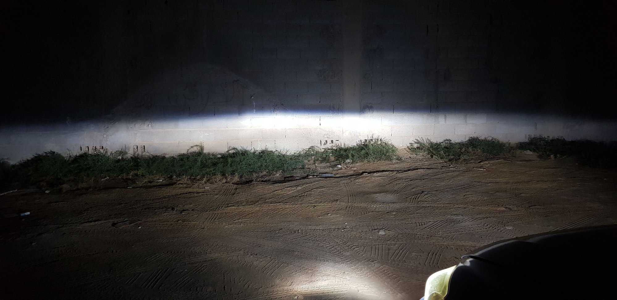

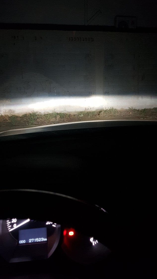

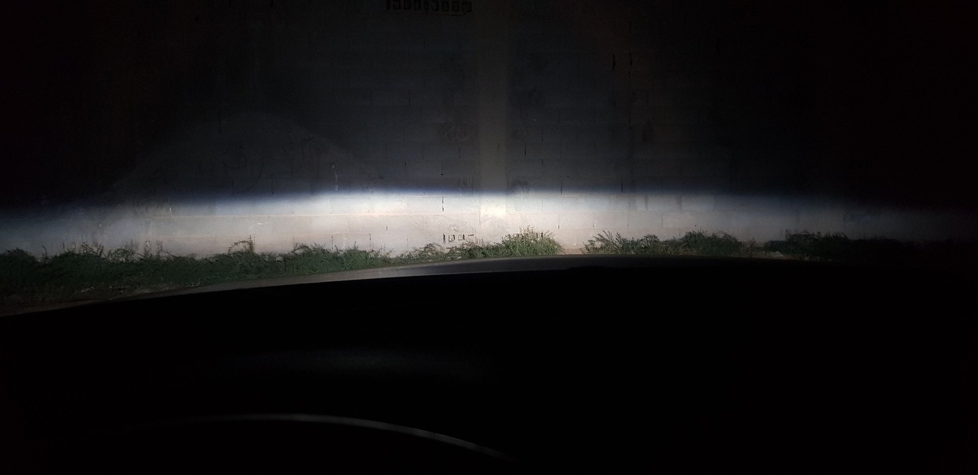

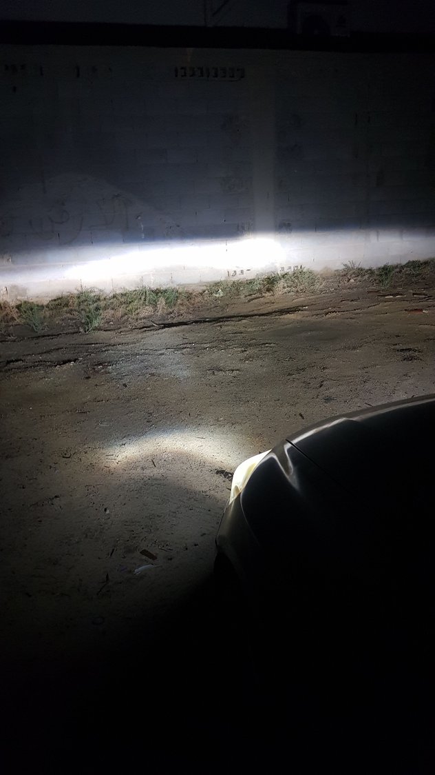

I have noticed that the low beam is weak to the extent that if there is a car behind me, there will be a shadow in front of me.
Tried several types of bulbs and the same problem, so decided to change the projecter lens since they have not been changed for 11 years ( the car is 2007 ).
Heard that the Q5 projectors are good and bright, but can not find the site to get originals ones.
First, how many inches the factory is?
Second, do you recommend specific type of projector lens?
Here are 2 pictures of the current light, it looks worse in real.

The Q5 is more of a budget projector and is around $80/pair from reputable sources. Their beam pattern isn't really something to write home about, but it is good for what you get at its price point. If it were me, I'd rather same my money for a better projector and just utilize the stock setup with all new bulbs. If you were to convert to the Q5 projector, you would also have to replace your current D4S ballasts to D2S ballasts, the Q5 runs a D2S bulb, your car runs a D4S bulb. If you were to just replace your current bulbs with higher performance D4S bulbs you would not need to replace ballasts.
Going from a well used HID bulb to a brand new bulb is very noticeable, going from a well used HID to a higher performance HID bulb. will be drastic.
Lastly, your photo finally loaded, it looks like your headlight lenses are a bit yellow and worn. Here is a good starting place to rejuvenate those Headlight lenses:
