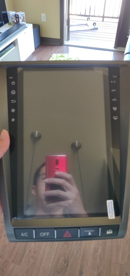

Look what came in today! I'm waiting for my backup camera to come in today. Amazon is slow...I'll create a new thread after I get the video and snapshots tomorrow.

I have the unit in. It's Plug and Play, really easy. If you install a car stereo in the past, then this shouldn't be an issue. I wish the fit and finish was a bit better. I'll have the videos on youtube today.

*Just a few cliff notes
The harness they provide will connect to all the factory harness. Nothing is left out.
I forgot to mention the Can-bus module. Please install that. It's necessary for steering wheel controls.
In the video, I mention that I couldn't get the sound to work. I didn't plug one of the harnesses. You are going to use all the connections on the main harness.
I figure out why the physical buttons didn't work. I forgot to plug in that harness. It controls the AC and hazard lights.
Temp shown on the bottom of the screen alternates between F and C. If you pull up the full AC screen, it'll show the temp in F.
My unit is running Android 6.0.4. Shows a total of 27GB after OS and 3-4 pre-install apps. I'm holding off on the backup camera. Looks like I have the take the outershell off the trunk to secure the cam.
The touch is sensitive. Some of the on-screen buttons are small. Could be an issue if you have bigger fingers.
Some takeaways. I wish they include some sort of support for the bottom portion of the factory bracket. Pretty much, only two screws per sides support the unit. It's not heavy but I would like this a bit more sturdy. They should provide longer GPS antenna cable. They included a OBDII plug but there are no inputs on the harness.
