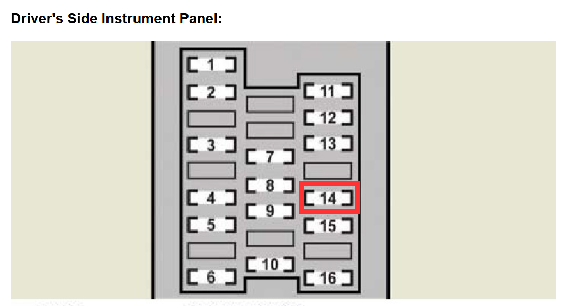

78works chrome headlights with flasher relay, ebay/junkyard used OEM ballasts, formula j87 6000k d4s low beams, remove AFS fuse.

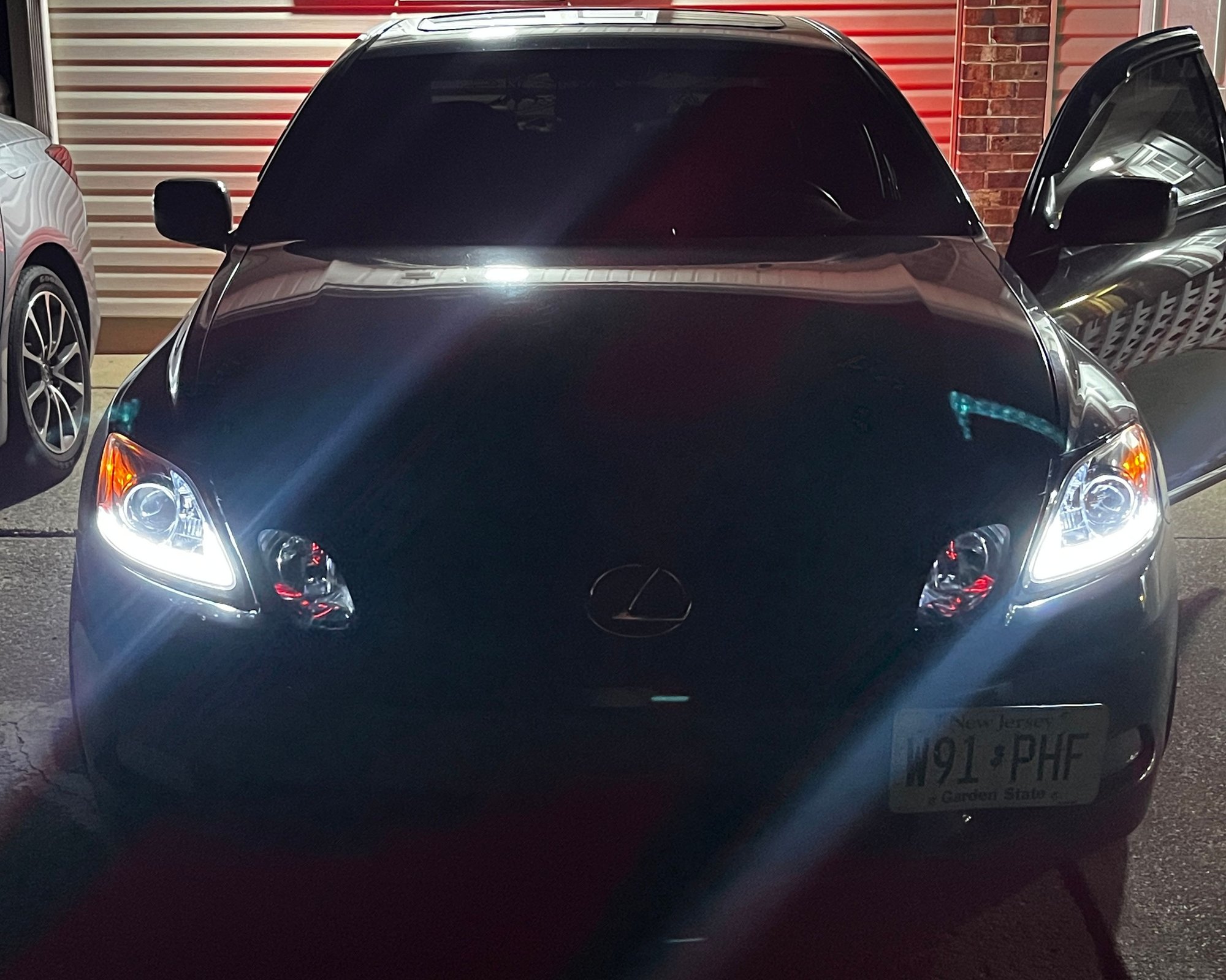

Heads up for anyone getting these headlights, while they look amazing for some reason they don't waterproof the main connector. The other small connectors are waterproofed, but the main connector is not. You need to apply some dielectric grease to make sure corrosion doesn't build up and block current after some time. They also have RHD beam but if you adjust them correctly it looks normal.
