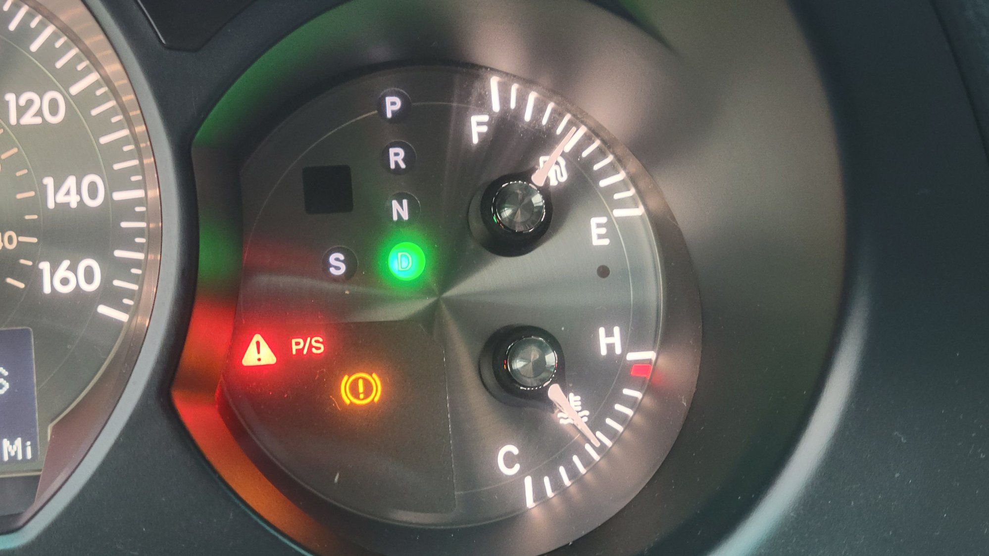

Hey everyone, have a gs430. Lights are popping on. But are intermittent. I can drive for 5 miles, park car, come back out and lights are on. Or I can drive down the road about 5mins, and they may pop on. But I have traction control light, red exclamation, tpms and power steering light. All solid non blinking. Although, power steering is weird and it comes on and off randomly, and sometimes when I come to a stop it'll pop on and then when I accelerate, it goes off. The powersteering is not affected and have full capabilities with ps even when light is on. I see rh wheel speed sensor circuit. If that was true and it was faulty, ABS light should pop (in my experience). I did just do a valve cover gasket, and tube seal job, so wondering if there's a connection issue especially since these lights are popping on at random times or even driving until destination without them coming on. Any thoughts or suggestions would be great!

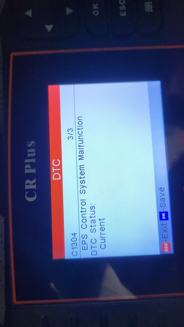

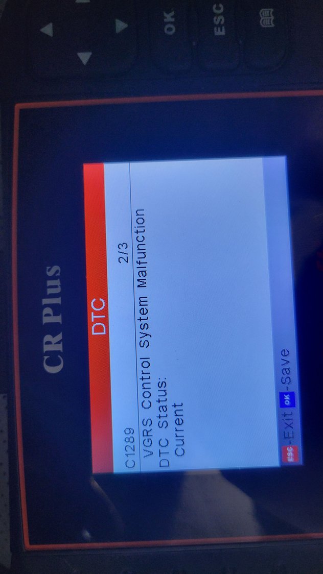

The C1304 and C1289 are both from your Brake control ECU and complaining about the other two codes (C1289 is that your vehicle stability control / VSC is malfunctioning, and C1304 is complaining that your power steering and brake are malfunctioning. These cars love to throw extra codes from multiple ECU just because one is confused.
C1567, that is the scary looking one, if true it is at best wiring harness damage and need repair, at worse a fried ECU. C0200 is easy to fix if it is true.
