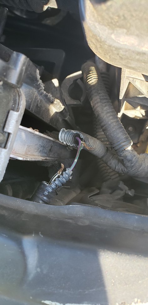

So I noticed two things that slightly concern me about my radiator.
I noticed that there's a cut wire that seems to connect to my radiator, or at least used to connect. I have no idea what this wire is. It's to the right of my radiator when looking at the front of the car.

Wire goes from main fuse box in the engine bay to the radiator.

Looks like the fan shroud has been literally chewed on by a critter probably same for the wire. Maybe that goes to one of the fans? I don't like seeing those stress cracks in the tank it usually means imminent failure.

Should I be concerned about the disconnected wire? How would I go about fixing that?

I just went and took a quick look under my hood. The wiring you are looking at is not for the fans. I can't tell where it goes exactly, but it appears to go to a horn, airbag sensor, or hood latch. At least for now the engine should be staying cool.
Thanks for the advice. Would reattaching the bare wires to each other + some electrical tape work? My horn works and so does my hood latch. A mechanic I took my car to before said that one of my side air bags wasn't working when he had a OBDII reader plugged in. So maybe it's that?

Could be, you can add wire as needed to reconnect them. I would. Even if you just use but connectors and pinch them. And yes, keep them separated by a generous amount of electrical tape. I would solder them myself or pay to have it done correctly. But probably not something you have to do. Just better to have a good lasting connection and weatherproof when shrink-wrapped right.
