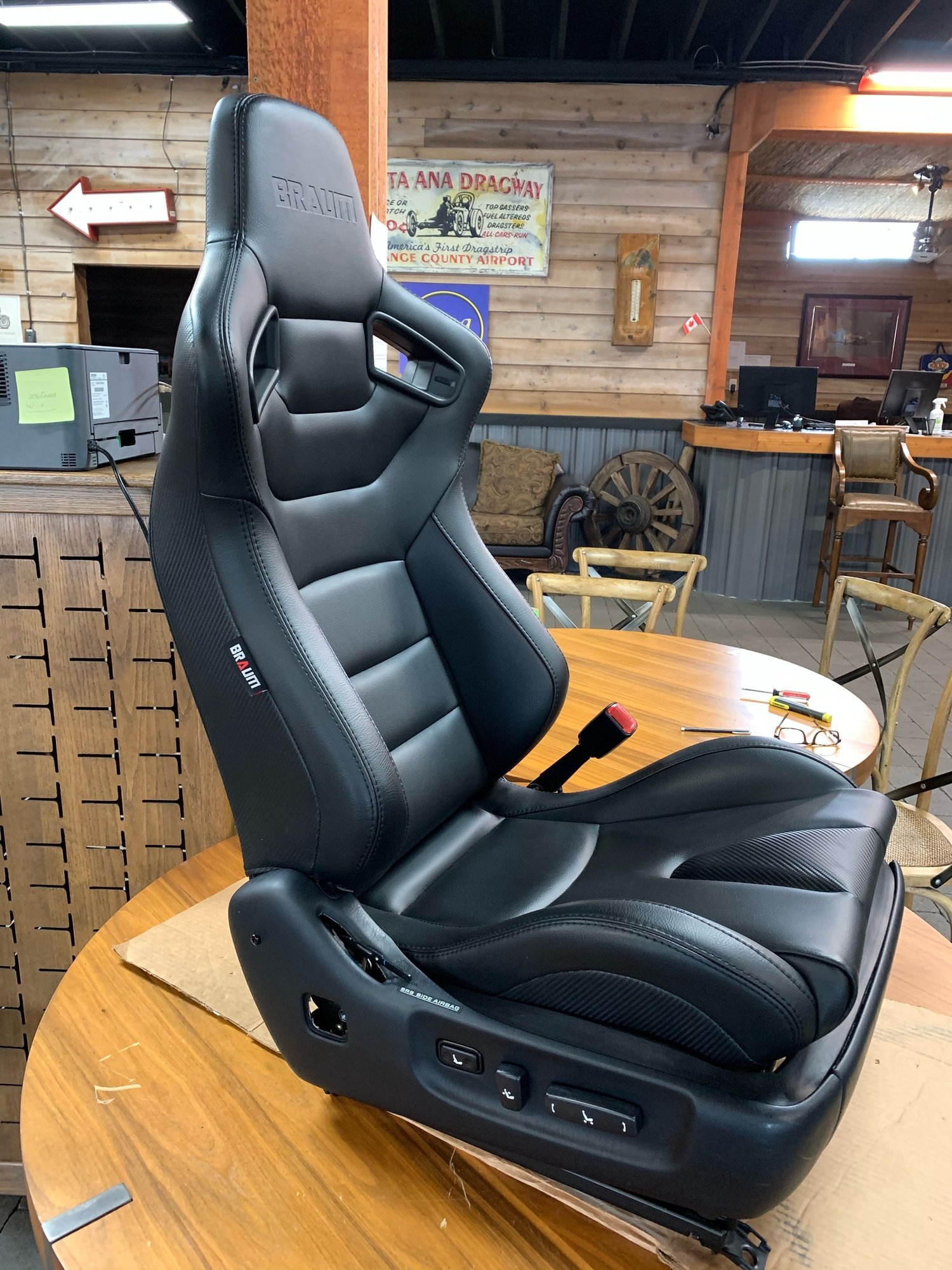

I always wanted to have seats with better support than the stock seats in my 2003 Aristo. I like the power seat functions and the comfort of the stock seats but for cornering they leave a lot to be desired.
I have been upgrading the Aristo to make it more current performance wise. Seats are part of the upgrade. I decided to purchase a set of Braum Seats and make a custom mount to keep the stock power functions. The design of the horizontal pleats is similar the stock seats and they look like they belong there... a goal I was going for. Let me know what you think.

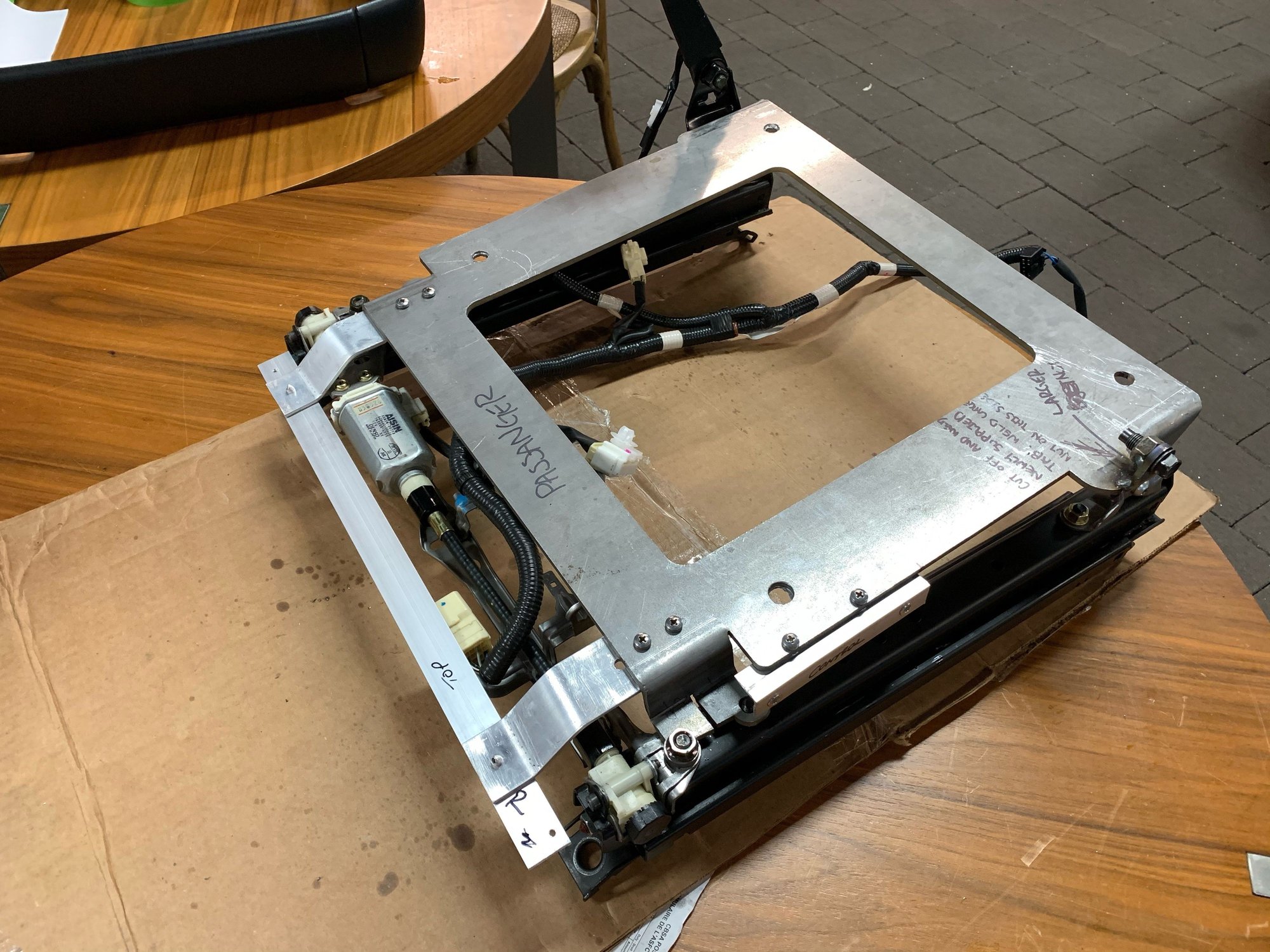

Thank you. After removing the seats and disassembling them, I designed and made mounting plates out of 3/16" steel on a waterjet.
I wanted to incorporate the stock plastic trim panels and seat belt locations. I also was able to gain 3" inches of leg room and an extra inch of head room. Next I designed aluminum brackets to mount the seat controls and
the lower front of the panels.
The power seats have forward, back, up and down power controls. Having the power recline function would have required some major seat reconstruction so I opted to have the manual seat recline instead. I have the lever
for the recline come out ot the stock steet belt location. There is a 1.5" gap around the panel and the seat because the Braum seats are not as wide. I used rubber door seal as a panel filler. It is secure and matches the black color nicely but is not perfect. I may design a PCV Filler Panel in the future.
Over all I am pleased with the results. They fit and feel fantastic. Solid mount, no squeaks and work (except for the recline) like the stock seats.

I do have more photos that I'll send you. The seat belts are mounted in the stock locations on the seat. I simply made a mount on my bracket for the seat belt.
