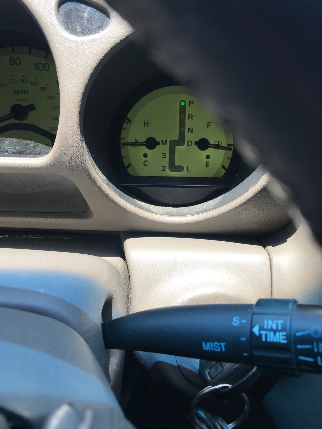

Hi I just purchased a 1999 GS400 and noticed the cars temp gauge sits slightly above the middle line when fully warmed up.
Is this the normal operating temp?
Also when it’s cold out the gauge stays between the middle line and the second line when fully warmed up.
I plan on bleeding the cooling system and replacing the thermostat later but I am just making sure.
Thanks

That’s where the gauge stays at

That is a dummy temperature gauge Lexus puts in.
I use a UltraGauge that displays live engine temperatures, and from 140* up to 214* ( the highest I've ever had it go) the needle sits at that exact spot doesn't move.
And if it ever does move up it will go up fast in the red and be too late.
Our cars run a 180* thermostat.

Originally Posted by mattscar
That is the middle. The temp range is divided into fifths by the black hash marks so you aren't going to have one that's dead center of the range.
