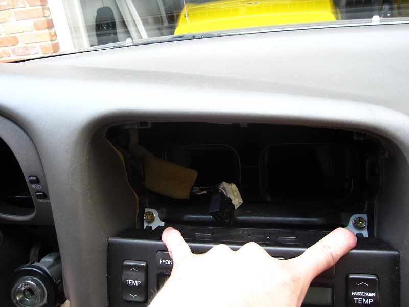

You need to start by taking out your dash obviously. I started by taking off the armrest, centerconsole, kickboards in driver and passenger side floorboard, glove box, amp, cd changer, pieces around the steering wheel containing the hood release/gas release, ignition switch housing, gauge cluster, dropping steering wheel, removing radio/ac gauges, ac vents in center, pulling dash, dash mounting support, blower fan, heater core, evaporator box. Here is how to do all of that. I didnt do it in order because I didnt have the directions, so I will do it as best as I can to put it in the best order

** Tip** when removing the trim, place car in neutral. If you are still having issues, you can pull the ashtray away from the trim.
