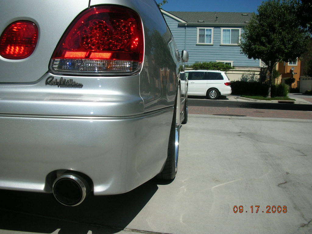

Originally Posted by SHiZNiLTi
After you guys get your fenders shaved to run a flush wheel like shown above, what do you do to seal the (2) pcs of fender together. Is repainting of the entire qtr panel needed after this done?
Also on average what did you guys pay?
This was a DIY for me so labor was free.
You will see the seam where the two pieces meet. I just primered and painted over them and masked off the paint right up to the edge. I then followed up by blending the OEM silver followed by a clear coat. If you mask carefully you will not touch the paint on the outside at all. 4+ years and no separation.
The clearance shown on the photo is achieved without any modding done to the outside body. That tire size is a 295, so it's not stretched and still no rubbing. If you ran a smaller tire size and stretched it you could get even more agressive with the offset and still clear.
