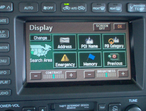

As promised, I just wanted to give a little write up and show some pictures of my conversion from a 98-00 oem hdd navi to the 01-05 oem dvd navi. The main reason I wanted to upgrade the navi was because I wanted to add the vaistech ipod module since there wasn’t any ipod solutions for the 98-00 GS. I also wanted to have the newer map data (this was before Lexus announced the 2005 hard drive update)
Since I already had a navi system the original goal was to make the entire conversion plug and play, but due to connector availability from Toyota I was only able to complete half of this goal. The install of the Navigation ECU (Computer) is completely plug and play with an adapter harness but I had to splice some of the connections for display install because some connectors were not available to make it completely plug and play. Everything works as it should except for the tip info screen #1 which calculates the cruising range, distance after refueling, and average speed. I think this is a wiring problem but I need to look into this more.
When I did my install I added the vaistech ipod module, upgraded the Navigation ECU (Computer) to the Gen 4 version 86841-50090 (Superceded by Part Number 868410E010), added the coastaletech Navigation Enhancement Kit to auto press the “I agree” screen and auto enter code to allow entering of destinations while moving. The coastaletech only works with the Gen 4 computer.
I hooked up the optional microphone to the gen4 system but the voice recognition was so bad that I decided not to install it and I sold the mic.
I found a complete system on ebay for $1200 and got the wiring diagrams from the Toyota Technical Information System website. After I sold my old system for $1200 my total cost was about $500 doing the install myself.

Yes everything works as it should except for the info screen #1 which calculates the cruising range, distance after refueling, and average speed. I think this is a wiring problem. When I say display unit I mean the entire display unit (display, radio, a/c computer)

Yes it can be done on a non navigation system but I think it is a little harder with nak system because the wiring is slightly different.
