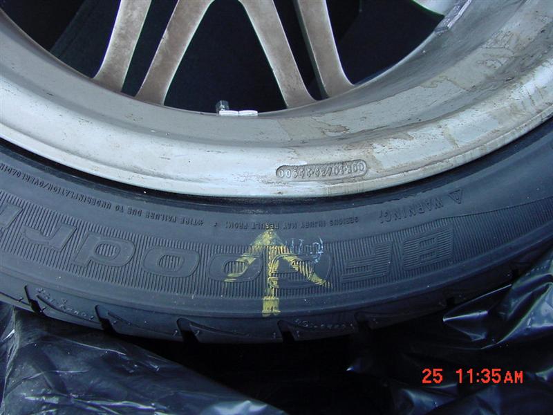

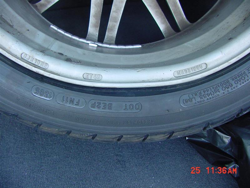

Here are the pictures of the damage... not too bad so hopefully fixing will be easy.
Look at all the weights they used on one of the wheels to try and get it balanced...

One of my stock GS rims has the same size bend, and although it looks minimal the sensitive GS will give you a shake at 60-70mph. My tire shop also stuck on a lot of those balancing weights opposite of the bend to counterbalance the imperfection, but I still feel it on highway speed. They will definetely be able to straighten that out. Let us know if it smooth as glass.

john that will not be a prob fixing that wheel so dont worry

Yes, hopefully they will fix it back to perfect.
I figured since they will be doing the balance there as soon as they think the bend is out they will be able to determine if it needs more work or not.

Dropped off the wheels at Transwheel. They assured me that as long as nothing goes wrong getting out the bends they will get the wheel truer than factory specs. They work the wheel to a better tolerence than factory...
Lets hope this is true... the downside is it is running me close to $200.00 with tax.
