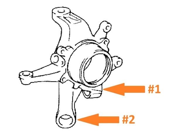

Are we talking about bushings #1 and #2 in the rear axle carrier?

Yes, both rear lower spindle/knuckle bushing!

According to Lexus/Toyota specifications, they are not replaceable. If they are worn out, you will need to replace the rear carrier sub-assy.
Left part number: 42305-30070
Right part number: 42304-30070

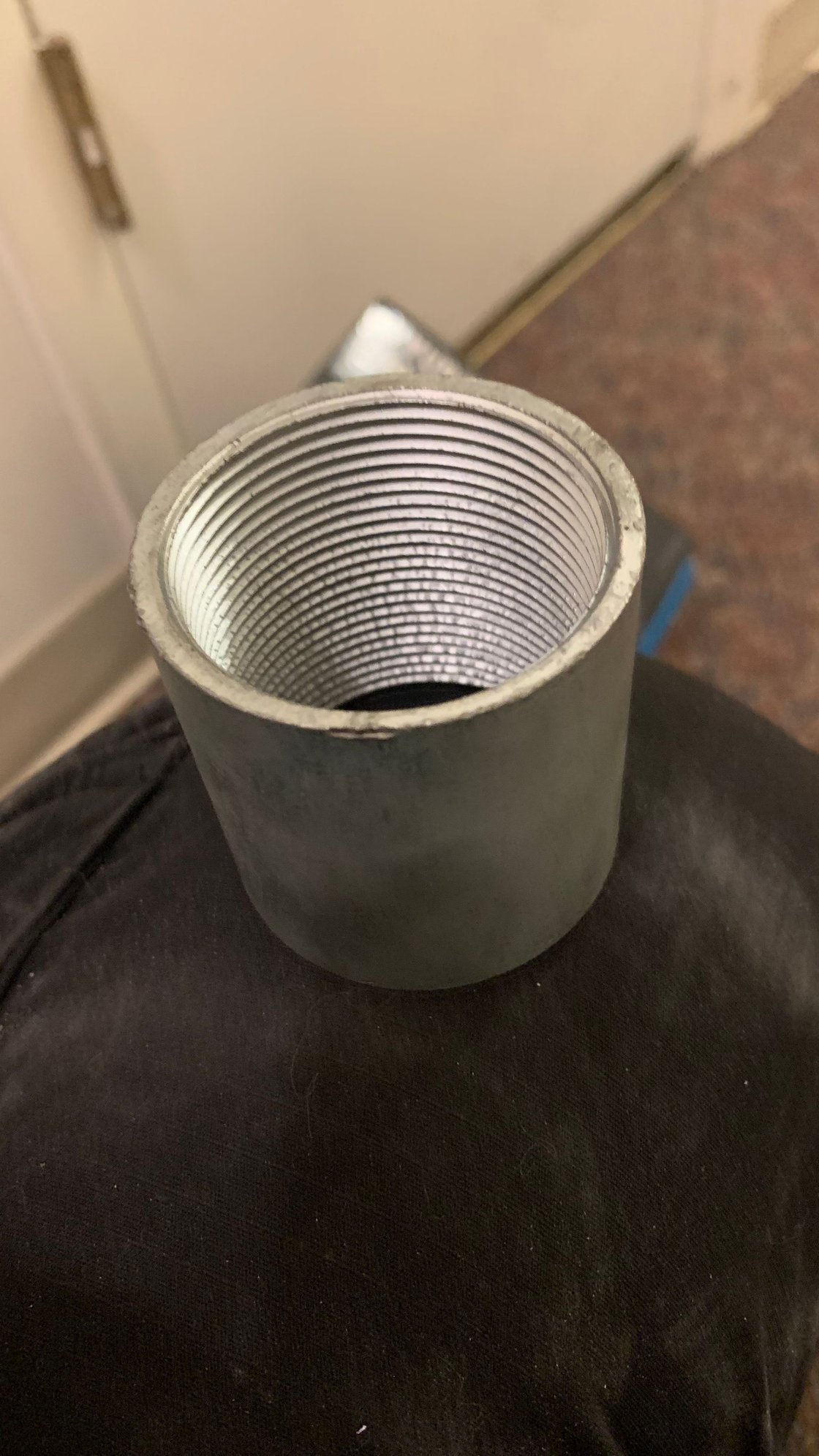

When doing mine I had the same issue, I took my new knuckles over to Home Depot. I found some plumbing fittings that were a perfect match with the new knuckles and they only cost about a dollar each.

I can probably find what I bought and post a photo of it, it might make your search a little easier. I think i bought a coupling for gas pipe. Check back for the pics in a few minutes

It says it’s a “1-1/2 fitting, and I am pretty sure it’s for natural gas pipe. If you already have a jack screw or ball joint press, it will be pretty easy to pull them out and install the new ones, just make sure your going the right direction

Nice thank you! Yeah, I already have a ball joint press, just didn't have the right cups to fit the bushing to put them in straight. Thank you a lot man! This helps immensely!
