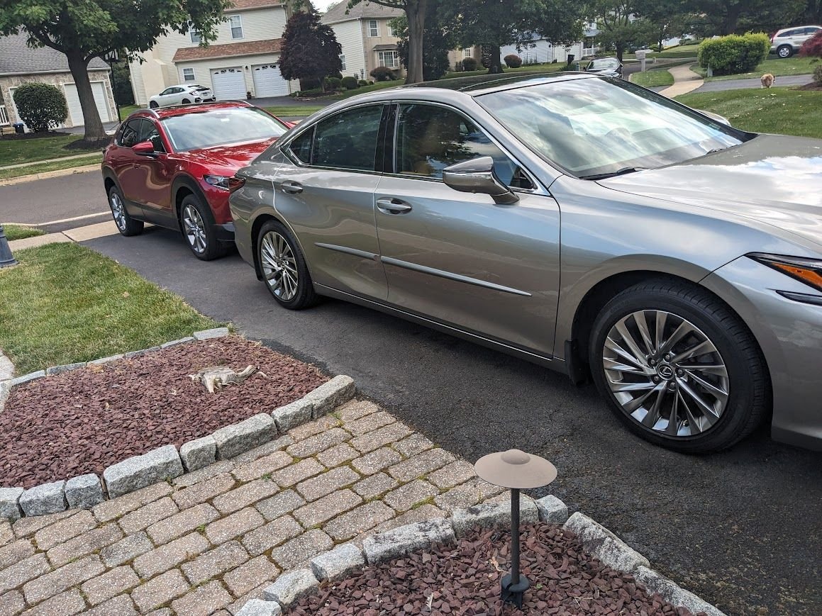

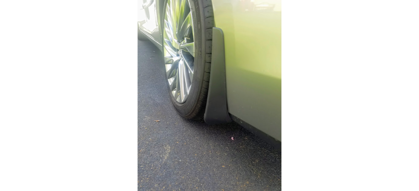

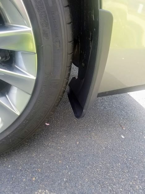

There are numerous threads regarding the purchase and installation of mud guards on your Lexus. I put them on mine back in 2019 shortly after purchase. Most have mounting holes that match up with the existing holes in the fenders. If you do a search for the threads there's loads of information on where to buy and how to DIY. Takes about an hour for all 4 wheels. FYI - the rear fenders are plastic - not steel. No rust issues if drilling required. Must use stainless screws though.

I bought a 90 degree power screwdriver - not expensive - and used that to remove and reinstall the screws. Just enough room to get in there. GOOD LUCK!

I highly doubt that you will get a reply from China with instructions for the guards. The installation is straightforward. Just screw them on... Same for 2019 up to 2025 for the 350...

No holes were required on my ES300h. The mud flaps were designed to use all the factory holes.
