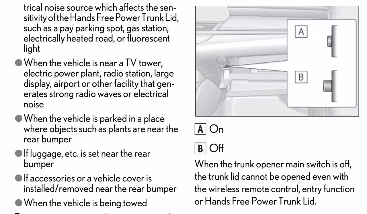

Check this:

Ok...I was under the impression that he still had a dead battery and the battery was in the trunk. I did ask him if it was a hybrid and said no and further looking the ES350 battery is under the hood which has nothing to do with the trunk. Guess I misunderstood the post and the rest of you didn't and correct in saying the trunk opener main switch is off.
