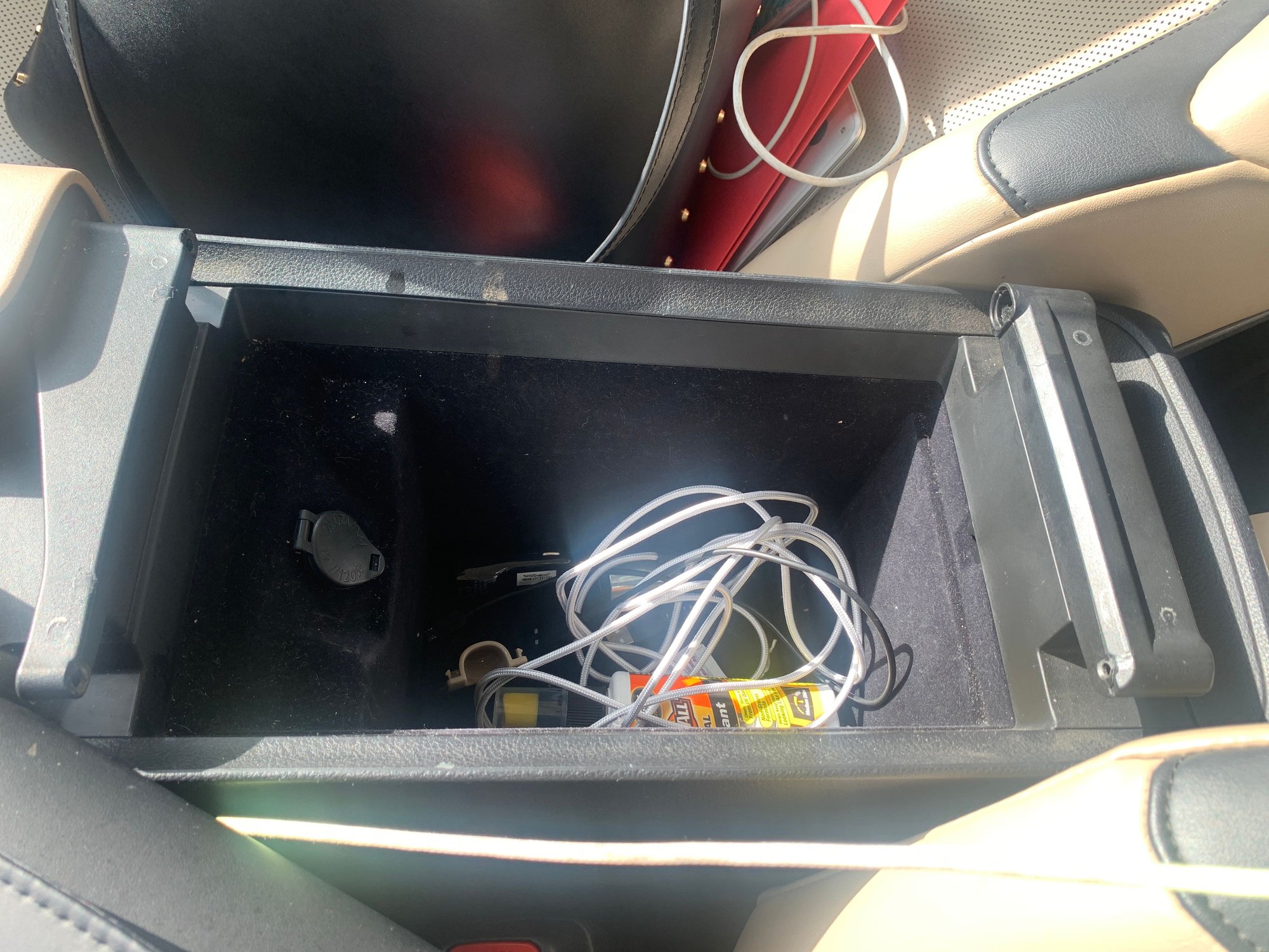

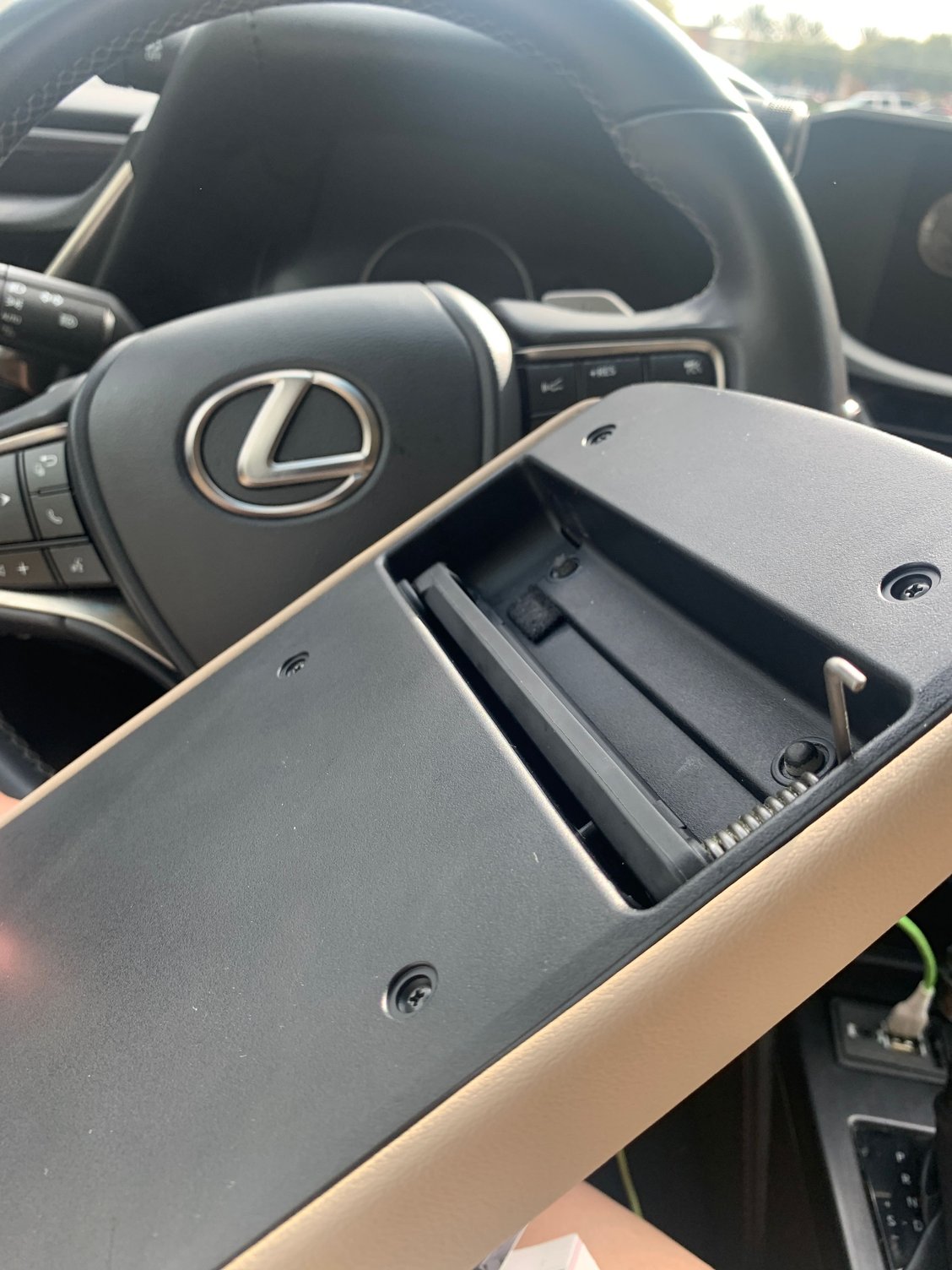

I was driving my mother-in-law’s 2019 Lexus ES 350 and went to open the armrest. I didn’t realize that it opens both from the passenger side and the driver side. Well, it was not fully latched on the passenger side and I went to open it from the driver side. This caused the lid to unhinge. I’ve been at it for hours trying to re-insert the lid. Anyone have any idea on how to do this. Any help that can save me a trip to the dealership would be greatly appreciated.
There is a spring on the lid that I have no idea where to insert.

The spring goes here:
You need to remove the cover from the lower base, just pull it up.
Check my pics from the link.
