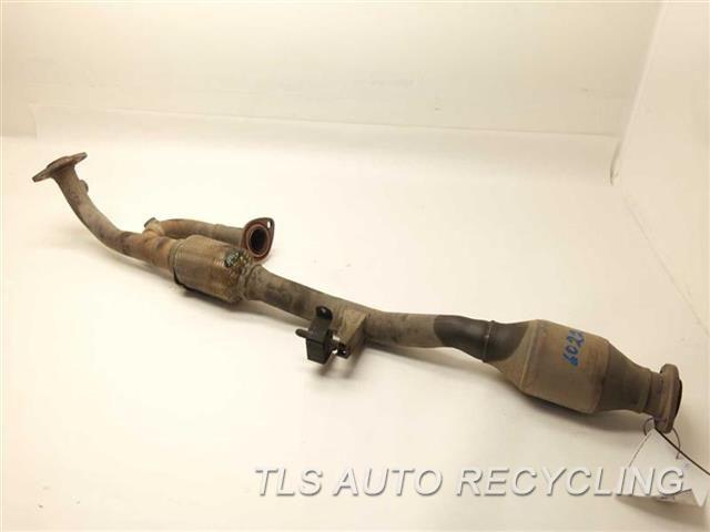

There is two main catalytic converters, one for each exhaust manifold right after the Upstream Air/Fuel sensor. Then there is a 3rd clean up cat after the flex pipe (see above), but before the downstream O2 sensor. If there is an issue with the efficiency of the catalytic converters, it will be detected downstream by the rear O2 sensor.
