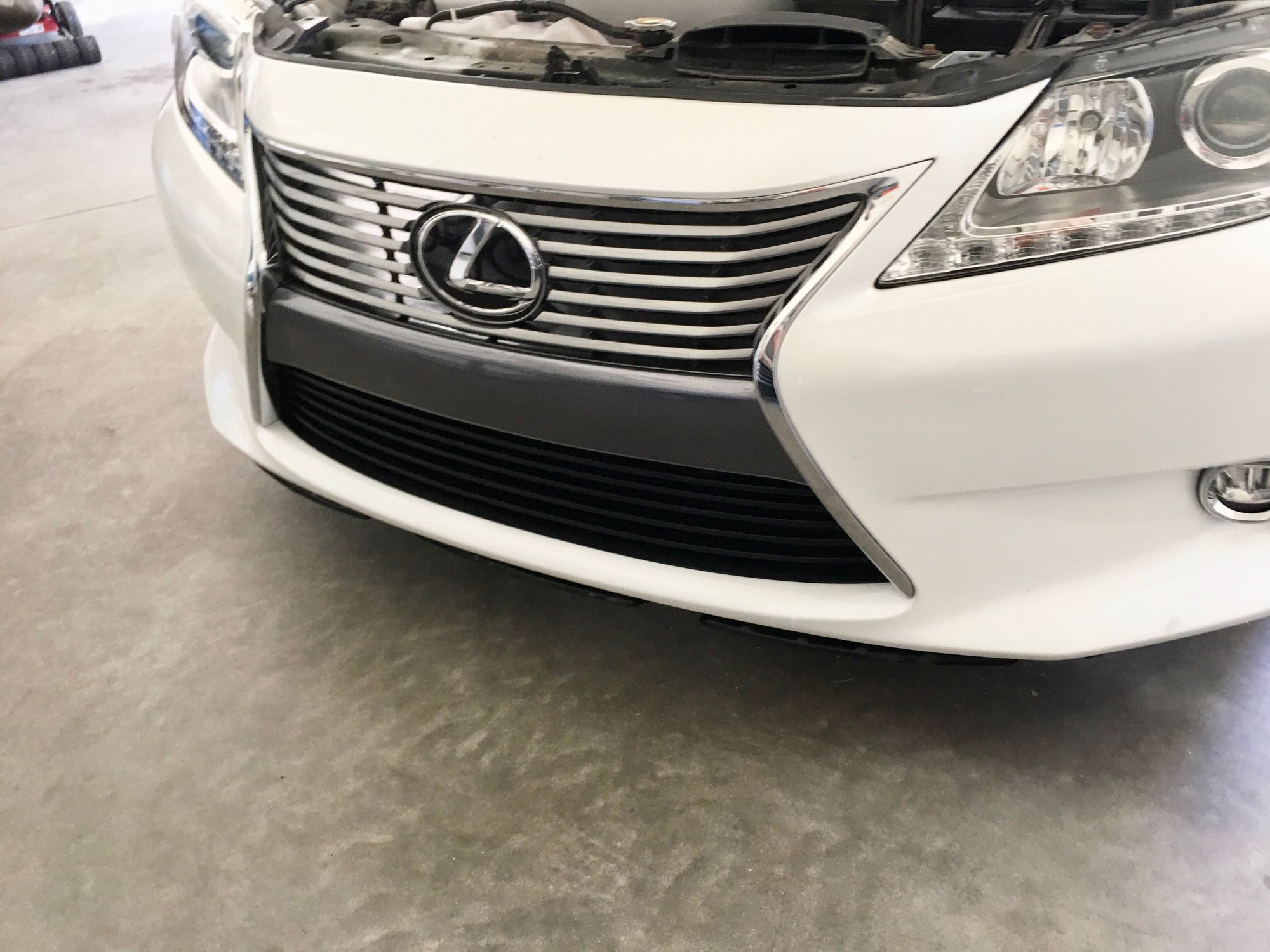

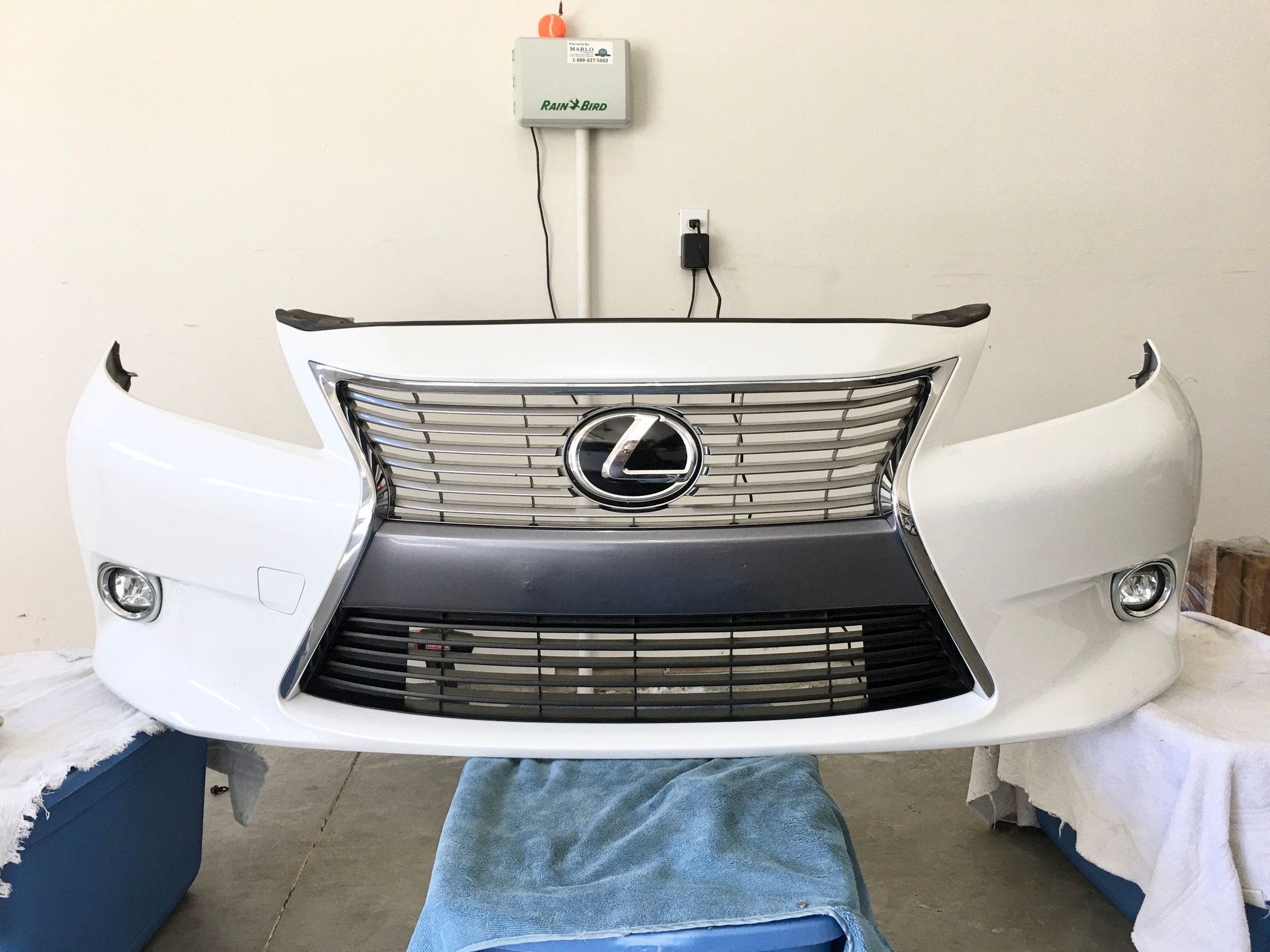

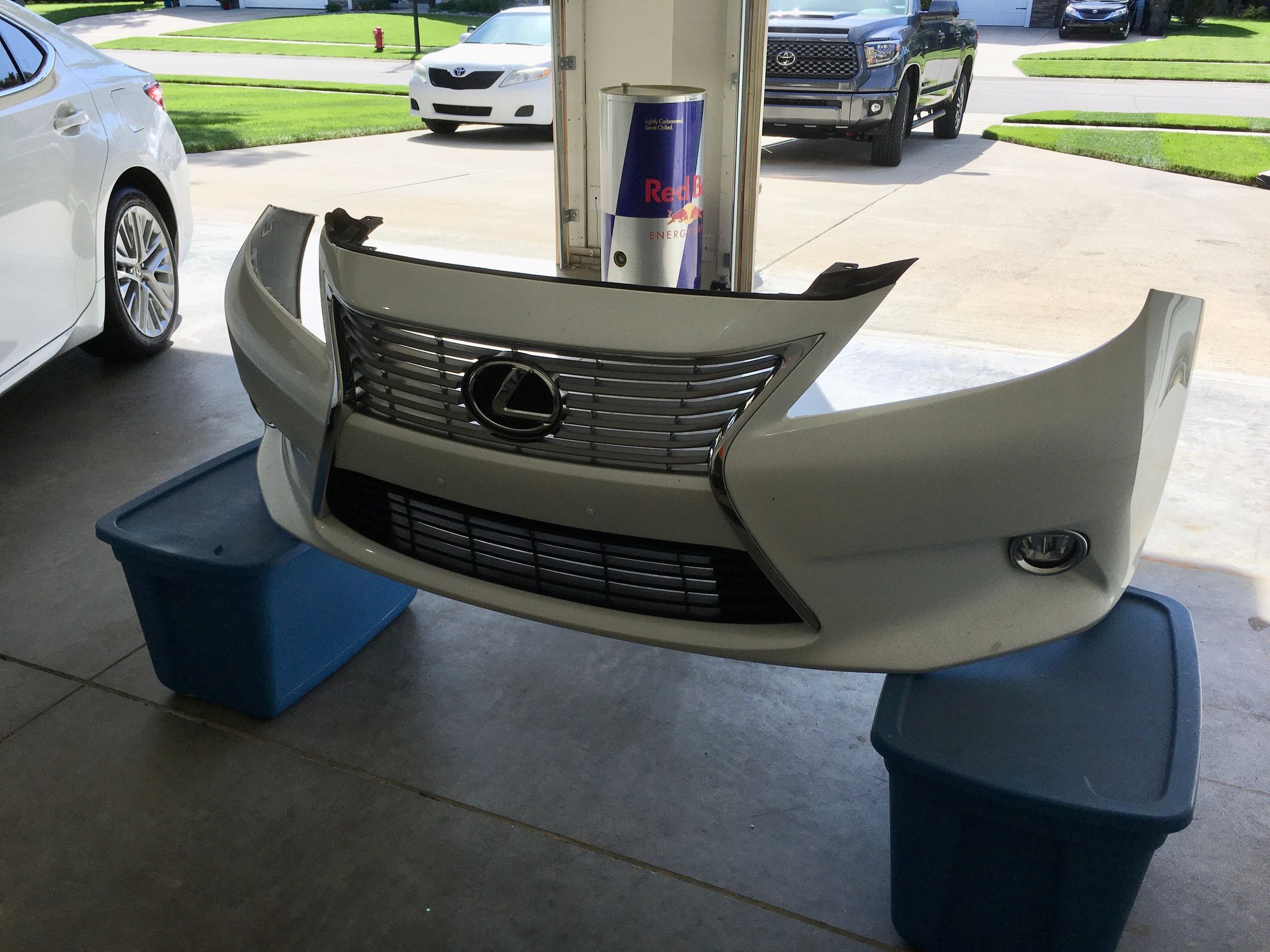

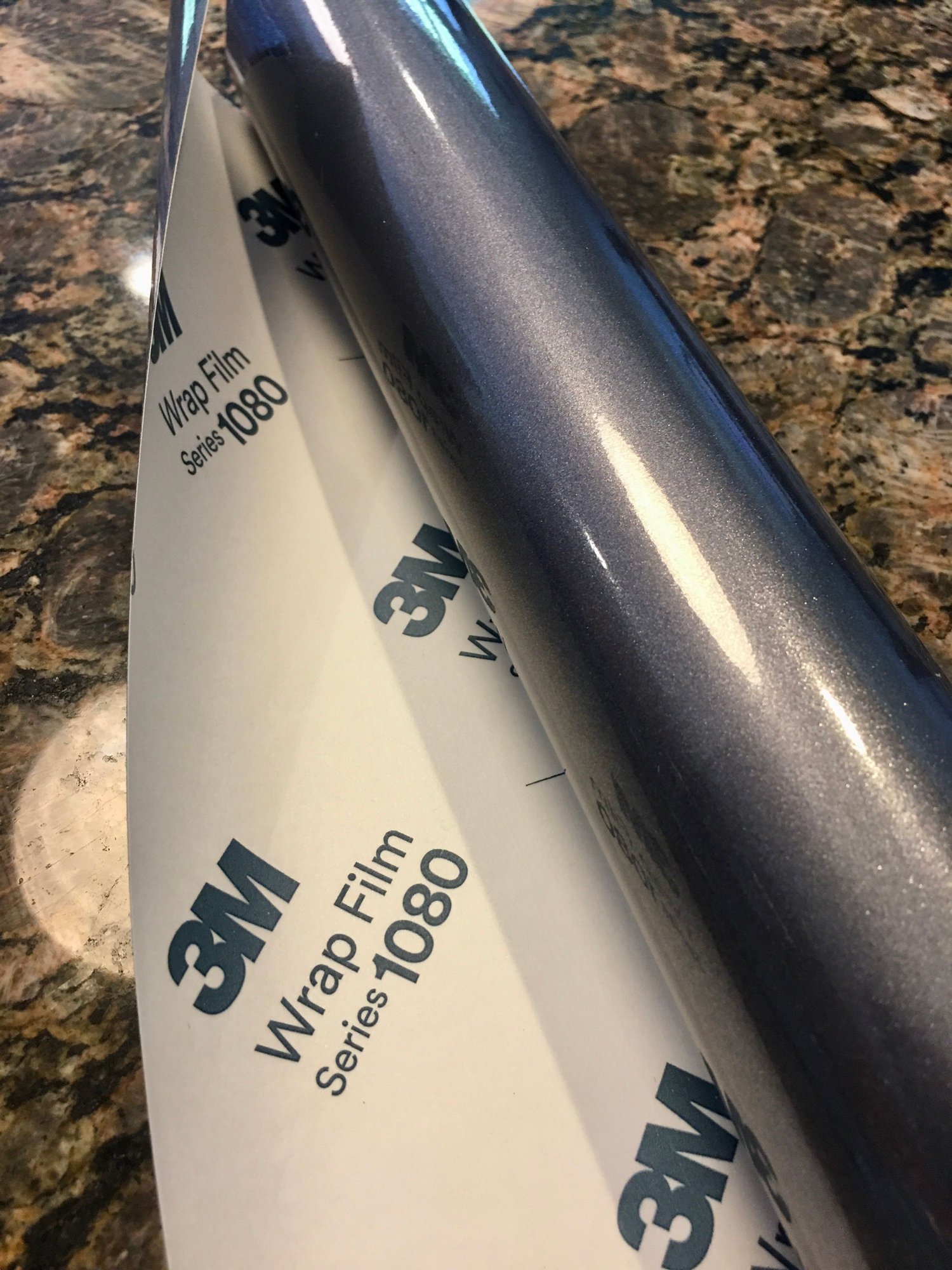

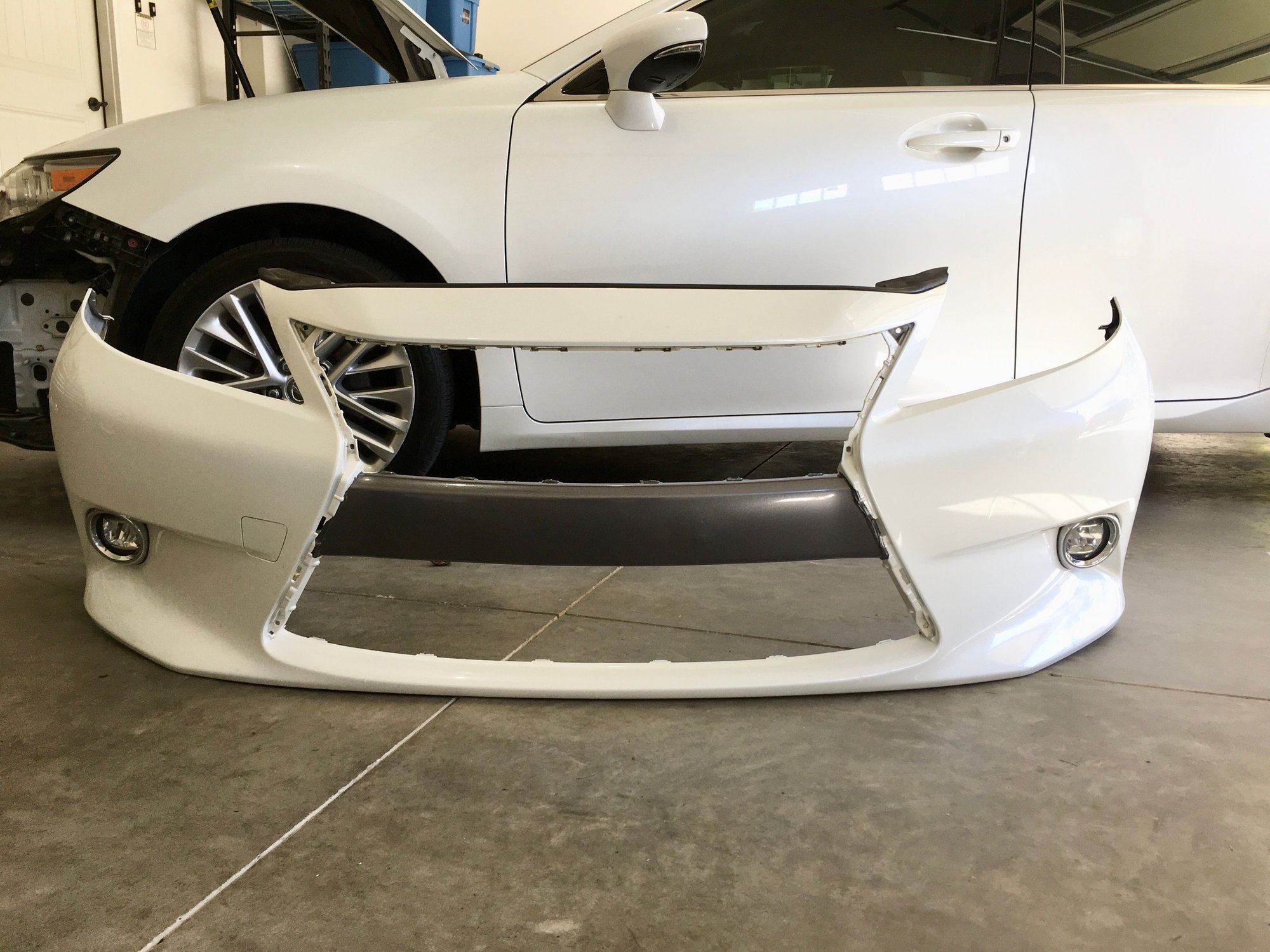

Hello all...just sharing pics of my diy project. I decided to wrap my front bumper middle bar similar to an LS460 in 3m anthracite. I never wrapped anything before so I was a little hesitant. Did it the right way and removed the bumper and all trim this way there are no gaps and I didnt have to cut the film on my paint. Once reassembled, the vinyl is tucked underneath the grills and chrome and has no chance of lifting or failing. Im happy with how it came out, covered my plate screw holes, not perfect but came out really good for my first time wrapping. 3m is nice and thick so it will withstand rock chips. Enjoy the pics.
10 bucks for the vinyl and 10 bucks for vinyl install kit👍🏼👍🏼👍🏼👍🏼
3m Vinyl arrived...

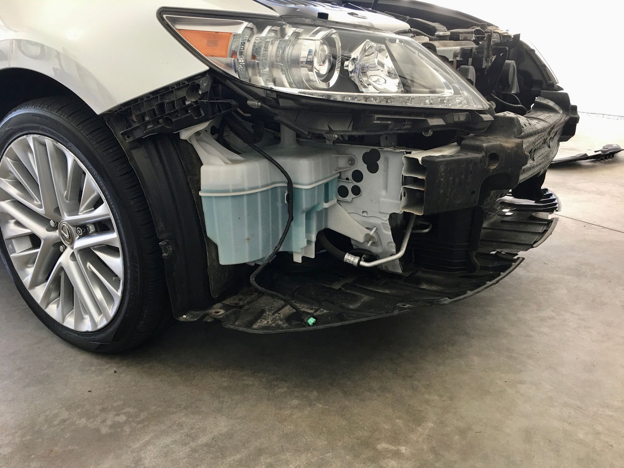

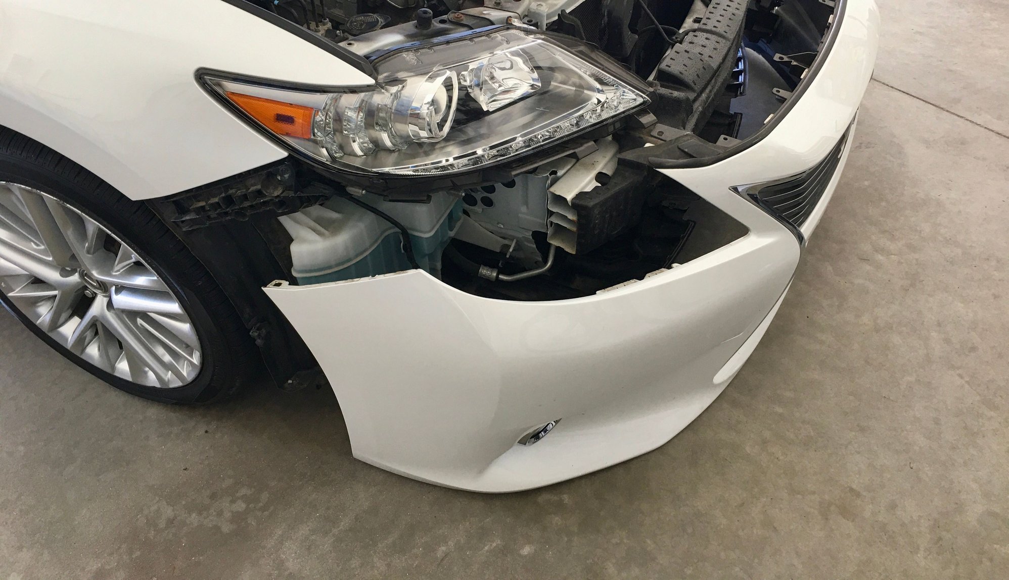

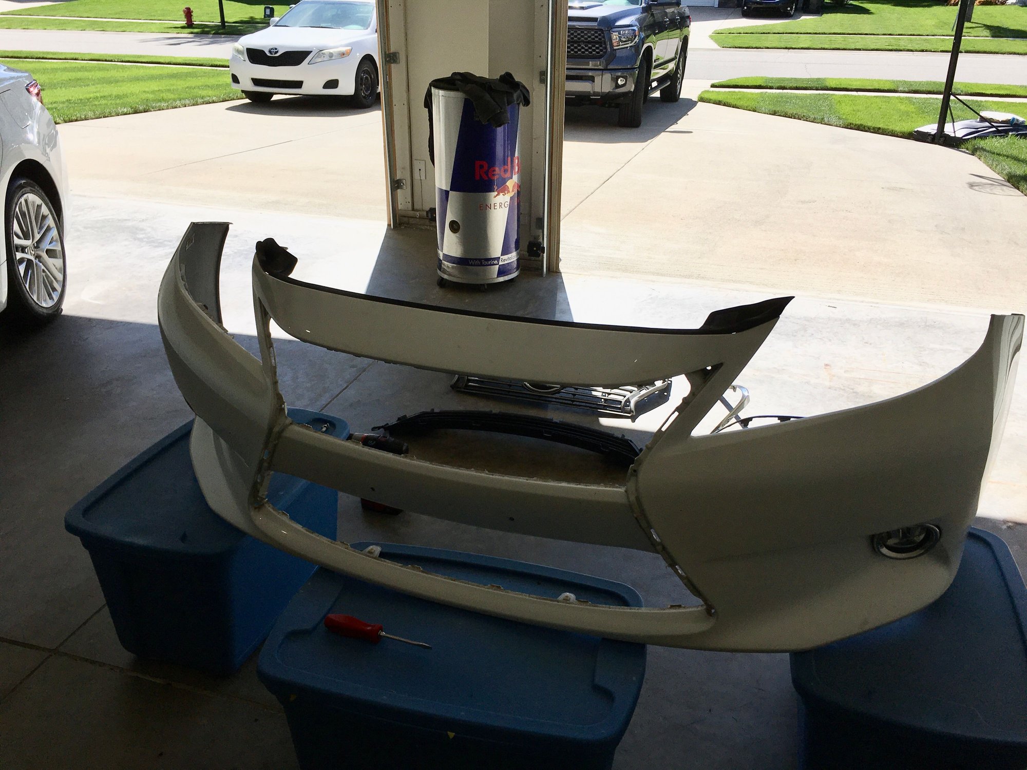

Bumper off, tons of rivets, clips and screws but easy work.
Looks like a new avalon in this pic with a huge gaping hole

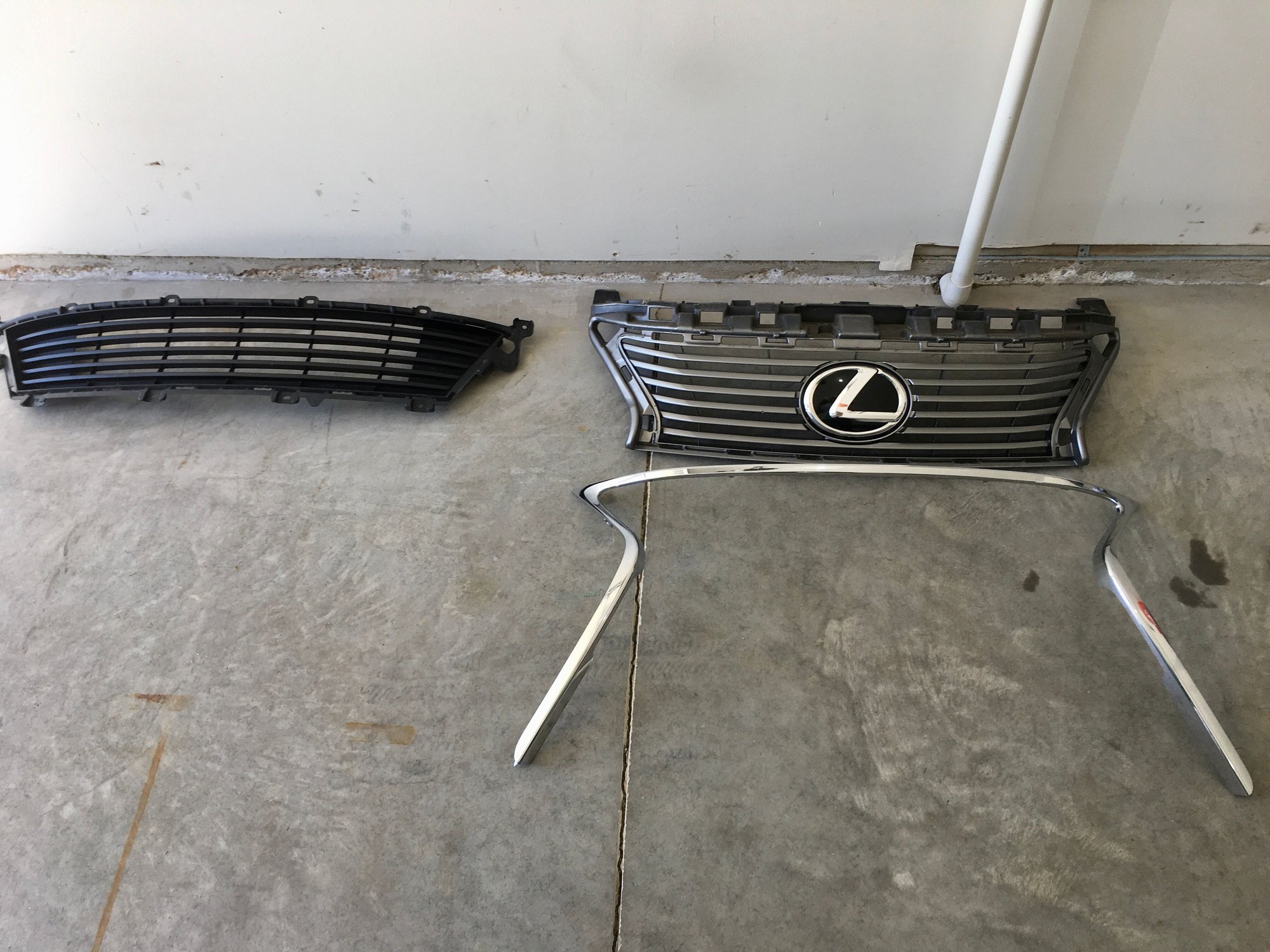

Ready to disassemble

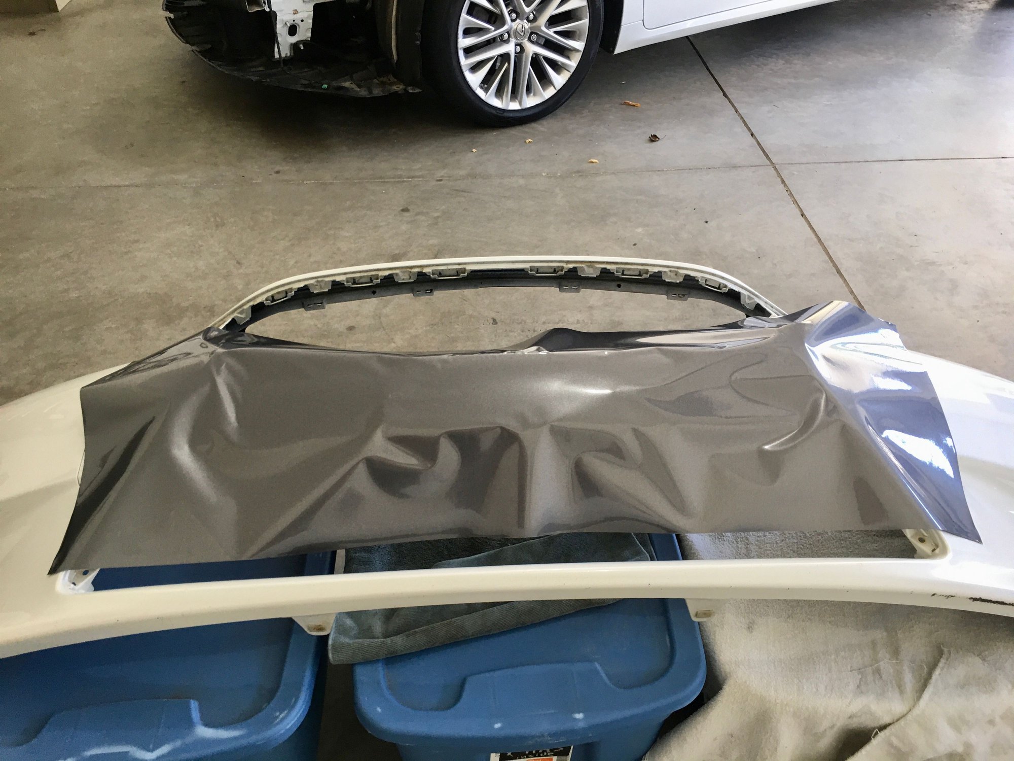

More....
Omg, look at all them wrinkles

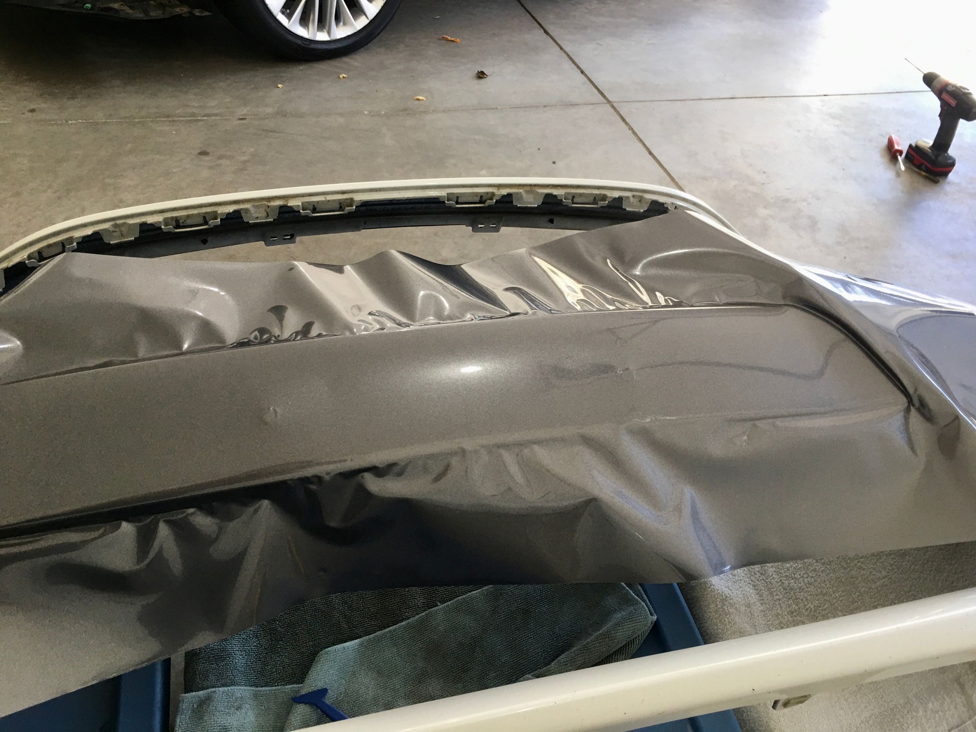

Getting better

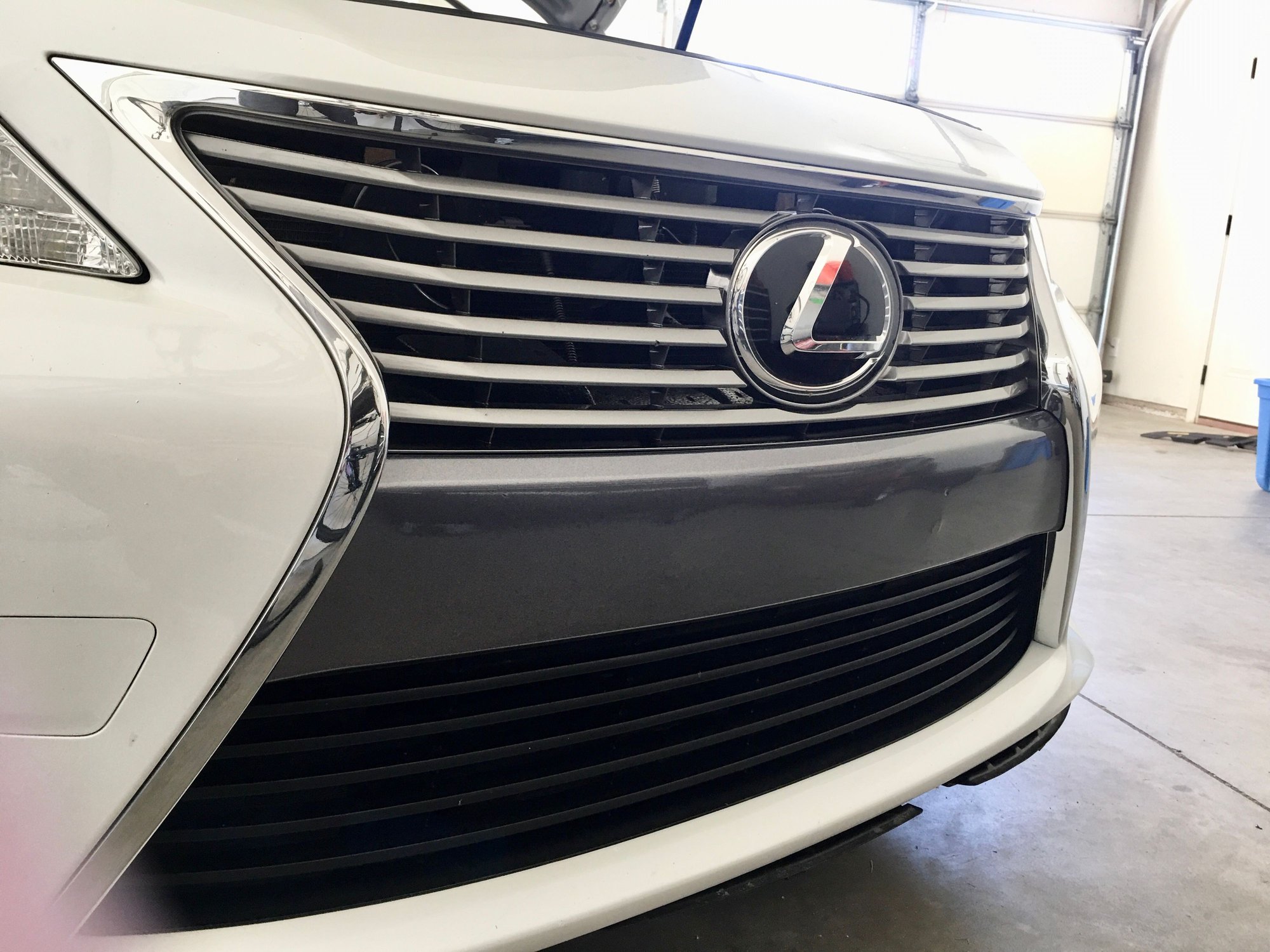

Almost there
Boom
Ahhh much better
Not bad for first time wrapper
Love it

Id say it took me a couple hours with a snack break? Most time consuming part was removing the chrome surround and upper grill, those things were in there good. I took my time too because I only bought enough vinyl for one shot at it.

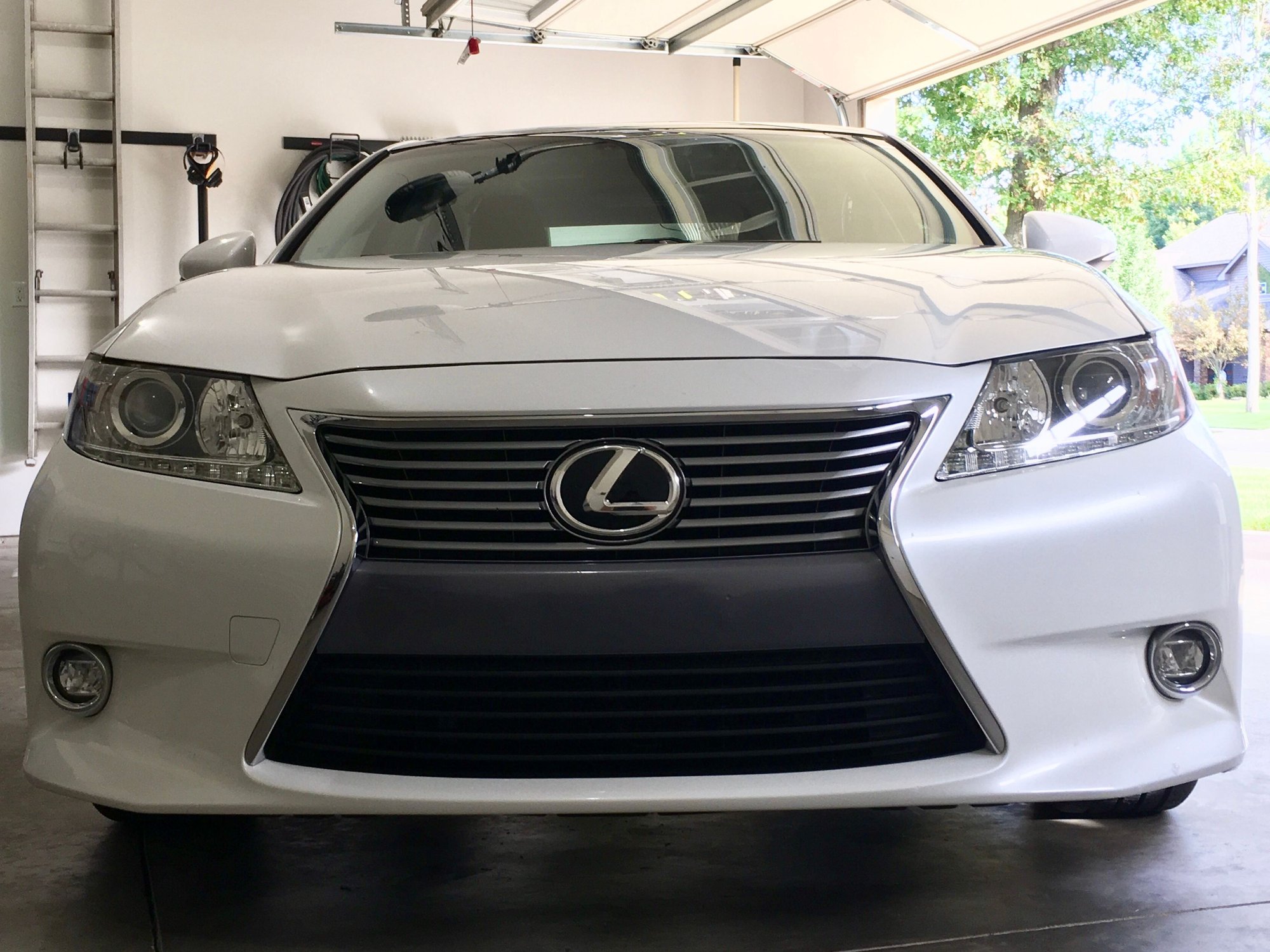

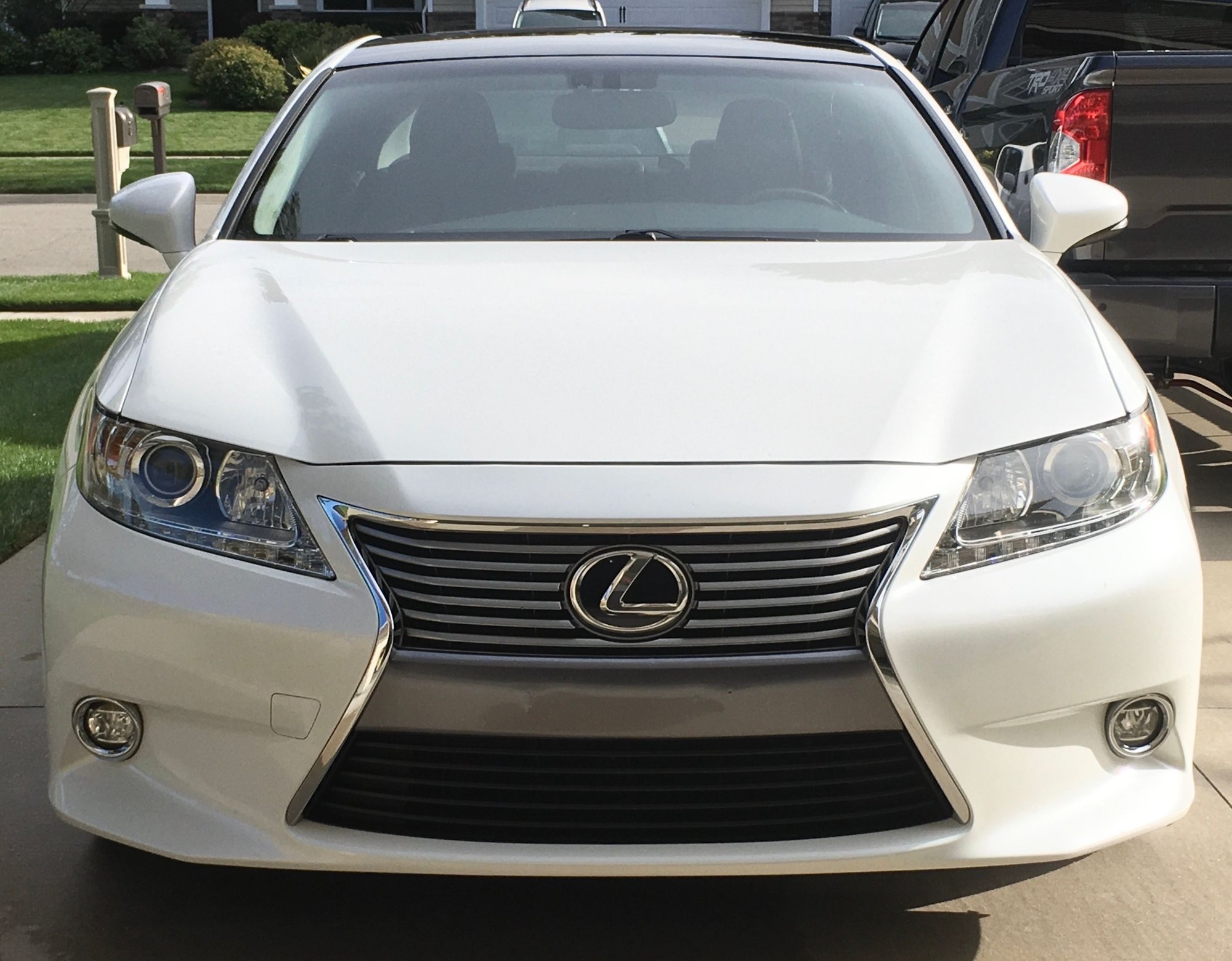

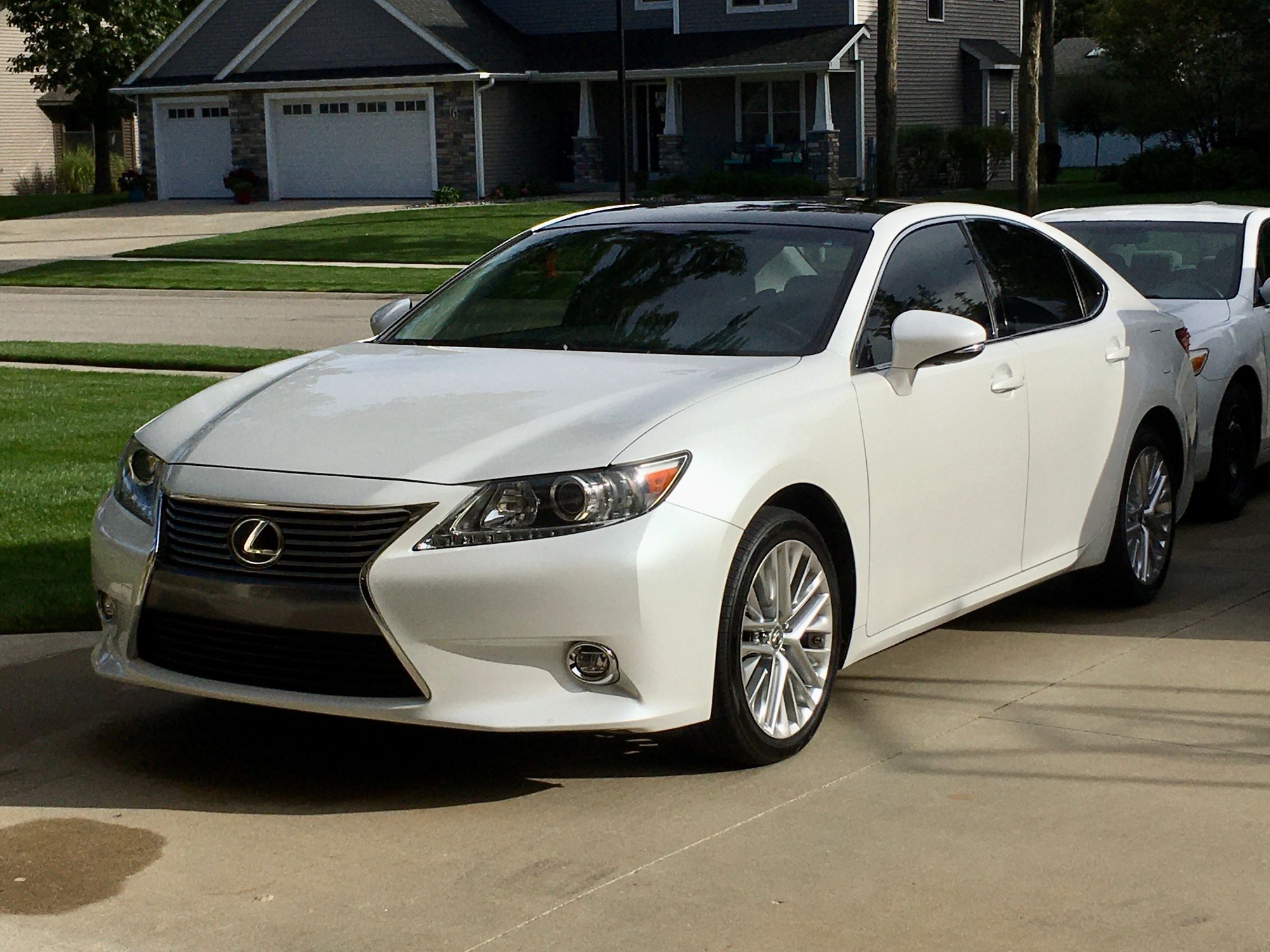

Pic outside, the 3m anthracite looks different depending on lighting.

Like this? Crafted line black grill and middle bar with black mirrors.
