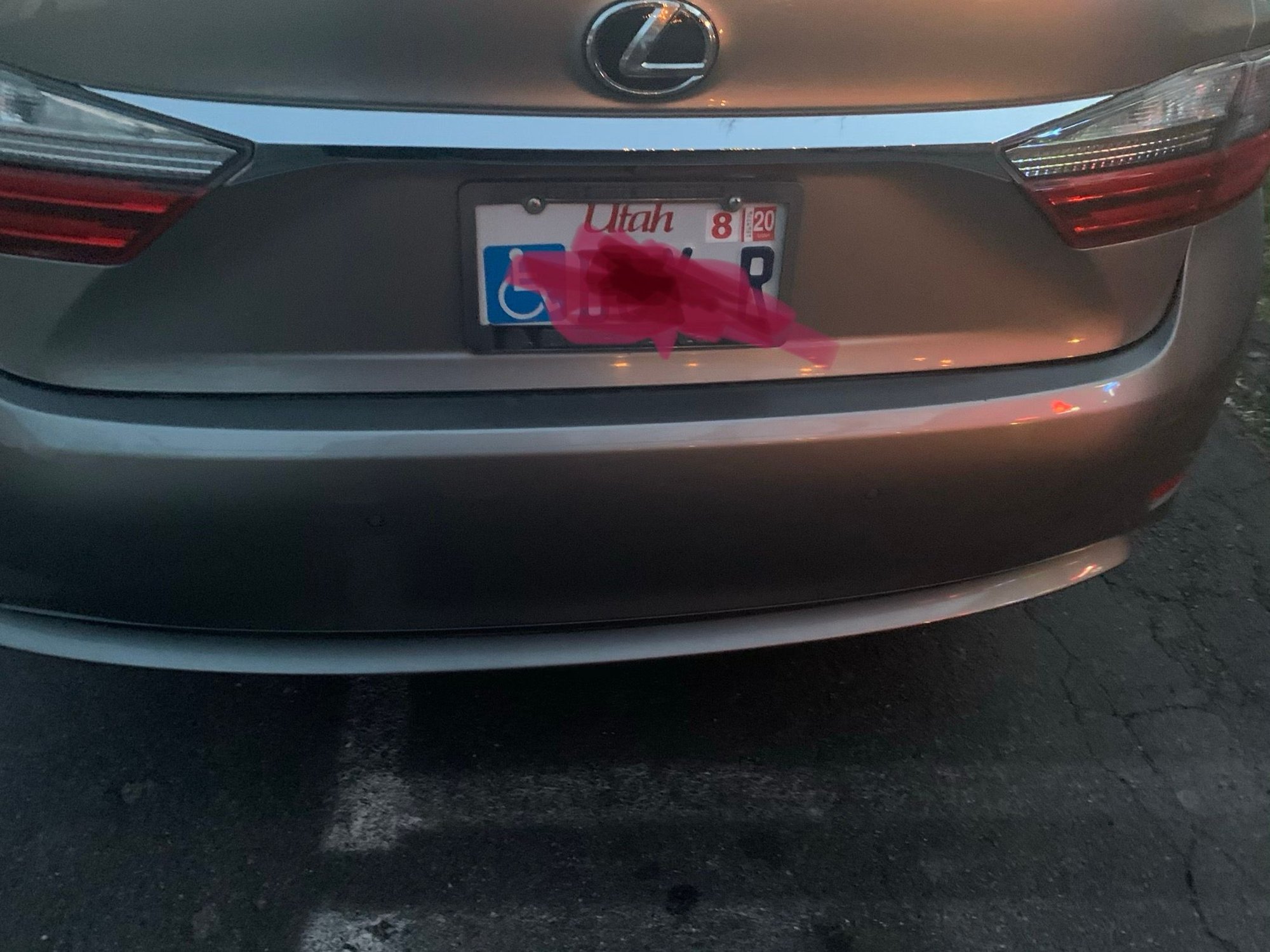

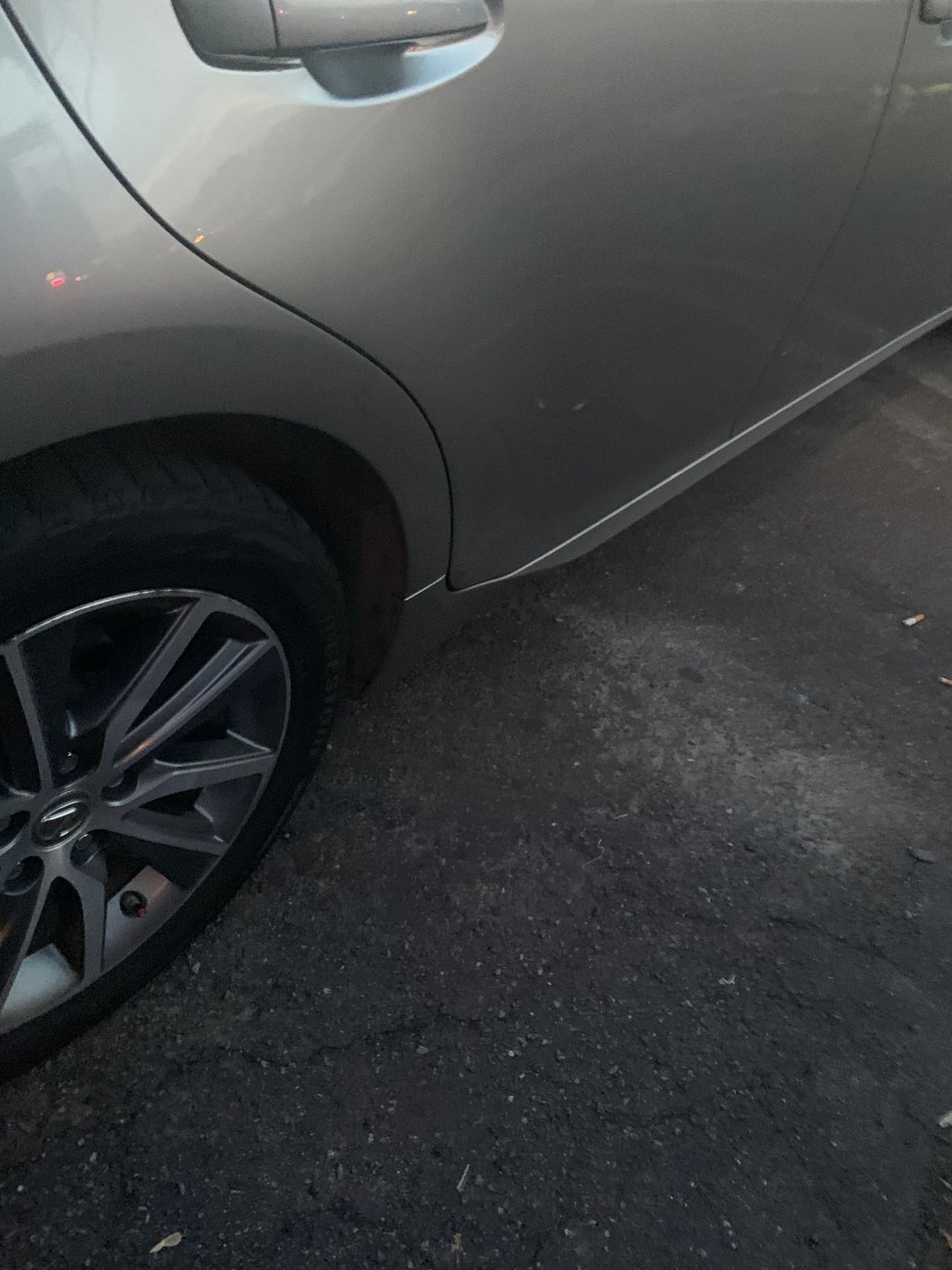

So yesterday I had some free time I never like the look of the car with the badging on it like the ES 300 H or the hybrid letters underneath the bottom of the back doors so I took some time and remove them looks much cleaner without them came off easy without a hitch

Are the badges/letters just stick ons? How did you remove them?

Use a hair dryer to warm the badge up then use fishing line behind the badge and work it across the back until it releases...
yup worked like a charm
