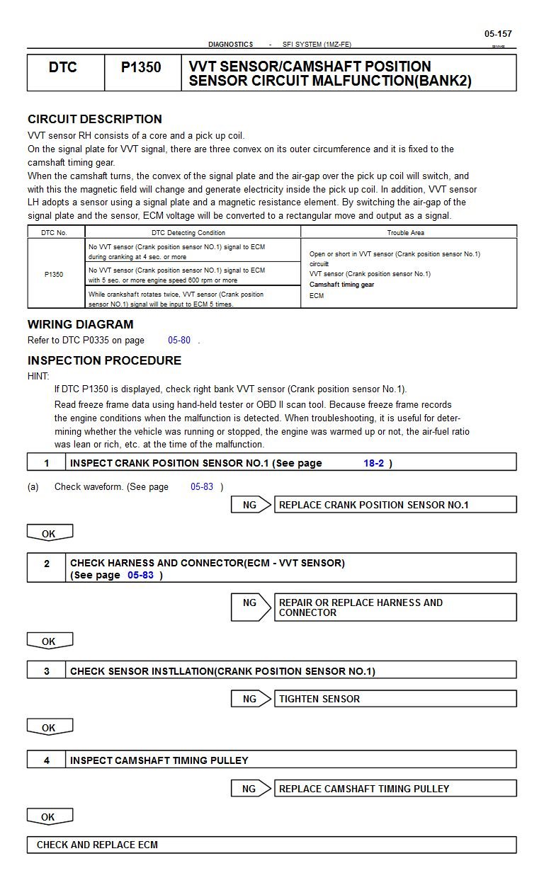

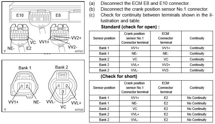

I decided to to do a bit of a research on this topic and was able to find quite a lot of information about those sensors. First of all, it turned out that those two sensors are called VVT sensors, since they detect the position of the shaft, but not the pulley, and as I understood, they differ from each other - Bank 1 sensor has 3 contacts instead of 2 on the Bank 2.
Basically that is what held me for so long, it's all is really misleading. But thankfully I was able to find a Service Manual for your car, which has all the procedures to diagnose your issue (look for page 05-157).
Also, it would actually be easier to check the resistance of the sensors instead of voltage - there should be 835-1400 Ohms when the engine is cold, and 1060-1645 Ohms when the engine is hot..
Diagnosing Steps
Wiring Diagram for ECU and Connectors
Crank Sensor WD
Hope this helps and best of luck!

Thanks a ton! This is fantastic. I will print this out and get to work on it as soon as I can.
So it looks like I should determine left/right ~ front/back ~ bank 1/bank 2 by counting the sensor contacts, just to be sure.
Again, thank you for the documents and all the effort. I greatly appreciate it.
